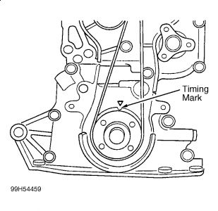

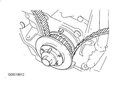

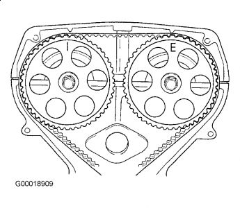

2001 Kia Rio timing mark placement Cam and crank
2001 KIA RIO
89,000 MILES • 4 CYL • FWD • AUTOMATIC
ORTIZHARRY
were are the markings and position of the cam and crank
Aug 29, 2009 at 11:01 PM
MHPAUTOS
  • 31,937 POSTS
Hi there, See pics for timing mark alignment points. mark (mhpautos)
