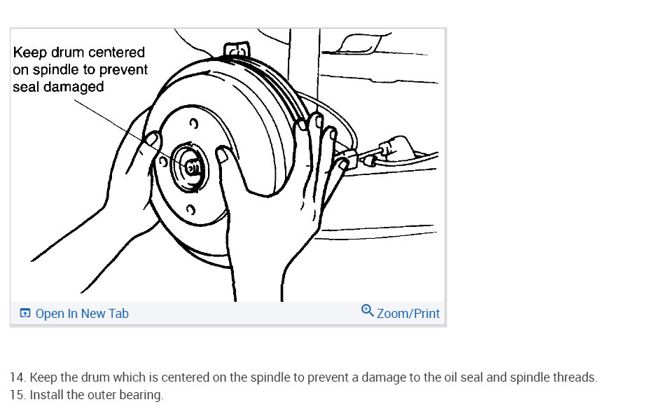

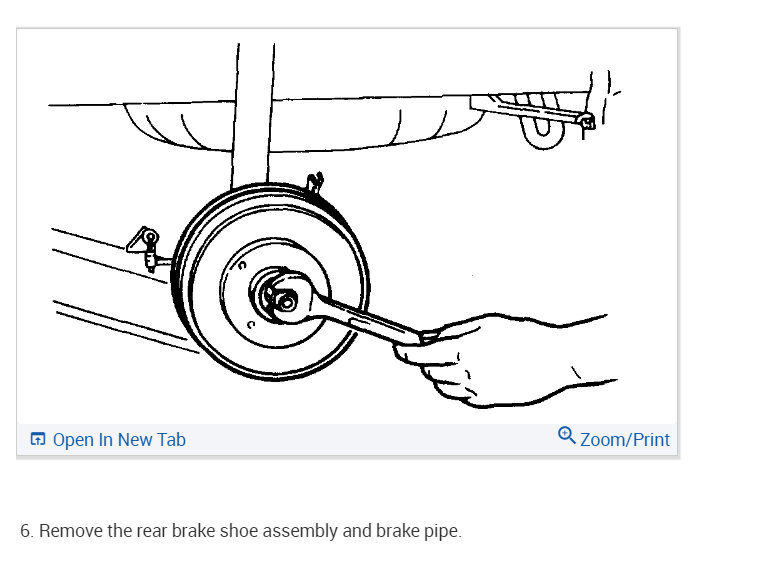

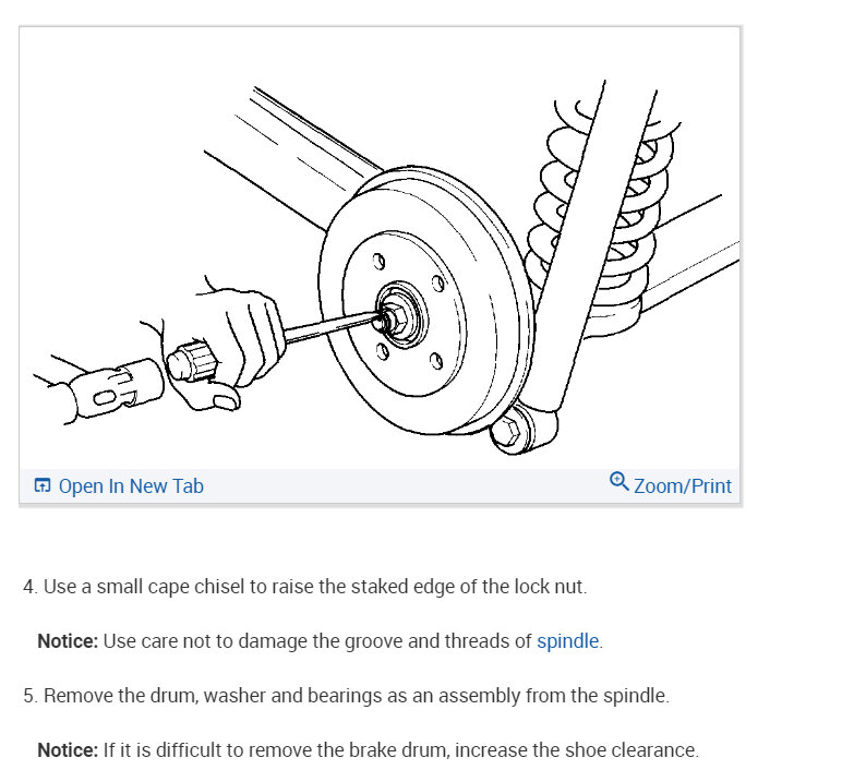

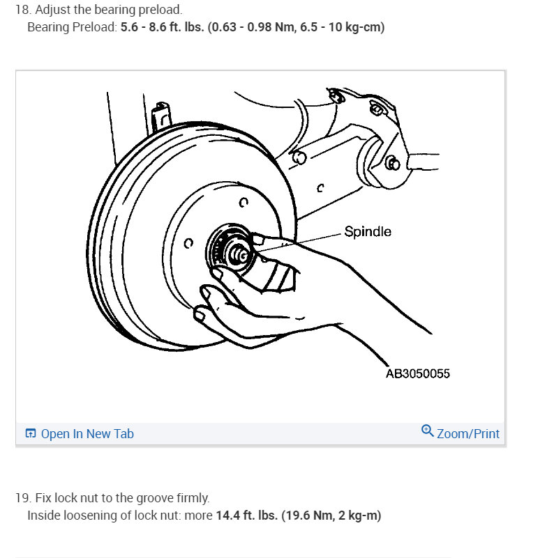

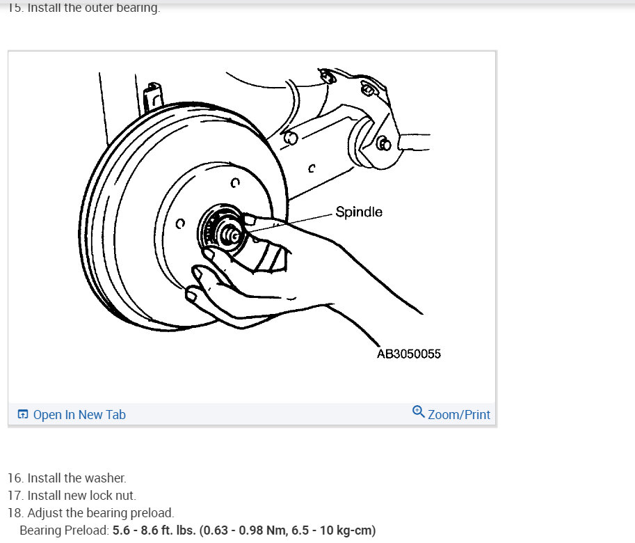

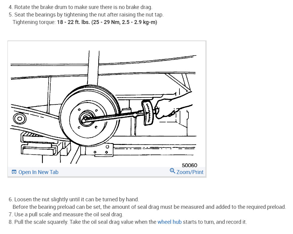

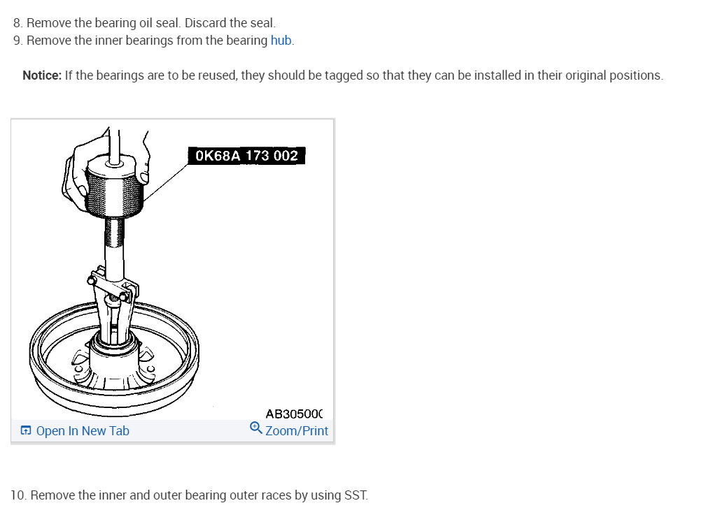

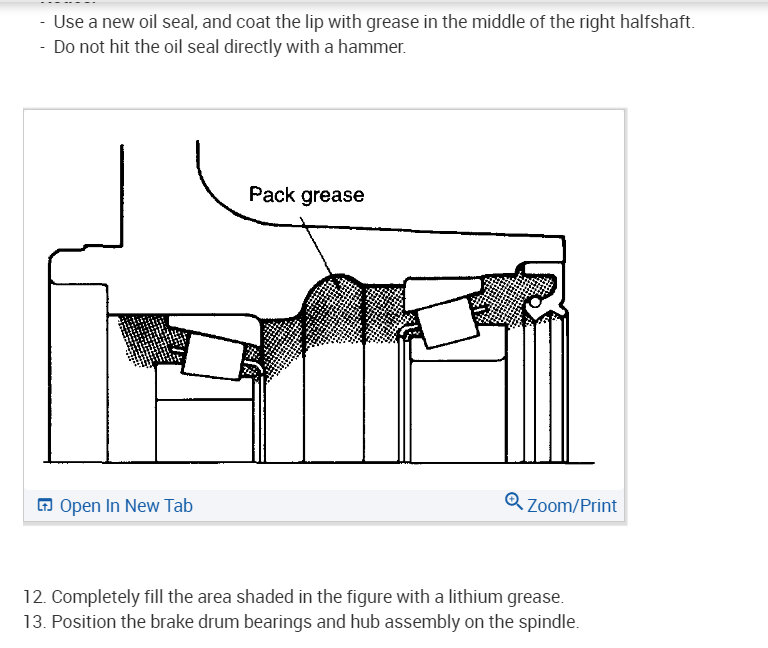

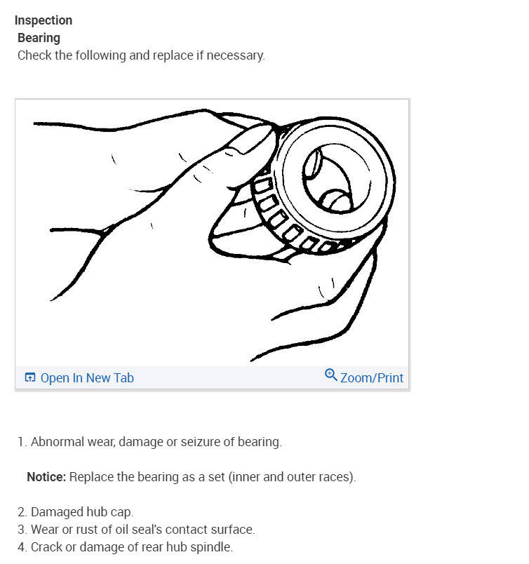

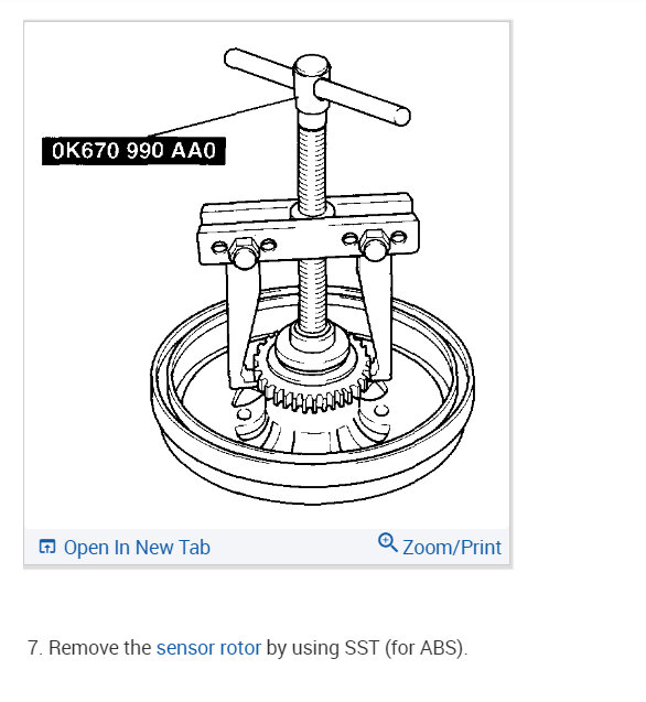

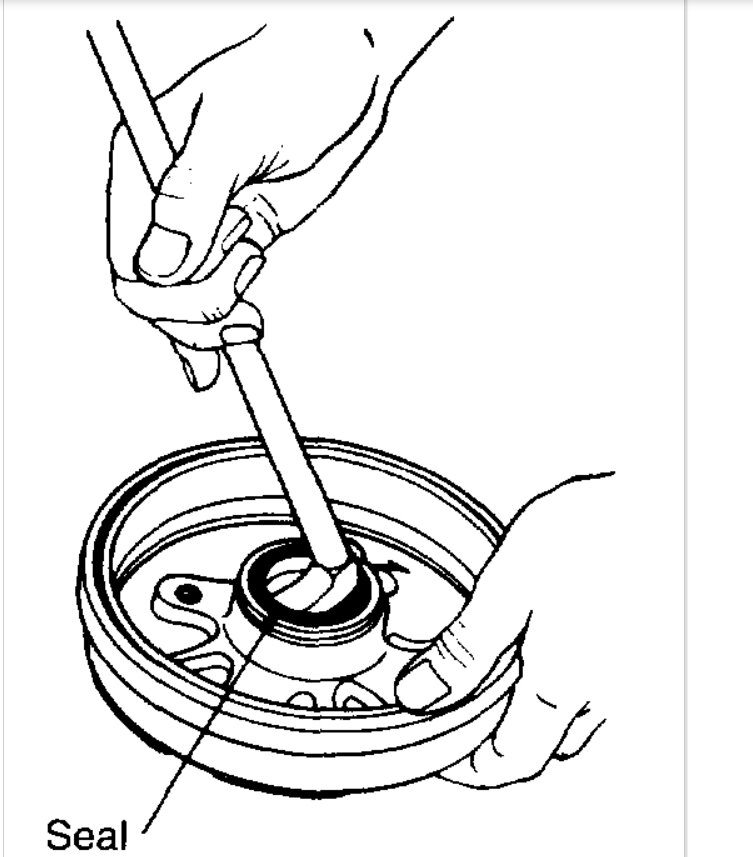

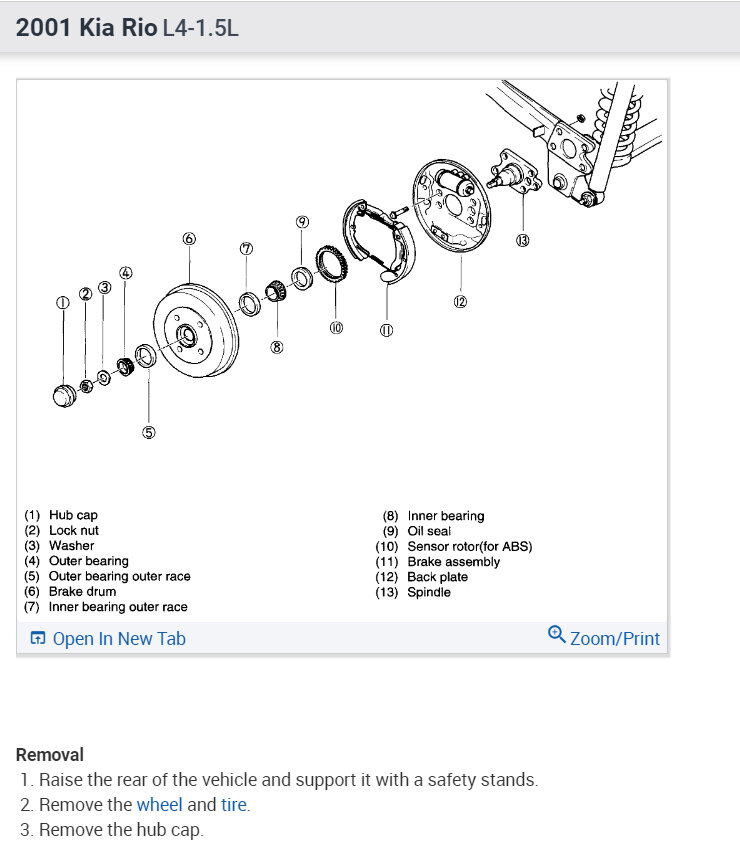

Need to locate a rear wheel bearing assembly chart so I can change it out.
Oct 25, 2008 at 7:25 AM
KIASCOTT
Here is the instructions on how to change the rear wheel bearing out. Check out the images (Below). Please let us know if you need anything else to get the problem fixed.
