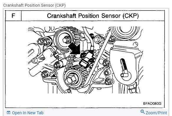

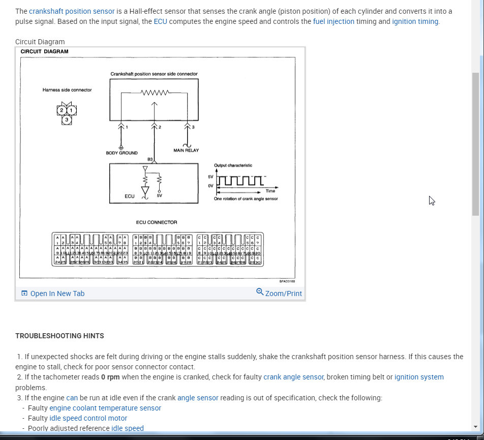

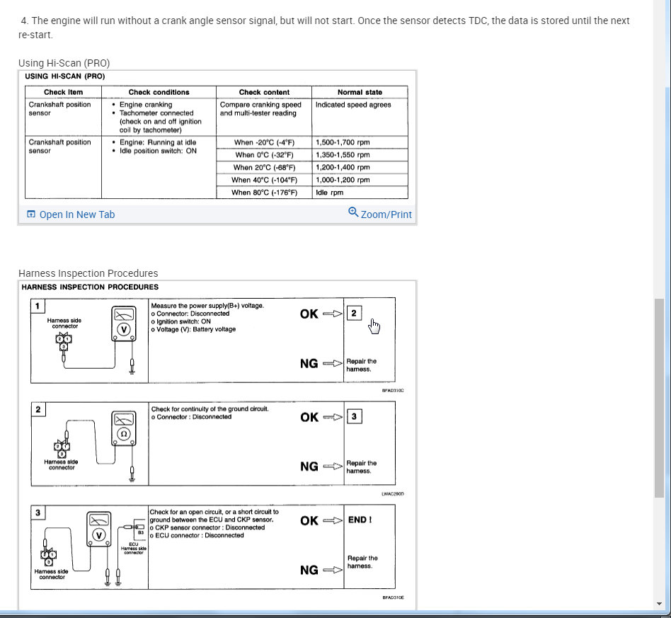

This makes a little more sense. This code is for your crank signal has low voltage. Unfortunately as you can see from the code info Kia did not provide detail about this code but this would cause the engine to shut off and not restart. Basically if the PCM looses the crank signal it doesn't know the position and it shuts it down. It will not restart because when you turn the key on it is not seeing proper voltage and so it prevents the start.
If it were me, I would replace the crank sensor and then retest for this code. I also attached testing for the sensor if you would like to run through that as well.

Thanks, I will give it a try. It's going to be a task to replace because this Kia requires you to remove the face of the engine to get to the sensor to replace. The hardest part is the harmonic balancer, Looks like it is time to have some fun.

Yes. It could be the sensor, wiring to the sensor, or the engine controller. Unfortunately there is no easy way to test the crank sensor unless your scan tool will read live data. If it does, can you watch the engine RPM in the PCM and see if it registers an RPM when the engine is cranking.
