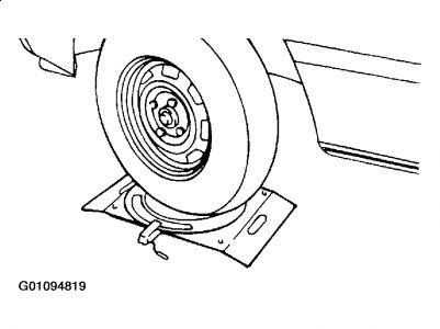

CHECKING STEERING ANGLE Place the front wheel on a turning radius gauge and measure the steering angle. Wheel angle [Standard value] Inside wheel: 40.70 ° Outside wheel: 32.40 ° If the measured value is not within the standard value. Adjust the linkage. Fig. 12: Checking Steering Angle Courtesy of KIA MOTORS AMERICA, INC.
