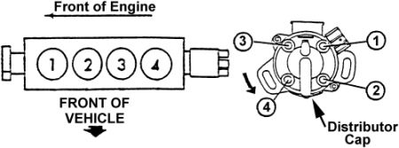

Hey I'm soldier deployed in Iraq was given this car to get to all the meeting and help get other soldiers to there appointments but it wasn't running. The plug wires were off this is a car from here in Iraq they have no marking on it like ones in america have no idea of year or engine size it is a 4 cyl. All it says is KIA, B5-25LD, KNAPA2222TA474701 and on the back of the car is SEPHIA need to find the firing order can you help at all

Hello Your firing order should be as follows: 1.8L Engines Firing order: 1-3-4-2 Distributor rotation: Counterclockwise
https://images.2carpros.com/forum/automotive_pictures/261618_0900c15280028430_5.jpg
