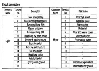

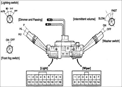

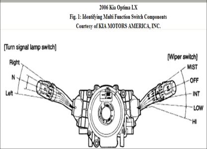

I have an 06 Kia Optima and want to install factory fog lights. I have aquired the turn signal selector and the fog lights from a wrecked vehicle. what I would like to know is does the factory wiring harness support the fog lights or does the harness require replacing?

Hello - From what I see it looks like it will work. It looks like the same harness. I have attached the pics of the info I have. To be sure you could check the parts department to see if the harness had a different part number with/without the fog lamps.
