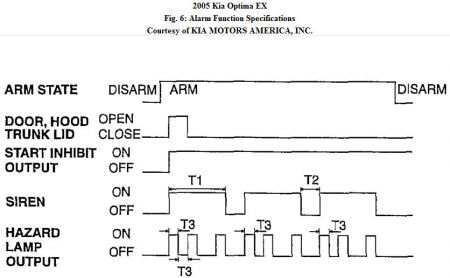

Check the alarm/immoboliser is off

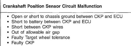

What is that, the car has no alarm. It will start once and that is with spraying starting fluid in the mass airflow and run for about 3-4 mins. After that no matter what it will not start again when it is running it does run a little rough. I ran a scan on it it keeps saying code p0338 p/d. Witch is the crankshaft sensor but it is pending.

Some models are fitted with an alarm sysem !
https://www.2carpros.com/forum/automotive_pictures/266999_kia_54.jpg
You are not getting fuel delivery ... check fuel pump fuse and relay are good ... check you have hot feed at fuel pump ... check pump is good by adding 12v direct to pump !
the pending code may just be there because it will not start .. but I would double check my timing marks !

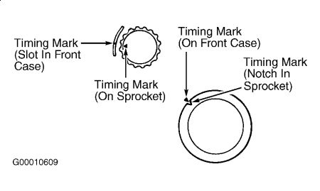

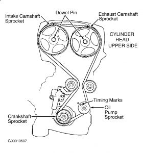

one more thing could you please tell me where the timing mark is for the cranshaft pully, that seem it just mite be the problem

https://www.2carpros.com/forum/automotive_pictures/266999_kia2_8.jpg
Install crankshaft sprocket "B" onto crankshaft. Ensure flange is properly positioned. Lightly oil outer surface of spacer, and then install spacer to right counterbalance shaft, with rounded edge of spacer inward.
Install right counterbalance shaft sprocket. Tighten flange bolt tightly by hand. Align timing marks on each sprocket and on front case. See Fig. 4.

CAUTION:If timing marks on camshaft sprockets do not line up properly, DO NOT rotate sprocket more than 2 teeth in either direction, or valve and piston will touch. If necessary, remove and reposition camshaft sprocket.
Install crankshaft sensor. Set timing marks of camshaft sprockets with notches on upper side of rocker cover and dowel pins straight up. Align crankshaft sprocket timing marks. Align oil pump sprocket timing marks.
Install timing belt in order around crankshaft sprocket, oil pump sprocket, idler pulley, exhaust camshaft sprocket, intake camshaft sprocket and tensioner pulley.
Gently raise tensioner pulley so belt will not sag, and then temporarily tighten center bolt. Ensure timing mark of each sprocket is still aligned. Remove wire from auto tensioner.
Rotate crankshaft 2 complete turns clockwise. Leave in this position for about 5 minutes. Measure auto tensioner protrusion "A" (distance between tensioner arm and auto tensioner body). Ensure auto tensioner protrusion is .22-.35" (6-9 mm). See Fig. 3. Install timing belt lower cover and upper cover.
