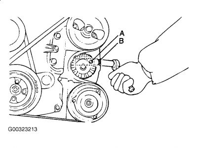

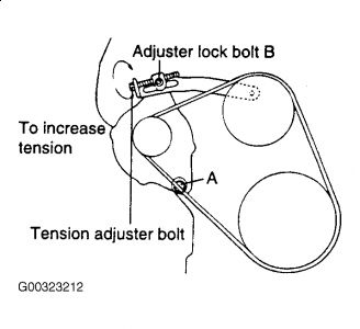

One of my belts is slipping when it is wet, How do I tighten the belts

BELT ADJUSTMENT Generator & Coolant Pump Loosen generator nut "A" and adjuster lock bolt "B". See Fig. 4 .
https://images.2carpros.com/forum/automotive_pictures/266999_4_12.jpg
Adjust generator to set belt tension to specified deflection. Tighten generator nut "A" and adjuster lock bolt "B" to specification.Recheck belt deflection after cranking engine over one or more revolutions and readjust as necessary. Power Steering & A/C Compressor Loosen tension pulley adjustment bolt "A". See Fig. 5 .
https://images.2carpros.com/forum/automotive_pictures/266999_5_9.jpg
Turn adjusting bolt "B" to set belt tension to specified deflection. Tighten tension pulley adjustment bolt "A" to specification. Recheck belt deflection after cranking engine over one or more revolutions and readjust as necessary.
