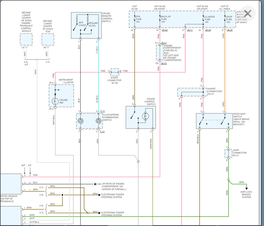

The speedometer intermitantly quits working. I cannot use my cruise control consistently. Can you help?
May 5, 2009 at 6:37 AM

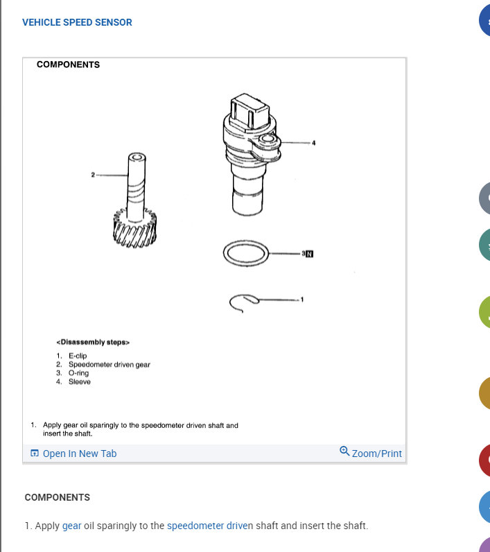

More than likely this is a speed sensor issue.

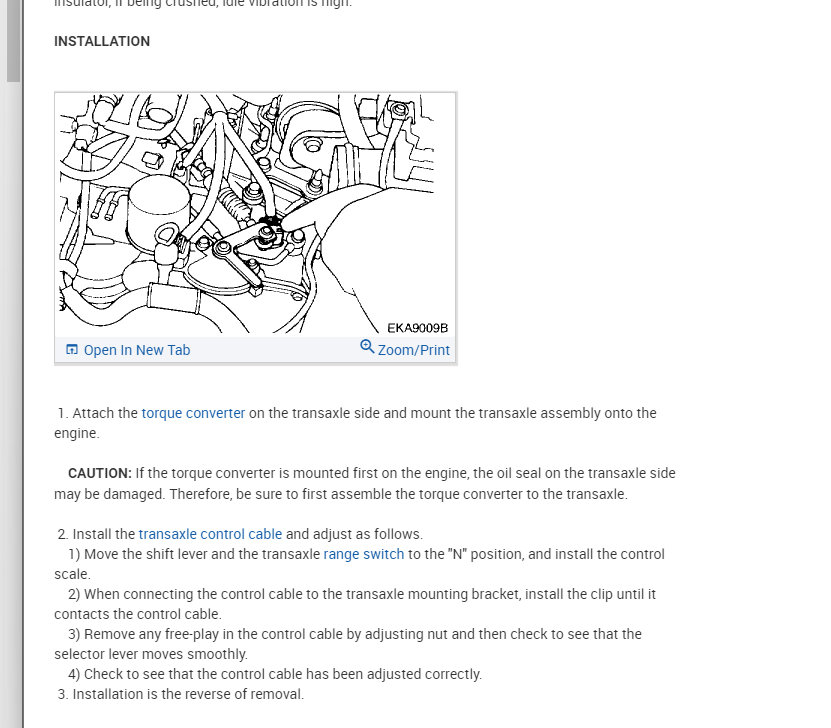

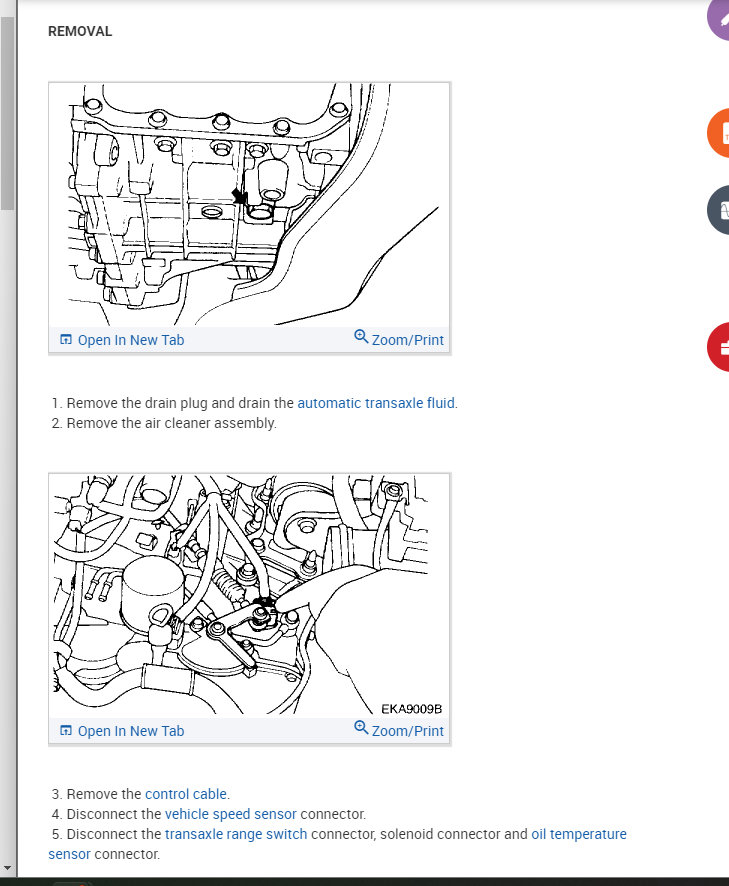

Below you will find the info from the manual on how to replace this speed sensor as I would suggest replacing it.

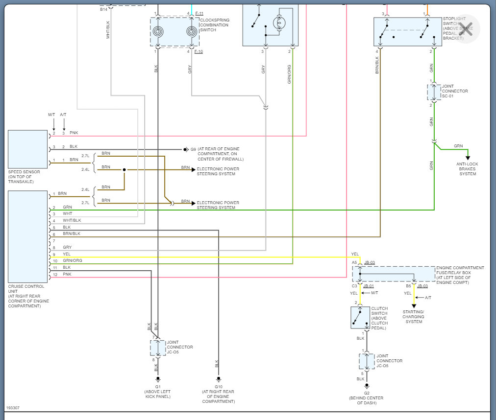

The way we need to test this is check the voltage that is coming from the speed sensor and make sure there is a power going to the speed sensor.
Here is a guide that will help with this:

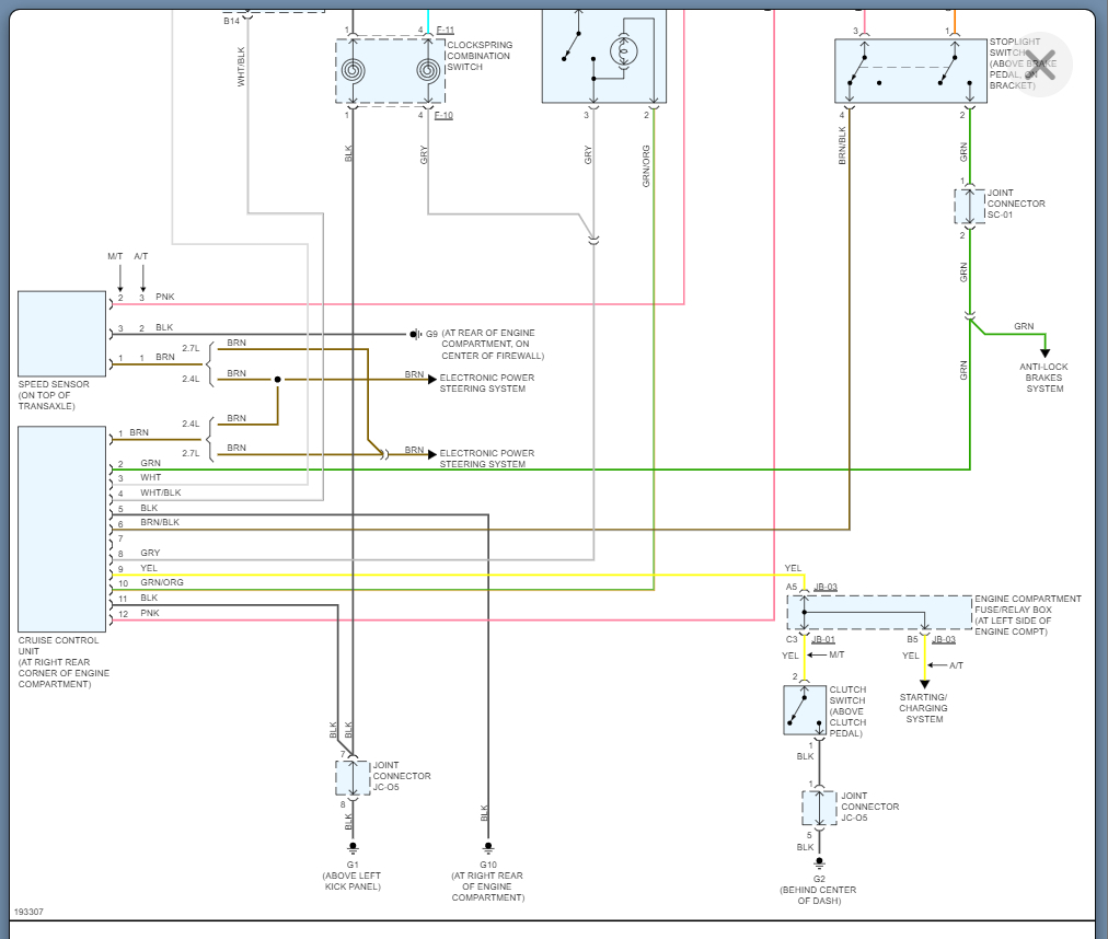

Below you will find the wiring diagram that will help with this info.
Please run through this and let us know what questions you have.
