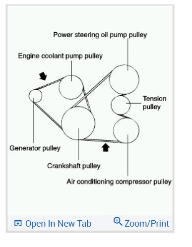

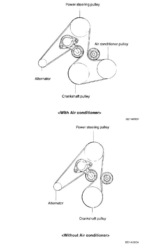

Can some one help me I need to replace the serpentine belt that runs the AC/power stearing pump I can not find how to do it any were. A routing diagram would be great also
Thanks
Patrick
Apr 21, 2009 at 1:48 PM
BLUELIGHTNIN6
  • 16,542 POSTS
Here is a guide to help you step by step with diagrams below to help you with your car
