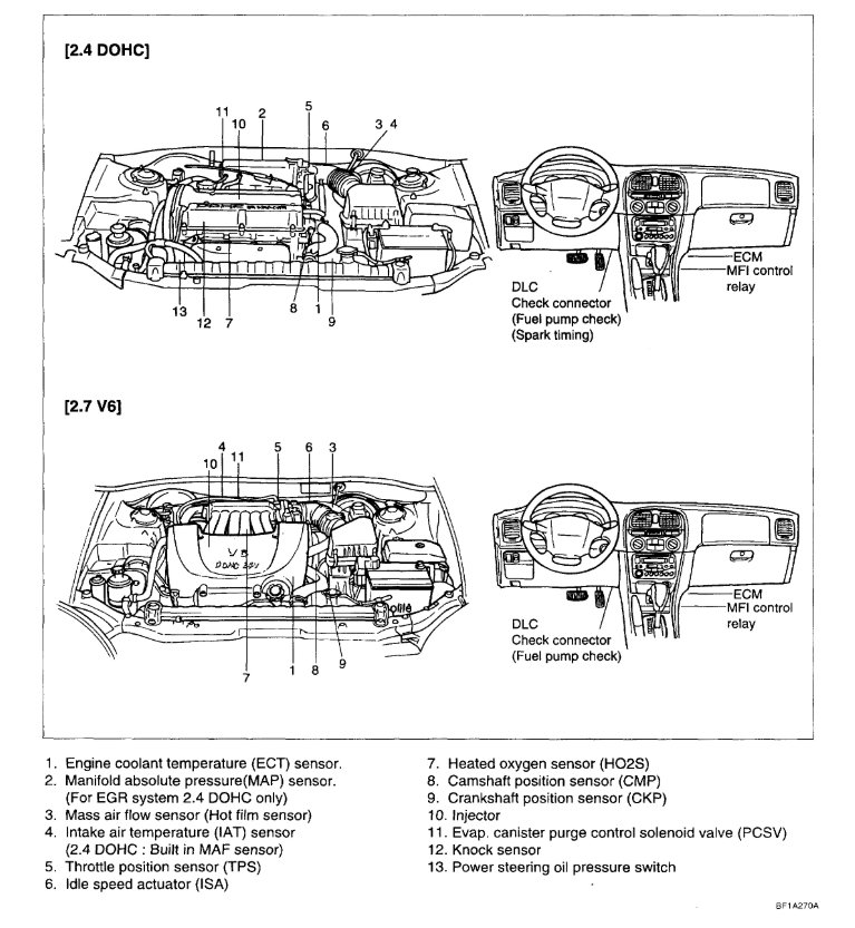

Where are the upper and lower oxygen sensors located on my car
Saturday, August 28th, 2010 AT 12:36 PM
MECHANIC
75,992 POSTS
Here is a guide to help you step by step with instructions in the diagrams below to show you how on your car.
https://www.2carpros.com/articles/how-to-replace-an-oxygen-sensor
Image (Click to make bigger)
