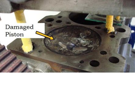

Did any of your pistons look like this when you had the head off?
https://images.2carpros.com/forum/automotive_pictures/435113_Untitled_4.jpg
This engine specifically suffers more damage than the usual interference engine when the timing belt brakes. There is likely piston skirt or connecting rod damage causing the engine. This will cause the engine to get stuck while cranking after all the work you did. You compression would still be good despite the damage. One question: You stated "On one and three getting white fire, logic probed." Do one and three share the same coil, and so two and four are not getting spark? You can repost as needed. Regards,
