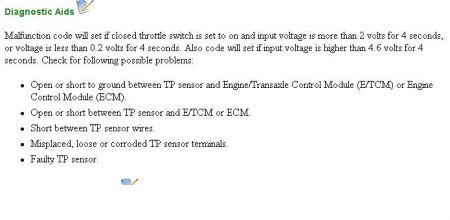

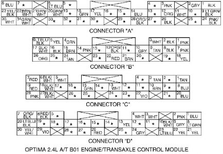

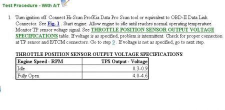

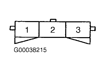

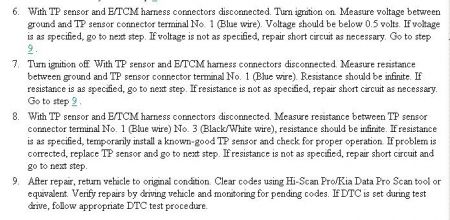

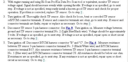

i have problem vith p0123 nev TPS sencor ,engine comp. and i have hig voltage on pinck vire 12v that vire comes from fuse box to tps sensor. pleas help.txanks
Feb 4, 2009 at 7:39 AM
ZACKMAN
  • 4,202 POSTS
Try this.
https://images.2carpros.com/forum/automotive_pictures/55316_02optimap0123_1_1.jpg
https://images.2carpros.com/forum/automotive_pictures/55316_02optimap0123_2_1.jpg
https://images.2carpros.com/forum/automotive_pictures/55316_02optimap0123_3_1.jpg
https://images.2carpros.com/forum/automotive_pictures/55316_02optimap0123_4_1.jpg
https://images.2carpros.com/forum/automotive_pictures/55316_02optimap0123_8_1.gif
https://images.2carpros.com/forum/automotive_pictures/55316_02optimap0123_fig4_1.jpg
