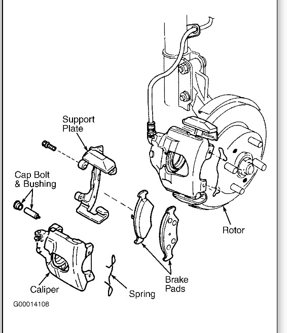

fixing front and rear disc brakes on the car listed above it is Australian. does anyone have a diagram of these and I need the caliper torque specs? please, thanks.

we do not have any corresponding car here in US. it was only sold in Australia and Korea. picture i am sending is off a Kia Sephia model for that year it may be similar if this looks like yours I can send torque specs but they may not be correct.

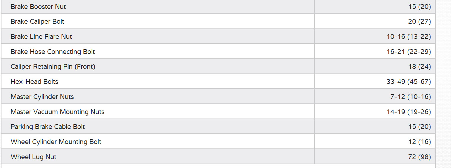

thanks for the kia brake diagram,ill get the torque specs too please.i can compare them to other kias.thank you

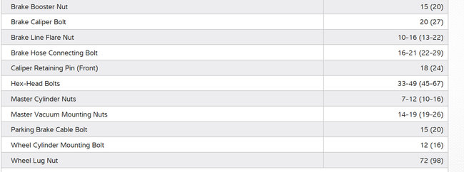

first column is foot lbs. second Nm see pic
