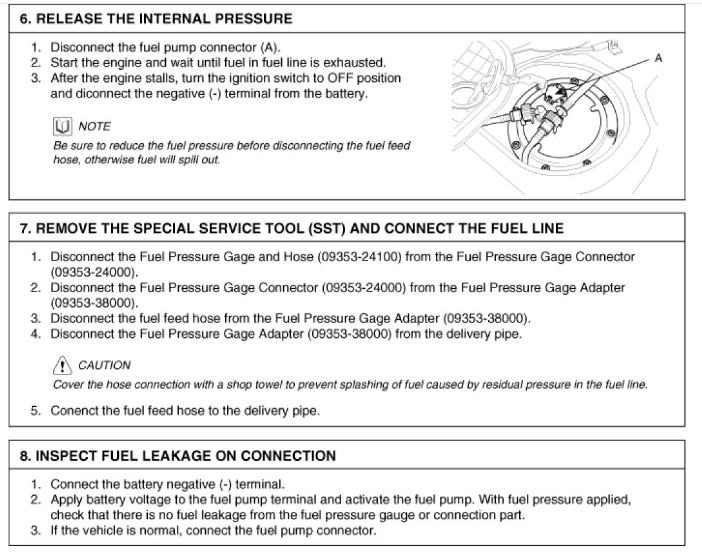

There is a long cranking time before starting, code p0171 system too lean bank 1. I checked and found no vacuum leaks. I clean mostly all the sensors and same issue. Any help will be appreciated. Thanks.
Nov 14, 2024 at 1:46 AM
  • 110,248 POSTS

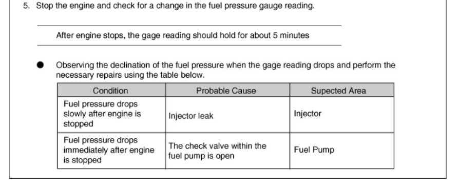

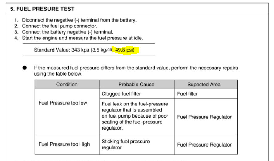

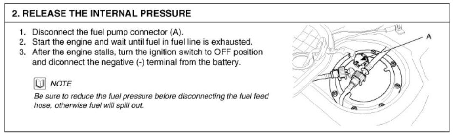

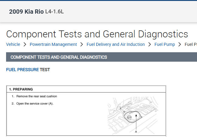

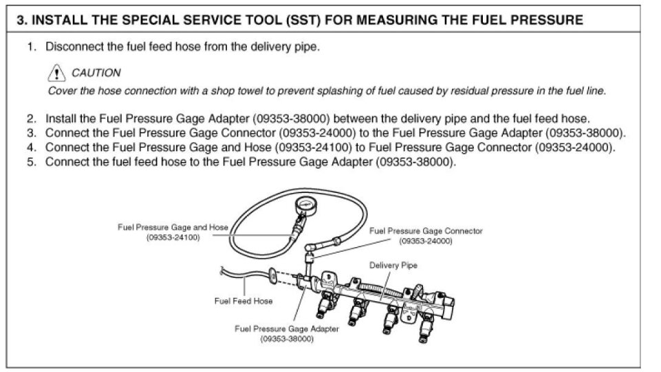

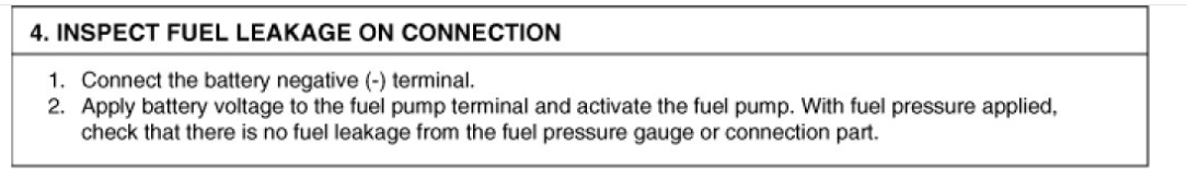

If there are no vacuum leaks, the next thing to check is the fuel pressure. If the pump is weak, it can cause a lean fuel mixture.
Here is a link that explains how in general to check pressure:
If you look below, I attached the manufactures directions for testing specific to this vehicle. The directions include the pressure specifications.
You will need a fuel pressure gauge. Often times, a parts store will lend one to you if needed.
Let me know if this helps, if you have other questions, and what you find.

Good day, the fuel pressure was low, I replaced the fuel pump and no more P0171 code after driving for a few days now.

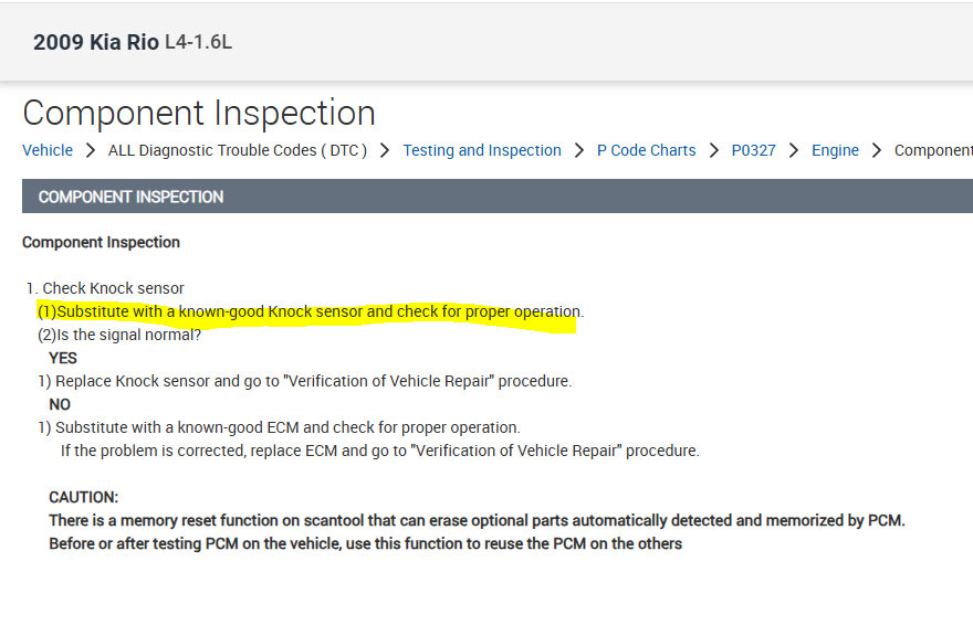

Good day, after about a week of driving the car, gas mileage is not too good and still a few cranks before starting. I did a scan and code P0327 is showing. I inspected the wire harness, and it looks good. Could you send me testing procedure for the knock sensor?
Nov 28, 2024 at 5:02 PM
  • 110,248 POSTS
I attached the directions from my manual below. Note that it really isn't a test procedure of the present sensor. Instead, they indicated that you should replace it with a known good one to check. Ugh! Take a look and let me know your thoughts.
If you have a live data scan tool, you should be able to check the sensor parameters when the engine is at operating temperature.
Are you hearing any valve ping or knocking?
See pic below.
Nov 29, 2024 at 10:40 AM
HSNDSOME
  • 33 POSTS
I'm hearing valve pinging, I don't have one to try, so I will replace the sensor, I cleared the code and I drove the car so will check to see if the code comes back. But will this cause long cranking to start an high gas consumption. I got 300 km on a full tank of gas.
Nov 29, 2024 at 12:36 PM
  • 110,248 POSTS
It could cause all that you mentioned. The sensor is used to fine-tune ignition timing to allow the engine to run more efficiently.

  • 110,248 POSTS
If you have a leaking injector, it will cause pressure to drop off. If you have a chance, let me know what you find.
