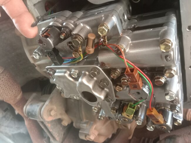

The car has the name Kia Morning, but it is the same as Kia Picanto.
At approximately 30 MPH (45kph) when shifting from 2nd to 3rd gear the car engine will over rev for approximately one second (transmission flare) then return to normal RPM when the shift is complete. When the shift to 3rd has taken place if I do not increase the car's speed the transmission it will down shift again back and forth between 3rd to 2nd then back up to 3rd.
If I maintain a constant speed of 40 MPH (60kph) and no load (flat road, no incline) the transmission will sometimes shift down momentarily then immediately shift back.
The car will predictably do the 2nd to 3rd flare but occasionally also when changing from 1st to 2nd.
I live in a constantly hot climate, so a cold temperature is not a factor.
Once in 3rd gear the car drives very well.
I have had this issue for many months.
The fluid was changed 3 months ago. Kia needs a special fluid type which is not available in my country so Valvoline Maxlife (which is Kia compatible) was used but it made no improvement.
The transmission fluid level is constantly checked usually after returning from driving the car.
The transmission has no leaks.
When the problem started a transmission code reader monitored the car while driving. The flare occurred repeatedly but no codes were set, and none were initially found.
When the fluid was changed the pan and filter were removed and cleaned. The attached pics are of the solenoids.
If replacing solenoids is considered necessary, then I need a recommendation for a reliable supplier that will ship with an online order. Solenoids are not available from parts suppliers locally.

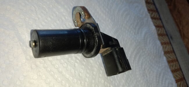

LESLIE PAYNE
  • 42 POSTS
Hi Ken,
In heavy rain I got the sensor out, pic attached.
Can you tell me if this sensor can be tested and how to do before I try and find one overseas online?
Thanks.
Jul 18, 2023 at 2:59 PM
  • 55,863 POSTS
Sure, though it is not a 100% test use a voltmeter on OMHs and attach them to the terminals. it should be about 0.2 OHMs if the sensor is good, if it is over 1.0 ohms replace the sensor.
