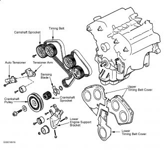

We are having to set the timing on our Kia. How do we do that and where can I find the information specific for our vehicle?

TIMING BELT Removal Disconnect negative battery cable. Remove engine cover. Using 16-mm spanner wrench, rotate serpentine belt tension arm clockwise about 14 degrees to relieve belt tension. Remove serpentine drive belt. Remove power steering pump pulley, idler pulley, tensioner pulley and crankshaft pulley. Remove upper and lower timing belt covers. See Fig. 1 or Fig. 2 . NOTE:Rotate crankshaft clockwise and align timing mark to set No. 1 cylinder to TDC on compression stroke. Ensure timing marks of camshaft sprocket and cylinder head cover are matching. See Fig. 5 . On all models, remove auto tensioner. See Fig. 3 . NOTE:If timing belt is to be reused, mark rotational direction on belt for reinstallation reference. Unbolt timing belt tensioner pulley, and remove timing belt. Inspection Inspect timing belt for wear on edges of drive teeth. Inspect the belt for signs of oil contamination, cracks, separation, worn or missing teeth, or hardened Black surface. Replace belt if worn, damaged or contaminated. Inspect belt tensioner pulley for smooth rotation. Replace if defective. Check timing belt auto tensioner for leaks. Replace if necessary. Installation Install timing belt idler pulley to engine support lower bracket. Install tensioner arm, shaft and washer to cylinder block. Tighten tensioner arm bolt to specification. See TORQUE SPECIFICATIONS . CAUTION:Use care to avoid bending crankshaft sensing blade of crank angle sensor. Install crankshaft sprocket and align timing mark. See Fig. 4 . Install camshaft sprocket and adjust installation positions as shown. See Fig. 5 and Fig. 6 . Install auto tensioner to oil pump case. Ensure that auto tensioner set pin is completely assembled. Align timing marks of each sprocket. Install timing belt in this order: crankshaft sprocket, idler pulley, left exhaust camshaft sprocket, left intake camshaft sprocket, water pump pulley, right intake camshaft sprocket, right exhaust camshaft sprocket, and tensioner pulley. Ensure timing marks are correctly aligned. Install tensioner pulley. Pull set pin from auto tensioner. Rotate crankshaft 2 revolutions clockwise. Wait 5 minutes. Measure projected load of auto tensioner in TDC. Ensure projected length is .15-.18" (3.8-4.5 mm). See Fig. 7 . Recheck timing marks at each sprocket to ensure each sprocket is in correct position. If not, repeat installation of timing belt and auto tensioner.
https://images.2carpros.com/forum/automotive_pictures/266999_kia_37.jpg
