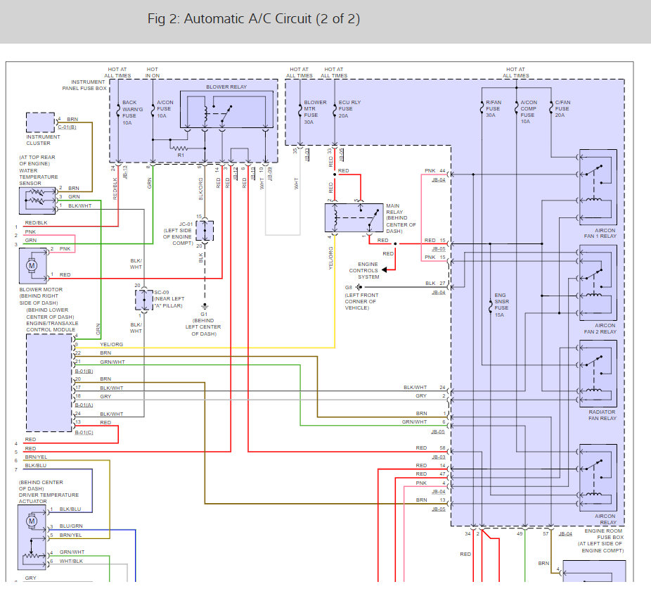

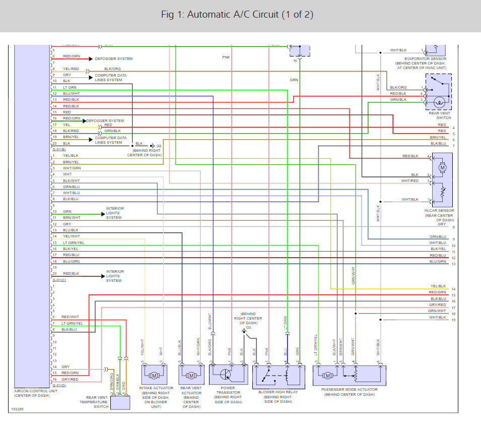

It stopped working one day. A week later it worked again at all speeds for a couple days and then stopped again (at all speeds, even high). I unplugged the power plug to the blower motor and tested the motor with jumper cables and it spun fine. When I put the the fan to 'high' I can hear the high relay click so I don't know if that's what it's supposed to do. I unplugged the power transistor plug and tested the voltage with a multimeter. The voltage readings were about half of what the manual said they were supposed to be, but there were voltage changes. I checked the continuity of the blower transistor and there were no readings at all. I heard the the blower transistor only controls the low speeds... but the high speed doesn't work either. Fuses are not blown. Is it the high relay, the blower power transistor or something else?? Also, while I was testing the blower, the fan worked at all speeds again until I turned the motor off and restarted it... then nothing. Please help!!

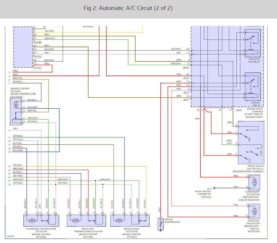

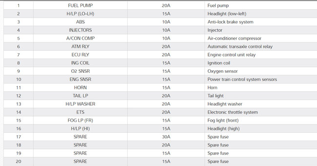

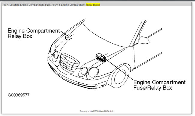

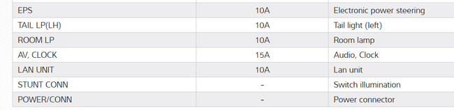

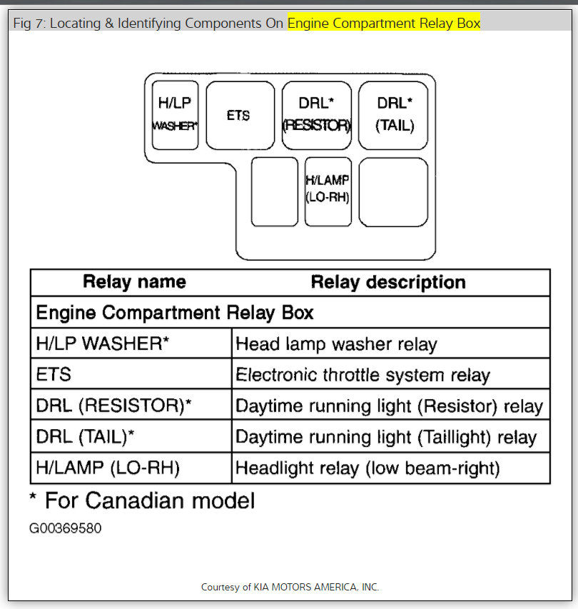

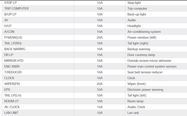

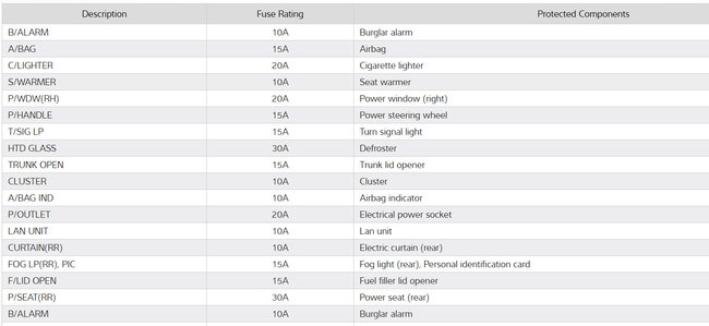

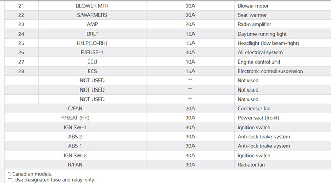

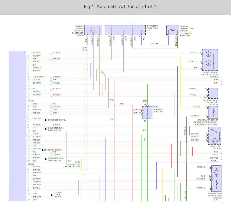

There is a blower motor relay that is out here are the blower motor and air conditioner wiring diagrams so you can see how the system works and a guide on how to test the relay.

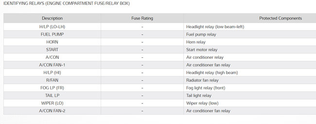

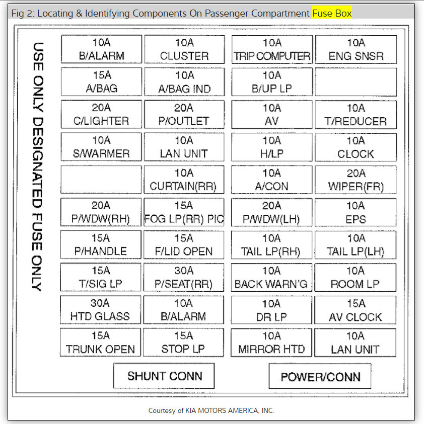

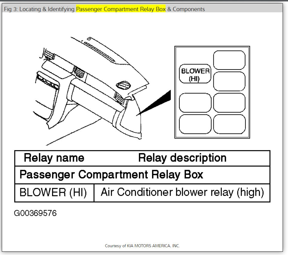

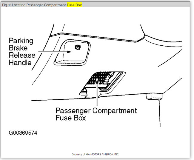

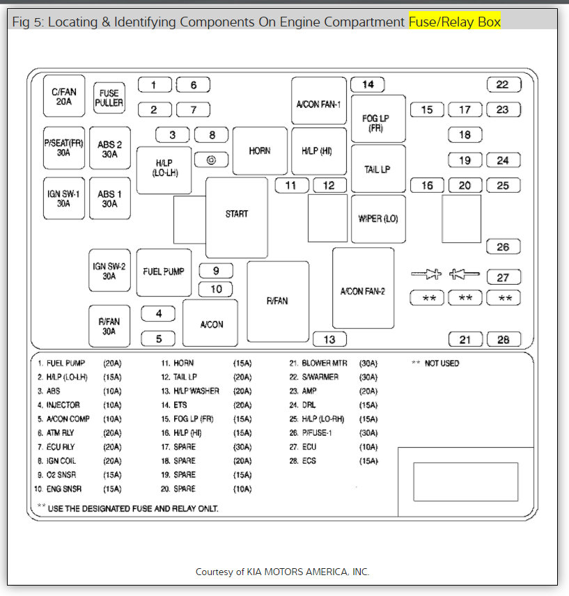

Here is the blower relay and fuse locations
Cheers

Just because the relay clicks does not mean it is working, did you try removing the relay and jumping it using a wire?

I believe there is a relay. Check under the hood for the relay block and see if you can locate it.

Kia calls it a 'power transistor' There are only 3 pins on the plug that plugs into the transistor. I was told to check the voltage between pin 1 and pin 2 and that's where I got the different voltage readings based on the speed on the dash. We maybe talking about two different things. I know the hi-relay is getting something because it 'clicks' when I put it on high speed, but no power to the motor. Would the relay 'click' if it weren't getting power?
