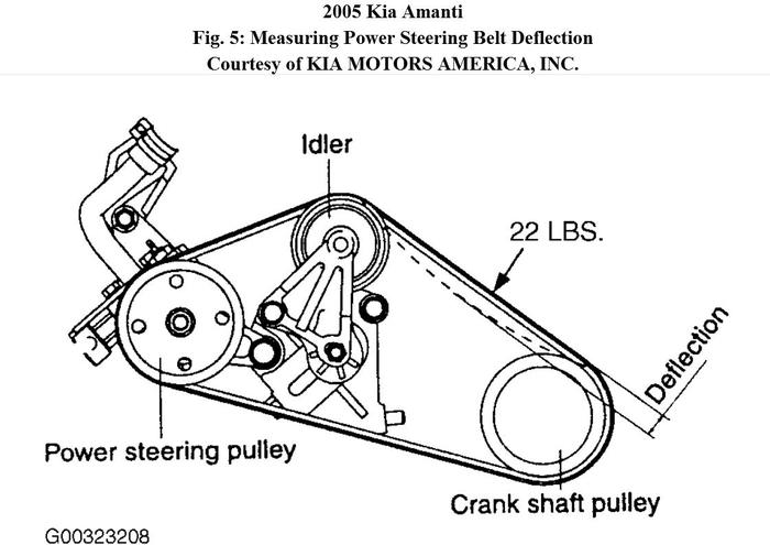

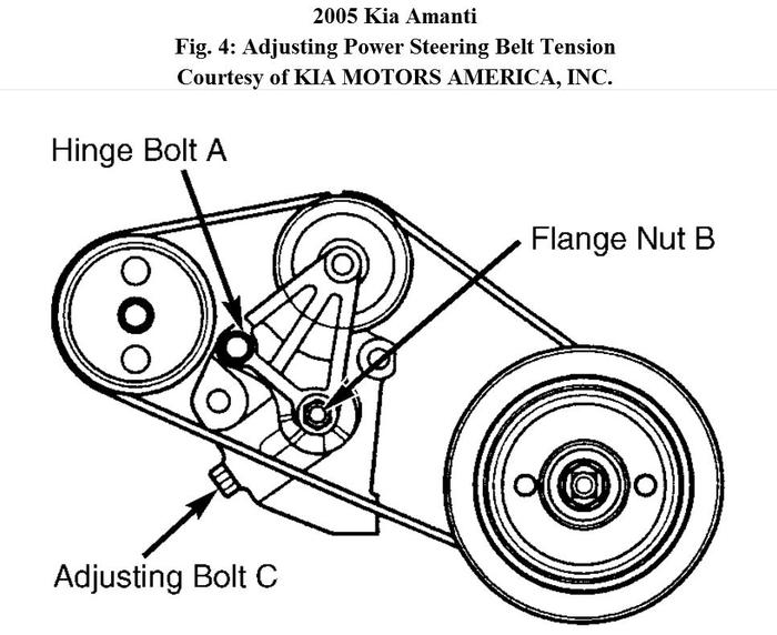

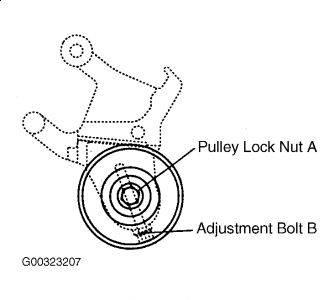

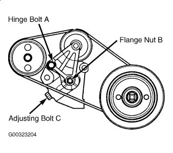

How do I release the tension to change the belts?
Jul 2, 2009 at 6:10 AM
DAVE H
  • 13,384 POSTS
BELT ADJUSTMENT Power Steering Loosen hinge bolt "A" and flange nut "B". See Fig. 4 . Turn adjusting bolt "C" to set belt tension . See Fig. 4 and Fig. 5 . Tighten hinge bolt "A" and flange nut "B" to specification. Alternator & Air Conditioning Compressor Loosen pulley lock nut "A". See Fig. 6 . Turn adjustment bolt "B" to set belt tension . See Fig. 6 and Fig. 7 . See BELT ADJUSTMENT table. Tighten pulley lock nut "A" to specification. Start engine and turn A/C on. Allow vehicle to run until normal operating temperature is reached. Turn engine off, recheck belt deflection after operation and readjust belt tension as necessary.

1. Loosen hinge bolt "A" and flange nut "B". See Fig. 4 .
2. Loosen adjusting bolt "C" until you are able to get belt off.
3. Install new belt. After belt is seated, pull it to slide around pullies to ensure it is seated correctly.
4. Turn adjusting bolt "C" to set belt tension to specified deflection.
5. Tighten hinge bolt "A" and flange nut "B" to specification.

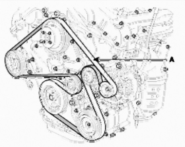

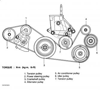

need a serpentine belt diagram for a 2005 kia amanti
May 10, 2019 at 11:34 AM (Merged)
DAVE H
  • 13,384 POSTS
https://images.2carpros.com/forum/automotive_pictures/266999_am_2.jpg
RICK MAHAN
Serpentine broke, need to replace but it seems too long following diagram.
WRENCHTECH
  • 20,761 POSTS
Here is the diagram.
RICK MAHAN
Thank you so very much. It worked. Your help is very much appreciated.
