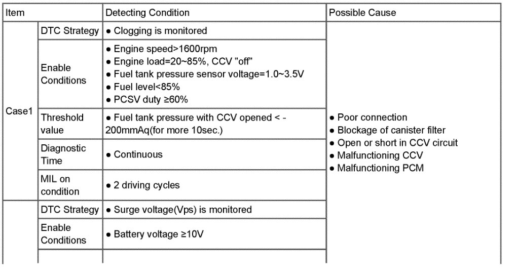

The first code test came up with PO431, so I replaced the cats and the sensors. The second code was PO455, so I replaced the purge valve and those codes disappeared. The third code was PO446, I apologize for the fubar on the po466 earlier. This vehicle is beating to no end. Anyways PO446 showed up so I replaced the vent valve, but it's still on the last code after the drive cycle.
Oct 6, 2022 at 9:20 PM
  • 110,194 POSTS

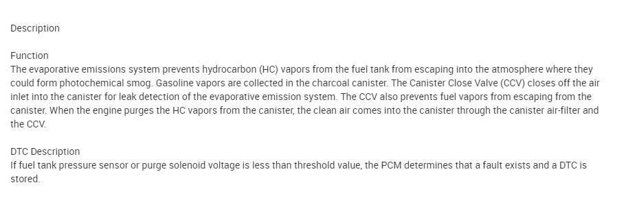

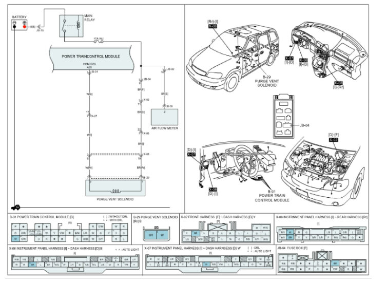

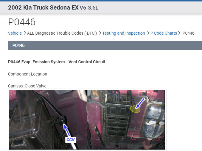

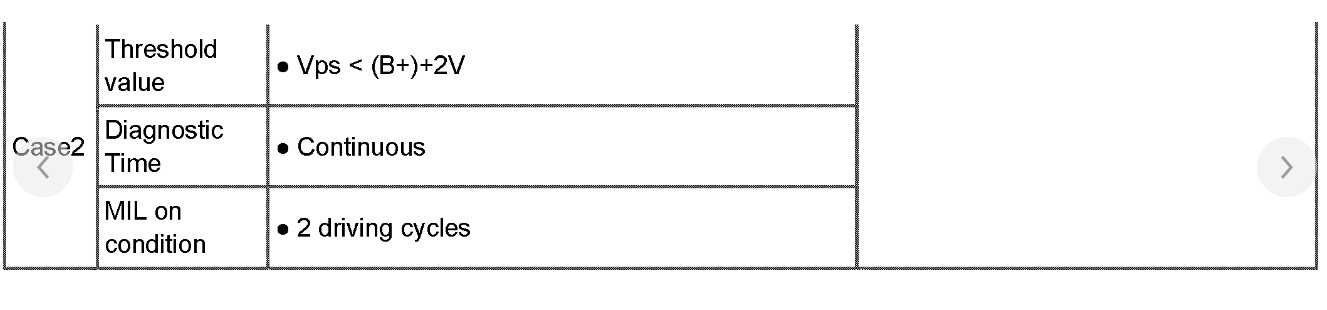

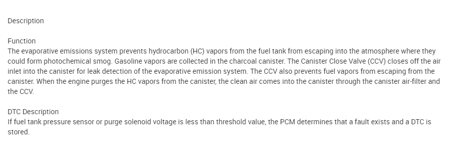

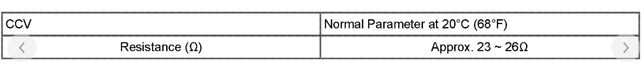

No problem. The P0446 makes sense now. LOL, this code doesn't necessarily indicate the control valve is bad. It indicates a fault in the circuit. It could be a wiring issue, a module issue, or even a partially plugged canister filter.
Do me a favor. I attached diagnostics below. Take a look through them and let me know if you are comfortable performing them.
