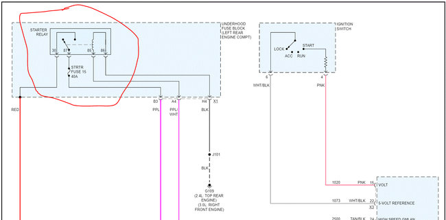

I just bought this vehicle it drives nice and I know it needs a sensor which I have and overall like it. but when I leave my key in the ignition on the off position it wants to wind over like it's trying to start. can anyone help me on this?
Jul 16, 2020 at 5:39 PM
  • 110,194 POSTS

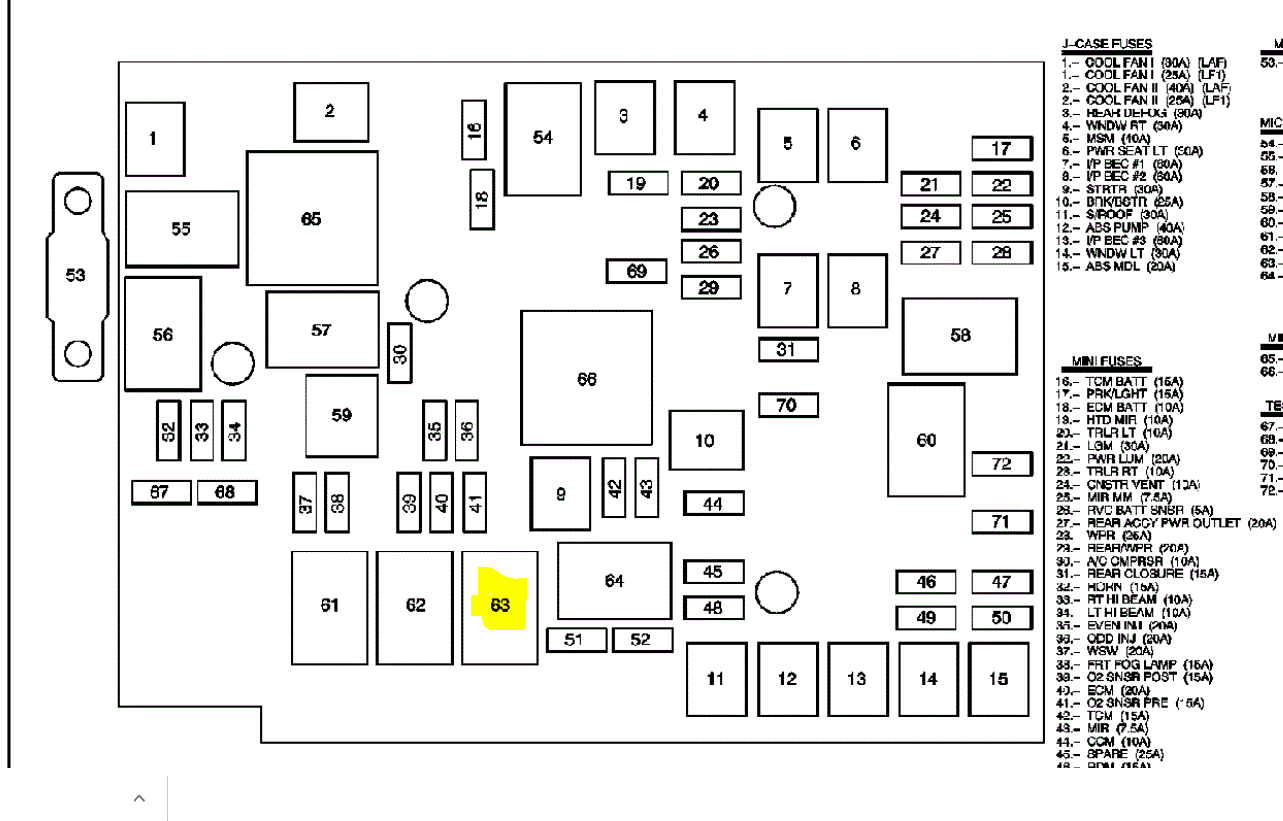

If the starter is engaging with the key in the off position, something is shorting power to the starter. That is a concern. The first thing I need you to do is remove the starter relay and see if that prevents the starter from engaging. If it doesn't, then we know we have a short to power after the relay. If it does stop it, switch that relay with a different one in the box having the same part number and see if it makes a difference.
Here is a link that explains how to test a relay and wiring control circuit:

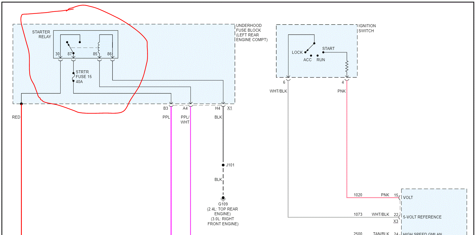

I attached a couple pics below. Pic 1 is a portion of the wiring schematic for the starter system. I circled the relay and to the right, it indicates it is in the under hood fuse box.
Pic 2 shows the starter relay position in the fuse/relay box. It is relay number 63.
Let me know what you find.
