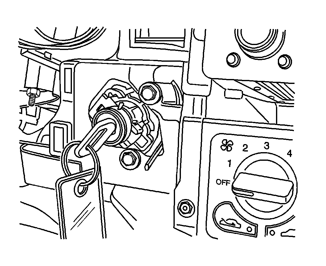

I think I can fix it by drilling out the lock but unfortunately the two handles of the assembling at the tumbler fits in and been separated and I have four. Brass pins and five springs I need to know which holes those go in.

First, I need a better understanding of what is happening. It sounds like you have the internal components from the key tumbler. If that is the case, a fix is unlikely. Additionally, what will be, "drilled out?"
If you decide the switch / tumbler needs replaced, here are the directions specific to your vehicle. That attached pictures correlate with these directions.

1. Disconnect the negative battery cable.
2. Remove the instrument panel (I/P) cluster trim plate.
3. Insert the key and turn the ignition lock cylinder to the ON/RUN position.
4. Using a small curved tool or an L-shaped hex wrench, depress and hold the detent on the ignition lock cylinder. Access the detent by placing the tool through the I/P opening to the right of the ignition switch. If you cannot locate the detent with the tool, lower the ignition switch away from the I/P. Refer to Ignition Switch Replacement.
5. Using the key as an aid, pull to remove the lock cylinder from the switch.
6. Remove the key from the lock cylinder.
7. If the cylinder does not rotate or is seized, follow the procedure in the ignition switch replacement. Refer to Ignition Switch Replacement.

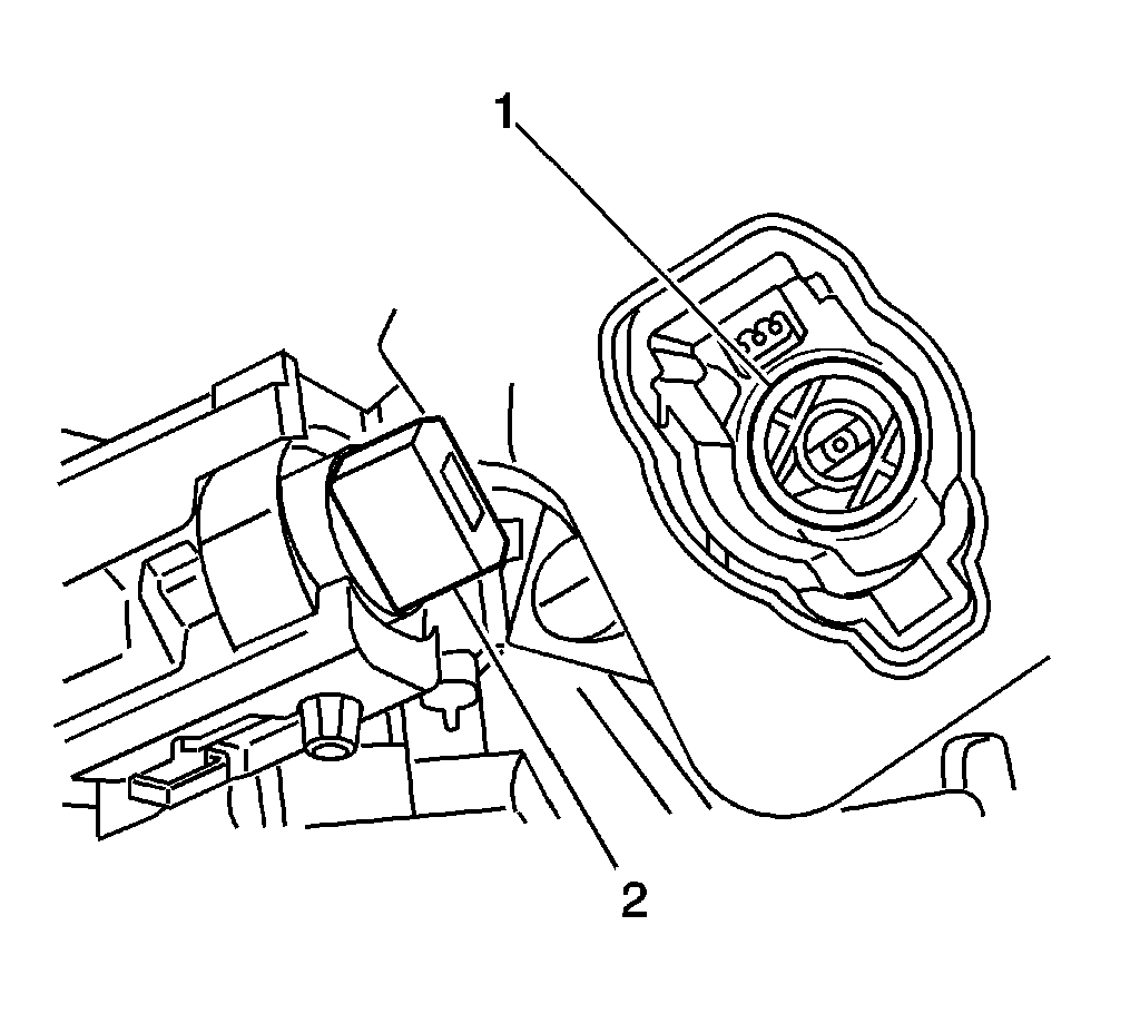

INSTALLATION PROCEDURE
1. Code the ignition lock cylinder, if necessary. Refer to Key and Lock Cylinder Coding.
2. Insert the key and turn the lock cylinder to the ON/RUN position.
3. Position the lock cylinder to the ignition switch. Press the cylinder into place. If you turned the key slightly while removing the lock cylinder, you may have to align the white colored ignition switch rotor (1) with the lock cylinder (2). You can rotate the ignition switch rotor (1) with your finger.
4. Turn the key to the OFF position and remove the key.
