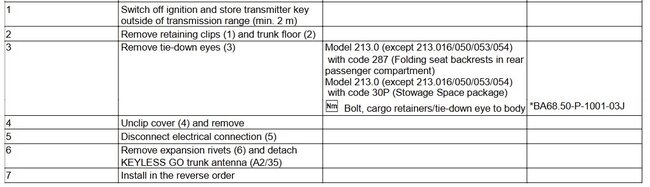

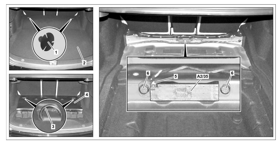

I need to replace the Amplifier for the Keyless Go antenna in the rear of the car. I'm looking for detailed instructions on trim removal and the location of the part in the car.

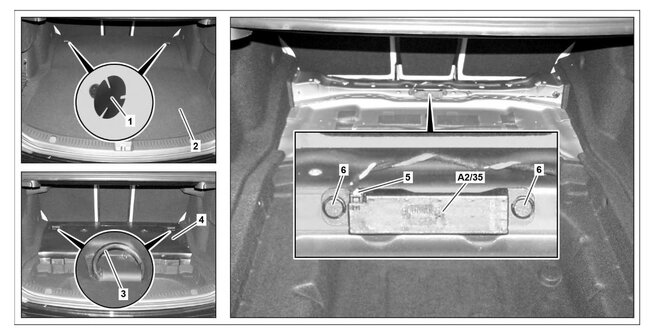

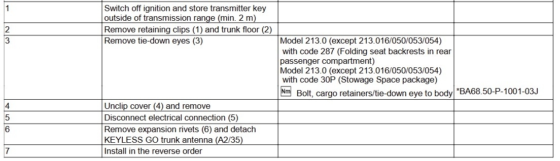

There are 2 antennas in that system. The front one is in the console between the seats. The rear antenna is in the trunk. You remove the trunk carpet, then at floor lever at the front the antenna is in the middle. Remove the fasteners and the antenna will come out. Then you reverse the process to install the replacement.
