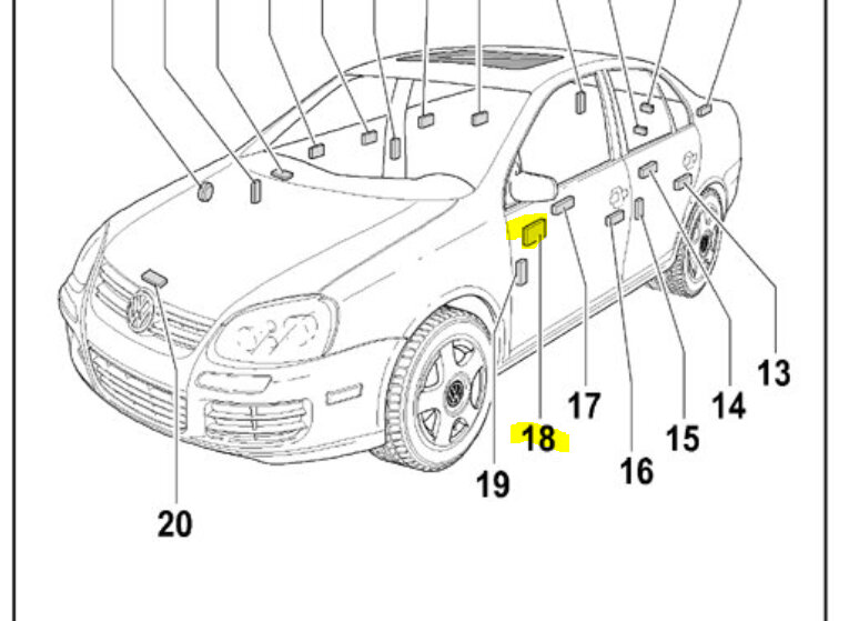

Neither of my key fobs work now. I never had any issues before. I'm thinking either a fuse or the receiver needs to be replaced. Anyone have knowledge of this and where to find the receiver location? Fuses to check if there is any for this? Thanks

I managed to scan the central locking system, pulled two codes. B122F29 drivers side contact switch, and code B122D29 lock unit for central locking system implausible signal.
Dec 11, 2023 at 1:37 PM
  • 110,241 POSTS

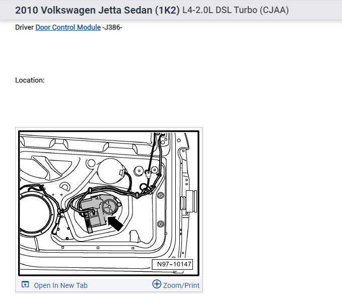

Based on the codes, I suspect the door lock control module has failed. They are known for a micro switch internally to fail.
The driver's door module is integral to the window motor regulator. See pics below.
If this is to be replaced, the new components need to be coded to the vehicle.
