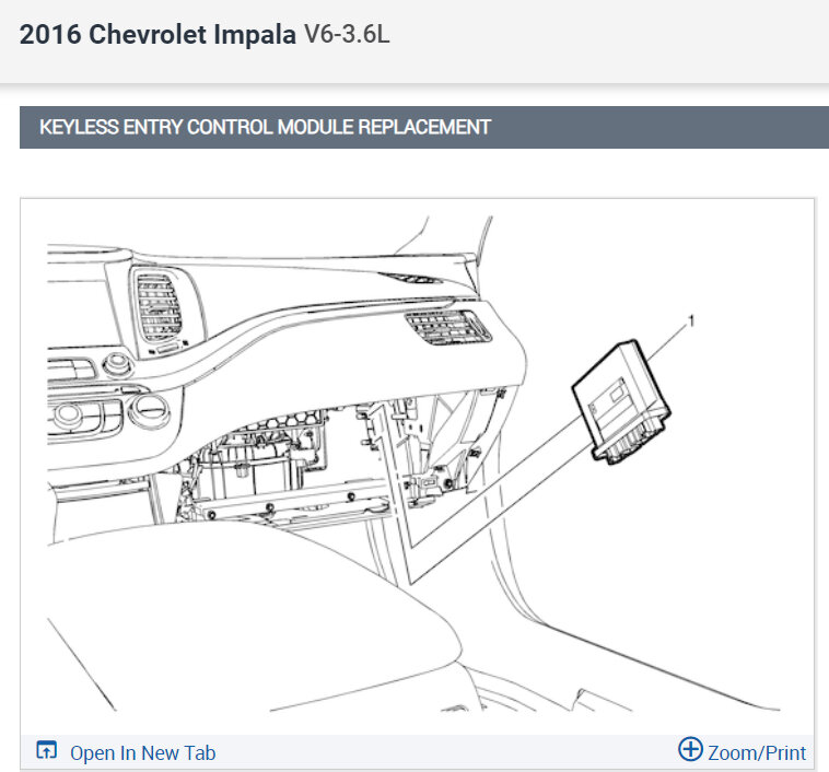

Hey guys I've been having an issue with keyless entry module lately. I was told that it has to be replaced. So, I bought a used one but the problem I'm facing now is that I can't seem to find the location of the part. Does anybody have a diagram I can follow?
Mar 30, 2024 at 10:20 PM
  • 55,758 POSTS

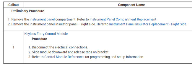

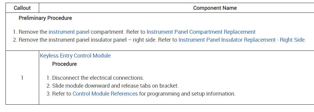

Sure, the keyless entry module is under the dash on the right side by the glove box, you might need to remove the glove box to get at it. Check out the images (below). Please let us know what happens.
