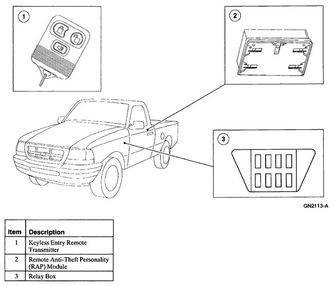

I purchased this truck about a year ago. I was told it had the ignition transponder system (found it) and also keyless. Where could I find the module location?

I believe you are referring to the RAP module. RAP stands for remote antitheft personality. Take a look through this information and let me know if this is what you are referring to.
_____________________________
2000 Ford Truck Ranger 2WD L4-153 2.5L SOHC VIN C SFI
System Description
Vehicle Accessories and Optional Equipment Antitheft and Alarm Systems Keyless Entry Description and Operation Components System Description
SYSTEM DESCRIPTION
pic 1
The electronic door lock control system consists of the Remote Anti-theft Personality (RAP) module, and two three-button transmitters. The RAP module controls the door locks through the use of external relays located in the relay box, on the LH side of the lower instrument panel. The RAP module also controls the anti-theft system.
