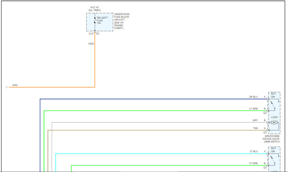

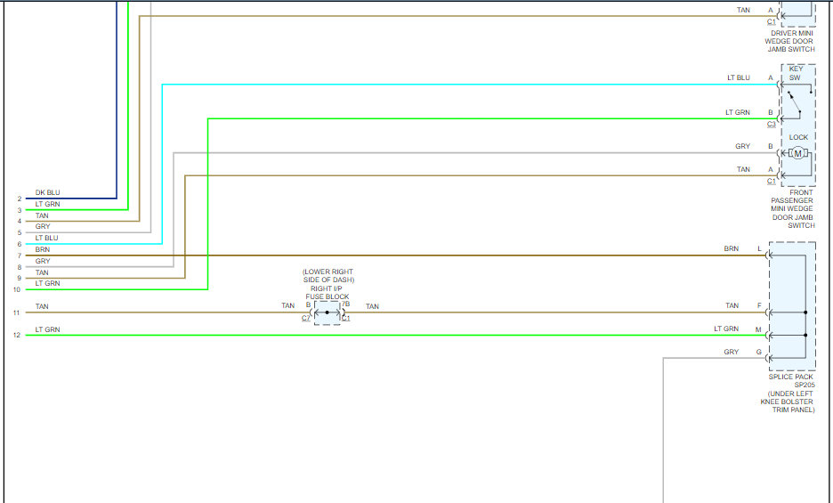

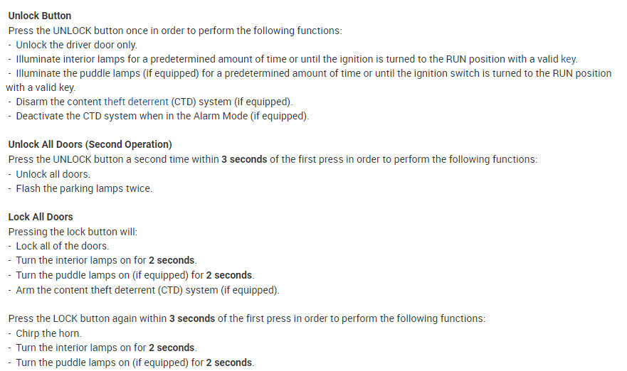

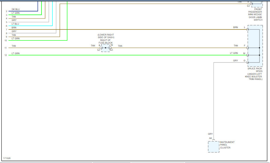

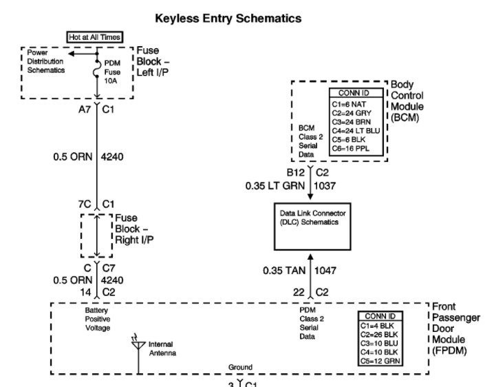

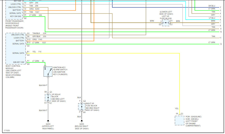

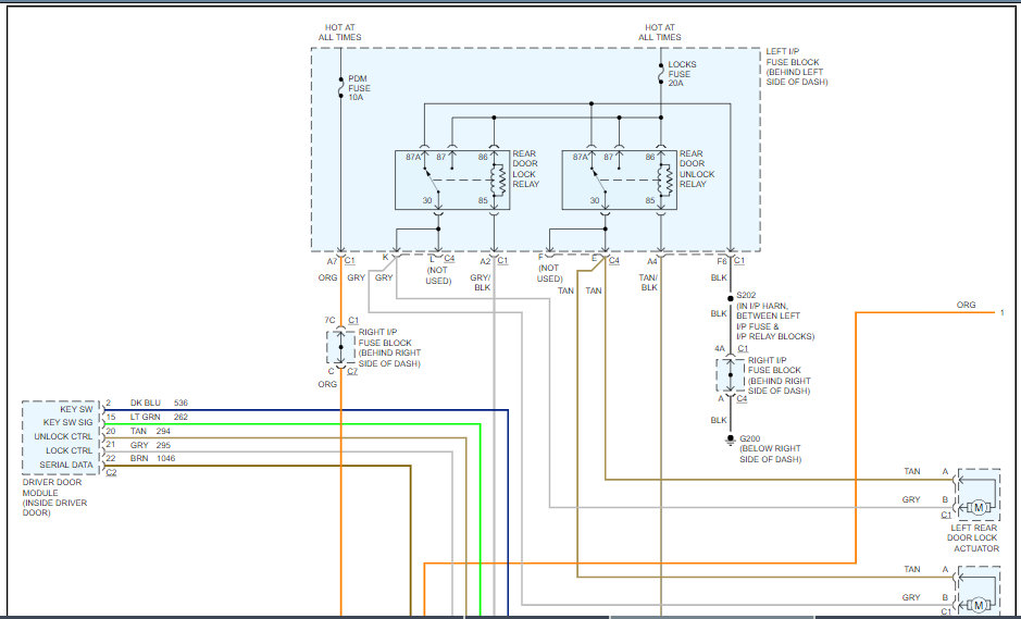

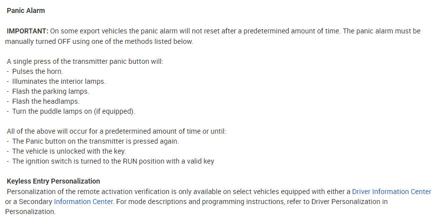

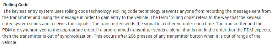

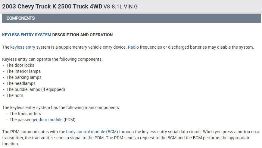

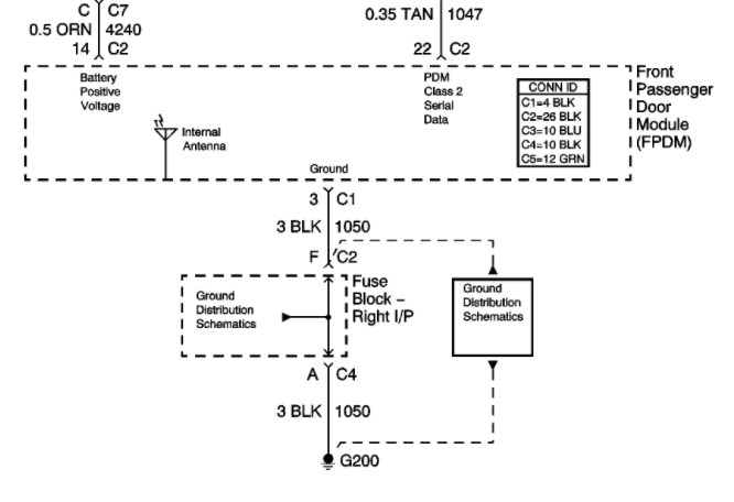

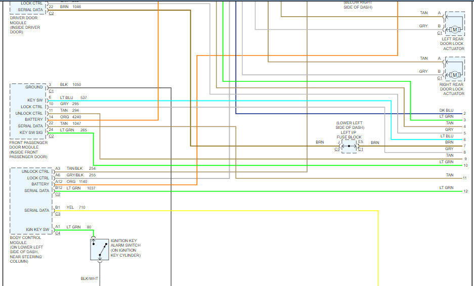

hello, I would like to have the wiring diagram of the keyless entry for the truck listed above lt and how the keyless entry works.
Sep 13, 2021 at 11:16 PM
DANNY L
Experienced Mechanic
5,648 POSTS
Hello, I'm Danny.
Here is the information you requested. This is a tutorial on how to test electrical wiring if needed:
I've attached below pictures showing the keyless system description and wiring diagram. I've cut the pages into three pieces so you can view larger. Hope this helps and thanks for using 2CarPros.
