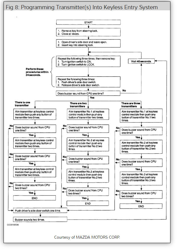

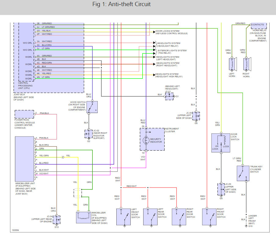

Hi, is it possible to program a remote control on this car? It will not go in to program mode. I found the relay which says Door Lock under the plastics behind the rear seats. On the aus/am model (protege) that is where the Key-less Unit is supposed to be. Does that mean that I do not have key-less entry option or do I have to look somewhere else?

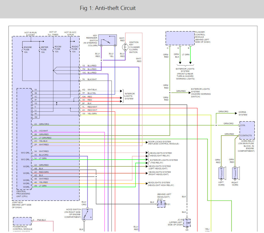

I have found the fob programming instructions and the security system wiring diagrams so you can see how the system works. Check the fuses as well.
