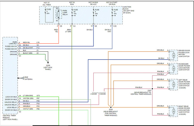

I have a auto starter system with keyless entry, I’m trying to install it on my vehicle but I can’t find the wires for the lock/unlock. mine has a factory keyless that doesn’t work anymore.
Apr 1, 2021 at 10:52 AM
  • 110,236 POSTS

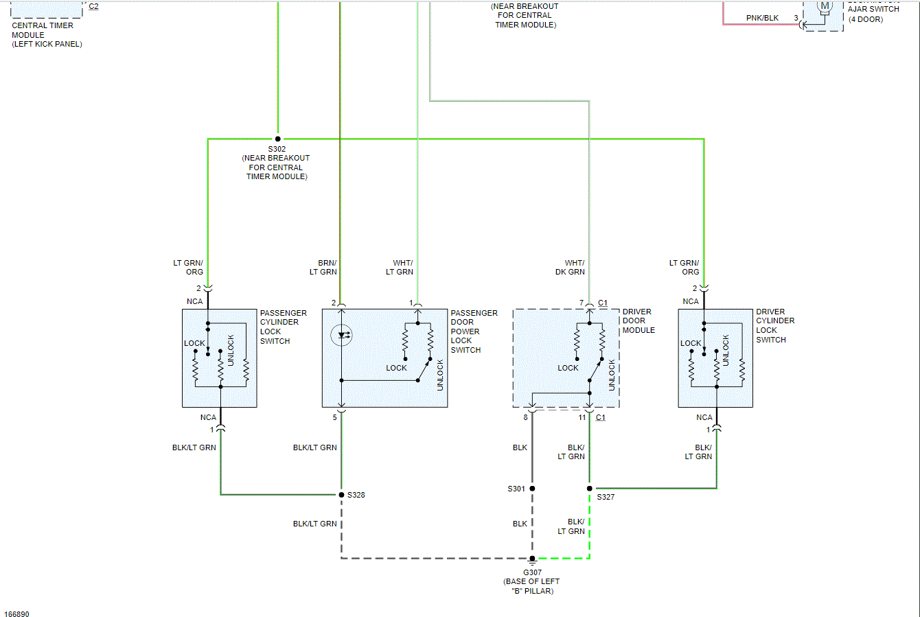

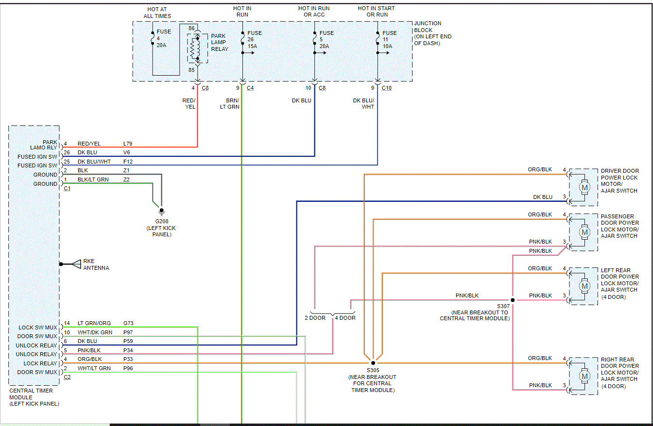

I'm not sure specifically which wires you are looking for. However, I did attach the entire wiring schematic for the lock system. I had to cut the pic in half to make it readable, but I did overlap them so you can follow them.
See pics below
