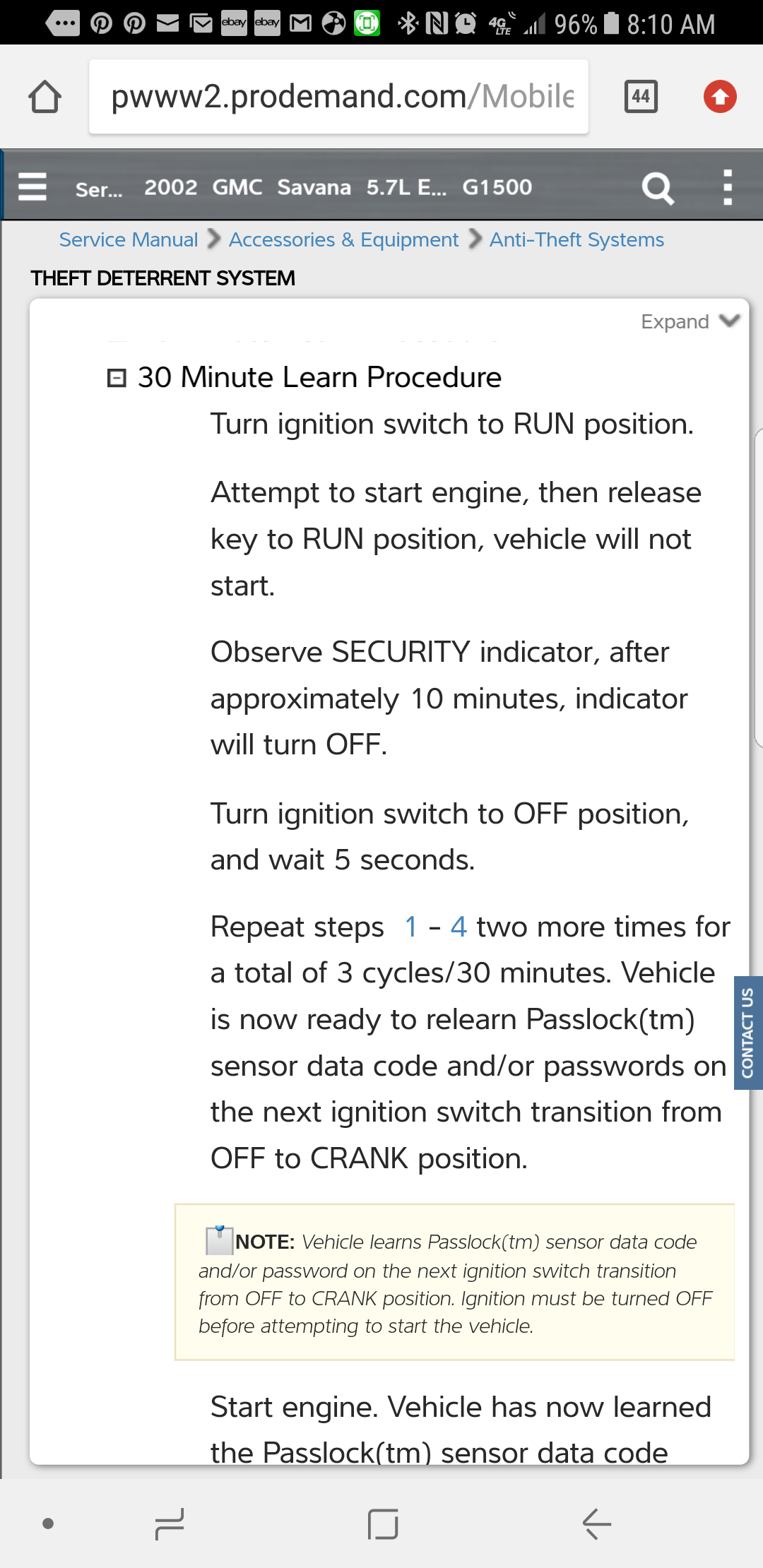

My GMC is not to be picked up in damp weather, but I want to continue, when it's dry or cold, all is well. Gasoline comes in, the pressure is there, the spark on the spark plugs is good. What can be?
Tuesday, January 30th, 2018 AT 4:59 AM
SATURNTECH9
  • 30,869 POSTS
So is the security light on solid or flashing with the key in the run position?
Tuesday, January 30th, 2018 AT 7:46 PM
DZMITRY
  • 11 POSTS
The securety light flashing
after a time turns off
Tuesday, January 30th, 2018 AT 11:17 PM
DZMITRY
  • 11 POSTS
The smoke from the pipe is there, but the engine does not work
Tuesday, January 30th, 2018 AT 11:24 PM
SATURNTECH9
  • 30,869 POSTS
Give what I posted posted a try and let me know what happens.

Thank you very much, the engine is running, the problem was in the passlock, there was one problem with the keyfob, you need a new one, how can I replace it?
Saturday, February 3rd, 2018 AT 8:18 AM
SATURNTECH9
  • 30,869 POSTS
How do you know the key fob is bad?Did you test the battery in the fob?Also they have testers that can see if the key fob is sending a signal out. You would need a high end professional scan tool to program the new key fob to car. You most likely have a problem in the pass lock system and that was a temporary solution. You would have to get the body control module scanned for codes. That would be a high end scan tool to do trhat as well. Then let me know the exact code numbers not code descriptions not all the professional scan tools will be able to program your key fob to the car.
