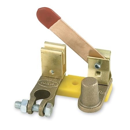

Until you get it right, one of these could really be your buddy.
Picture below is for a "Top Post" battery, you can also get one for a "Side Post" battery at an auto parts store.
I have a similar set up on my Jeep, Mine is there so that I can drain the battery to work on it. But mostly for in the event (it rarely happens) that my solenoid hangs up (and the starter cranks endlessly/ wires overheat/ etc.) I can quickly drain the battery with no tools needed.
