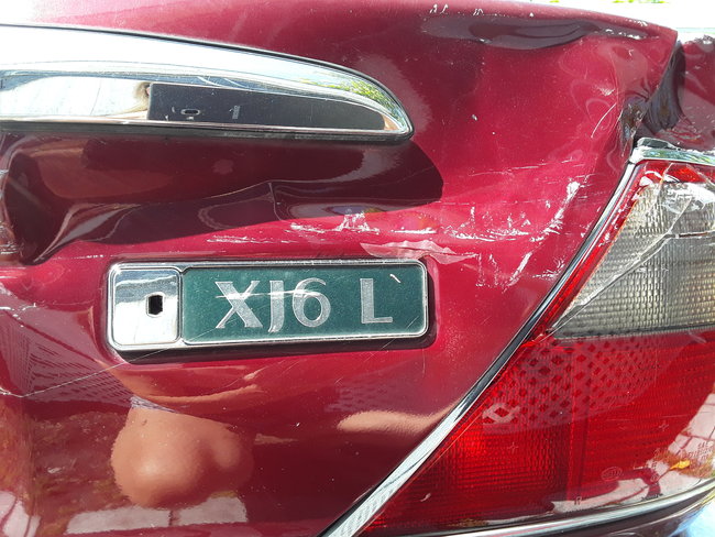

Trunk had minor accident backed into something and bent area of trunk where key fits into lock on it! Now key will not turn as it had before, and open trunk. My stuff is in there. I am trying to sell this car. Do not want a wreck trunk completely so I cannot close it. Please help!

I take it the dash button does not work either? From the look of the damage and your description I suspect that the only way that you are going to get the latch to release will be through the emergency release if it still operates at all. To get to that you need to remove the license plate, then using a long thin screwdriver you can reach in through the lower access hole to release the latch. Or if you cannot seem to get that to work you can take a one inch hole saw and cut out a hole behind the license plate to get to the latch assembly and pop it open. Then use a one inch hole plug to plug the hole. With the plate on it will not be visible. Once you get it to open you can look at the other releases to determine if they can be repaired, however with the damage you have there the lid would be replaced anyway.

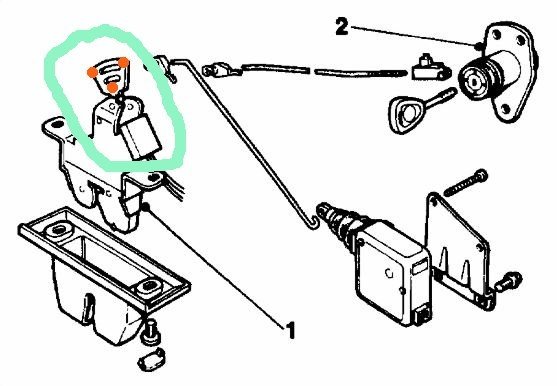

Cool, I will try that with another wire I have here. Kind of hard to see the latch assembly with that inner lining in the way though! Should I undo that from underneath the lid area? Better yet, is there a picture of what it looks like, so I can attach the hook to the right part of the latch, to pull it and have it open?

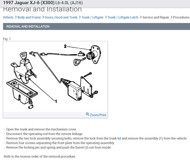

  • 55,628 POSTS
Steve will be back in a bit I will help you. I found this diagram that shows the trunk lid latch assembly. Check out the diagrams (below). Let us know what happens and please upload pictures or videos of the problem.

I would remove the cover and see if you can bend the lock linkage a bit to get it to work, or just connect a wire/string to the pivot at the latch end. Then just a tug would release the latch.

Hey there,
The linkage from the lock cylinder to lock, bent or blocked? I do not have a clue as to where that is located in the latch assembly diagram though! Sorry.
But I did take down that material that covered it, and now can still only see it from the side view. And that is with a flash light at night. By day, forget it! Have no idea where to attach wire/string to, since when I actually did release latch I was not looking at it, just fishing around blindly with the wire hanger.
So where is this lock linkage that I may need to bend located? Or the pivot at the latch end, for that matter?
Is there some other diagram that looks at it as it looks all together, not in segments, like the other one? That was confusing.

STEVE W.
  • 15,390 POSTS
If neither of the buttons work with a good battery then the linkage must be bent to the point it cannot move. To release it without either of those functional you would attach a wire or string to the circled part that is on the latch itself. With the trunk open you should be able to remove the two bolts that secure the cover then the latch will come down enough that you can see that lever to work on it.
