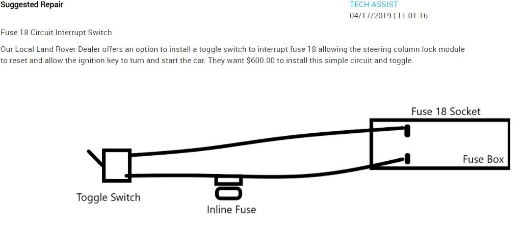

If there is any tension on the tire making the steering wheel have turn pressure on it the key wont turn, if it was shut off while in the middle of a turn. I've had to jack up the front of the car to release that pressure and it freed up no problem.
I found this as well it may help.
Unable to Turn Ignition Key.
Try to put pressure on wheel to release column lock .
Removed Fuse 18, wait 1 minute, put the key back in and if it will turn, then it's the electronic lock.
If it still won't turn then it is the ignition mechanical key lock and maybe the electronic column lock too.
Find fuse 18 in the back of the passenger's side glove box. Remove the fuse and wait 1 minute. Reinstall the fuse.
If a click could be heard after reinstalling the fuse and the ignition key will now turn. Then the steering column lock module has failed. The ignition key will not turn a second time unless the steering column lock module is reset again.
The Steering Column Lock Module is permanently built into the steering column and can not be serviced separately.

Below is what a dealer had to say about this also
Let me know how it worked out especially the front wheel turn pressure
