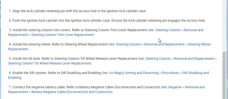

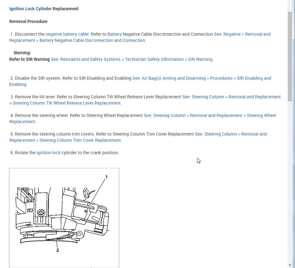

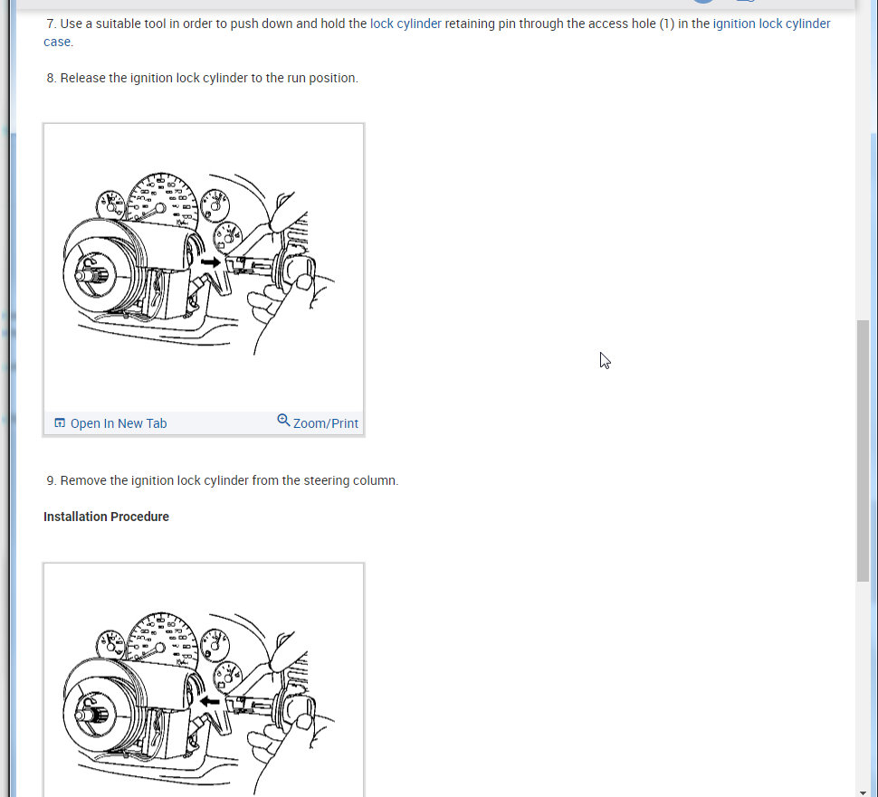

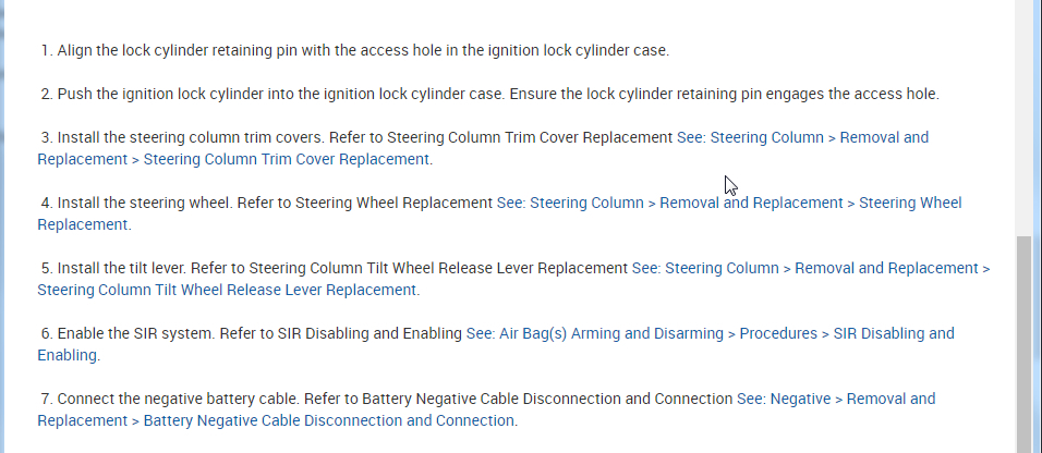

Below is the process on how to replace the cylinder if this does not work.
