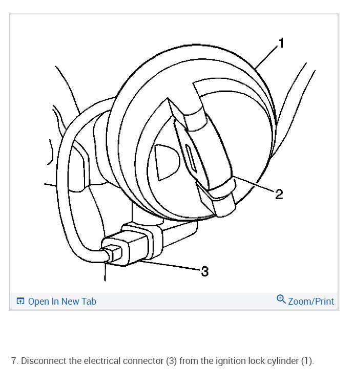

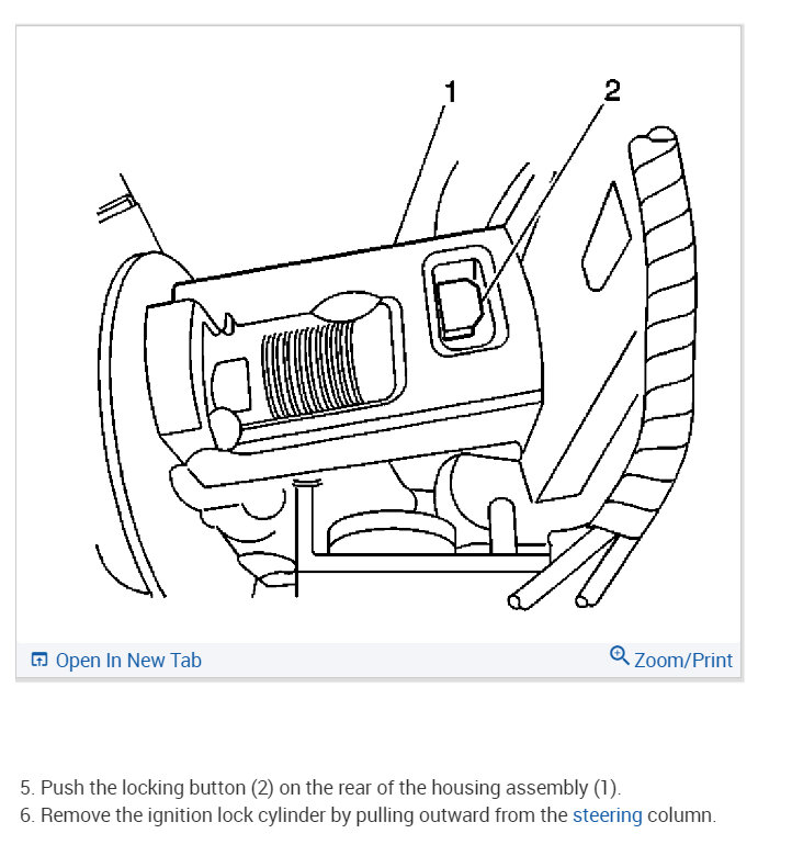

I drove the car three times with no problems, then went to start it and the key would not turn. I turned the wheel and the wheel locked and it still would not turn. Is this an ignition tumbler problem more than likely or is there something I can do to fix it at home? I've only had a car for 3 days driven it three times and I'm now stranded again in the middle of nowhere.
Jul 17, 2023 at 1:03 AM
  • 55,433 POSTS

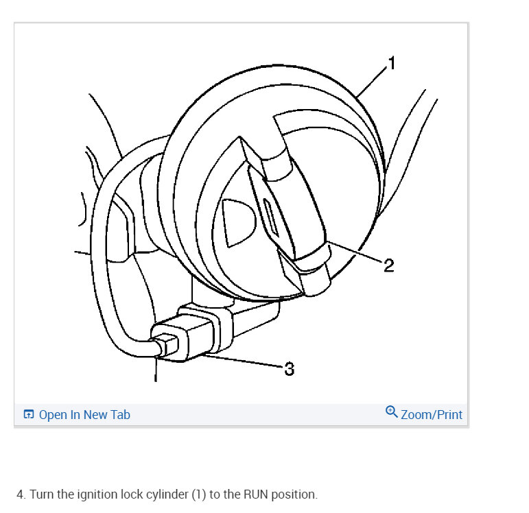

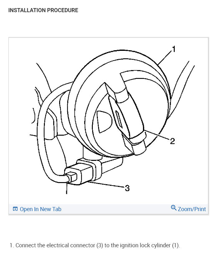

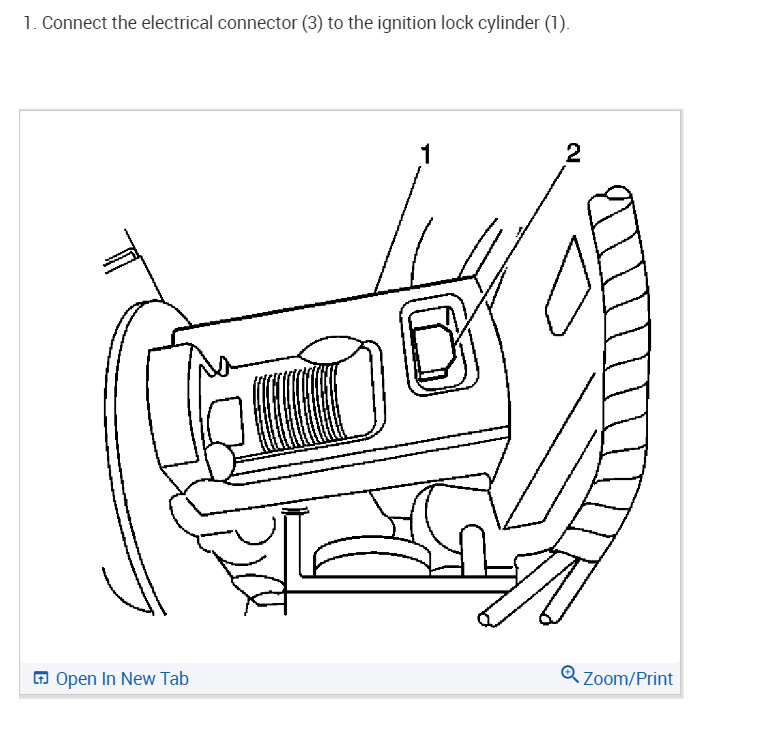

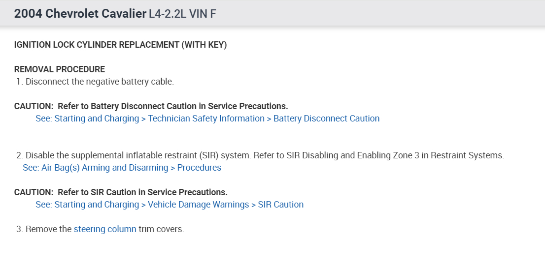

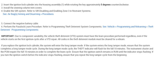

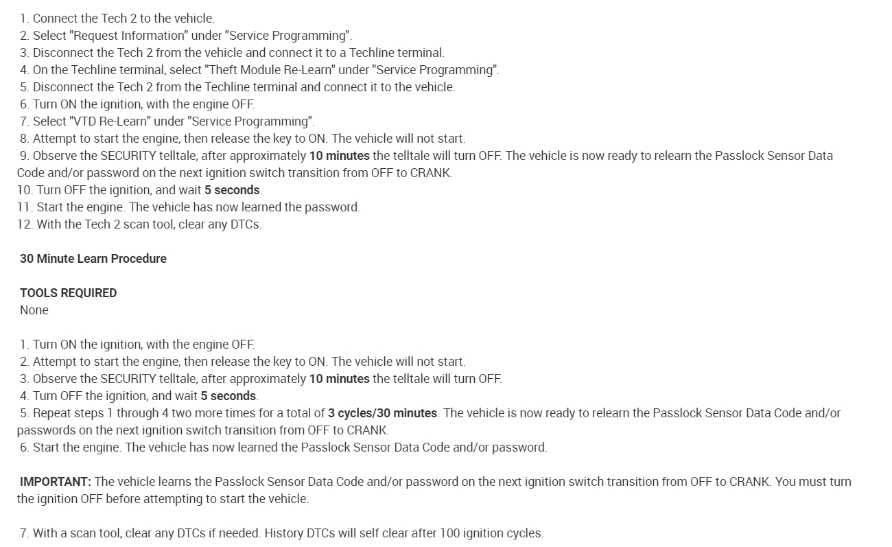

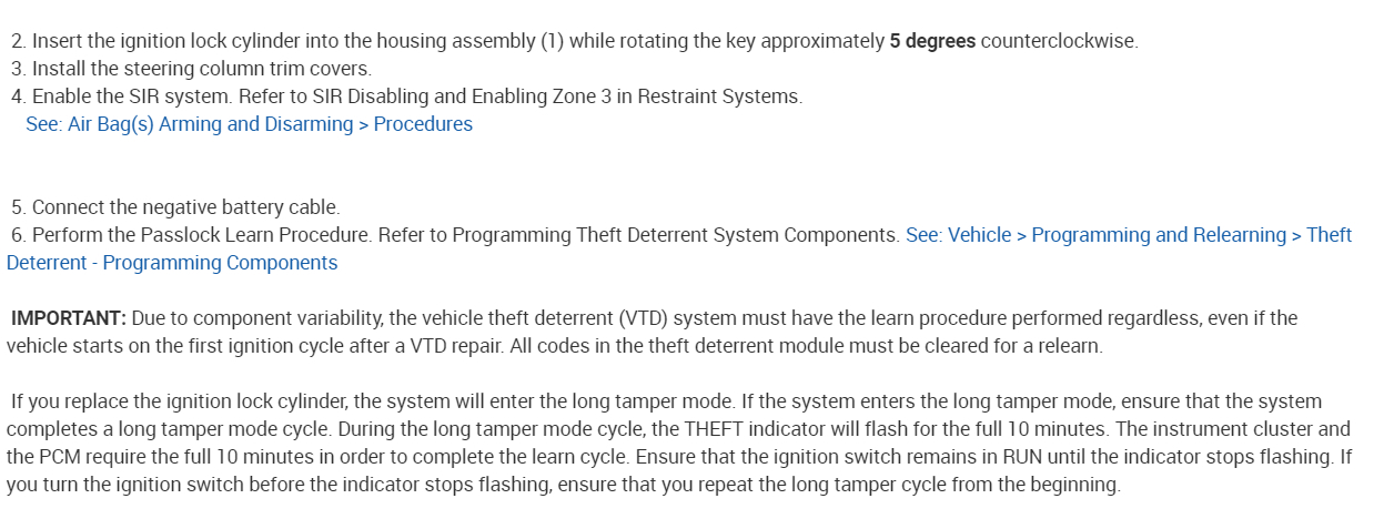

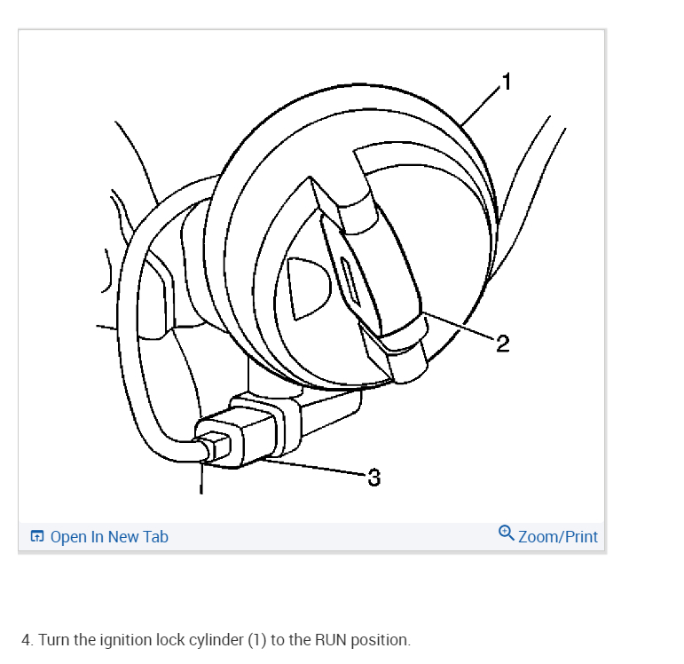

I am sorry to hear that, in most cases the ignition key lock will need to be replaced, here is a guide that may help with instructions for the repair, check the images below.
https://www.2carpros.com/articles/ignition-switch-wont-turn-stuck

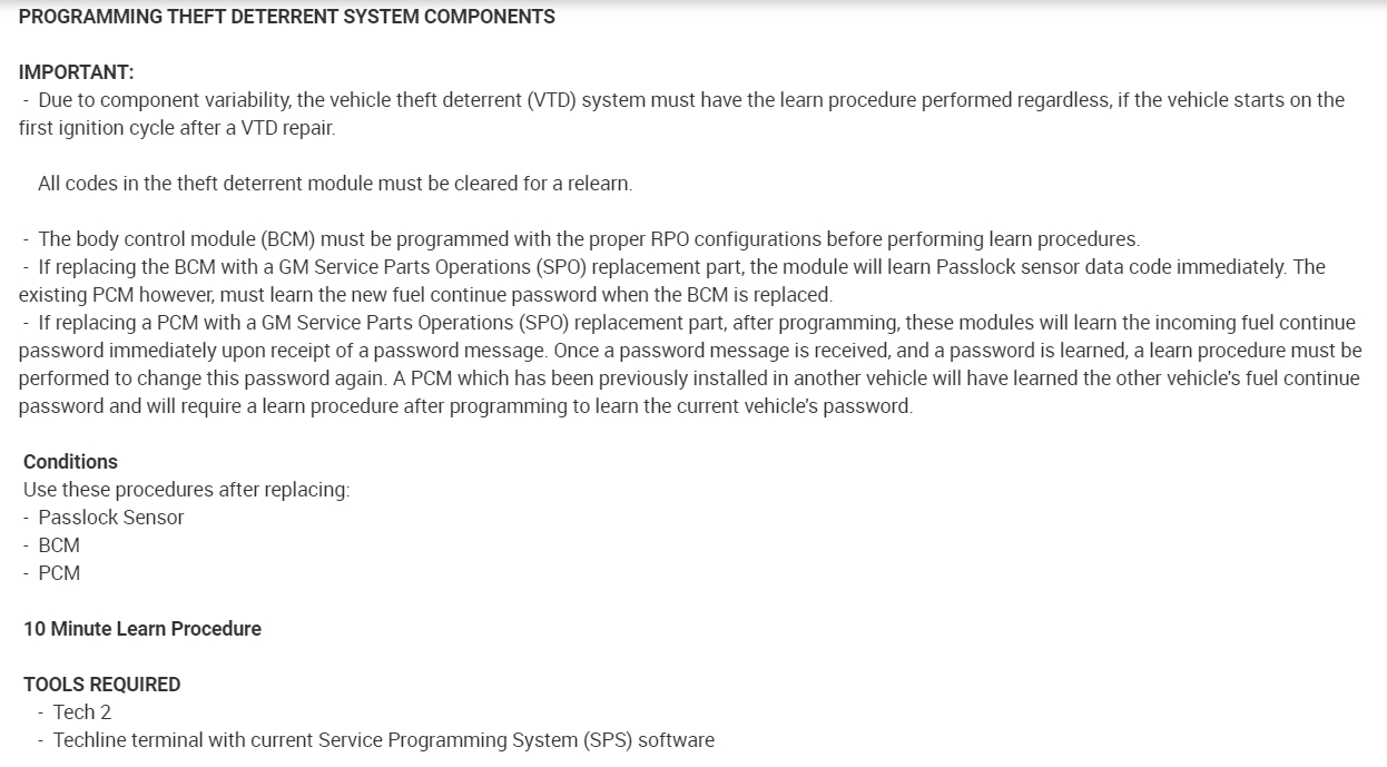

I would get the lock tumbler from the dealer so they can program it for you before installation. Check out the images (below). Please let us know if you need anything else to get the problem fixed.
