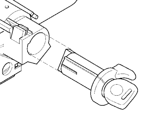

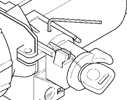

So it sounds like the ignition tumbler is worn out and needs replacement, you can try spraying WD40 inside the tumbler to see if that helps but if not here is how to replace the unit, I would try to get it from the dealer. Check out the images (below). Please upload an image or short videos in your response of the problem, so we can see what's going on.
