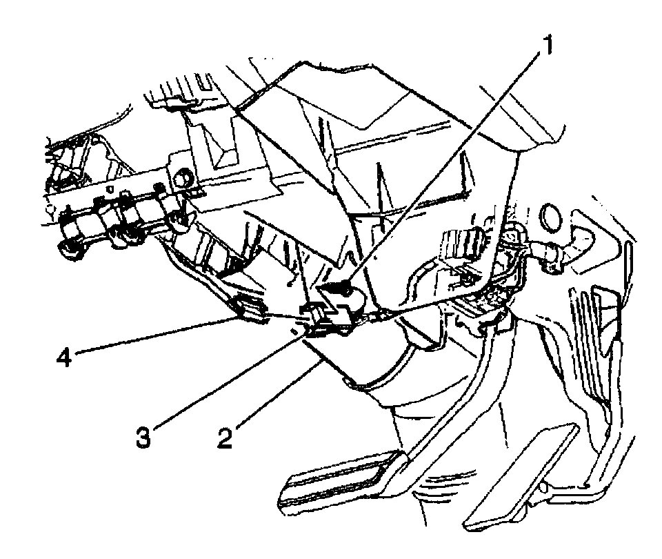

First, here are the directions to disable the airbag system:
DISABLING THE SIR SYSTEM
1. Turn the steering wheel so that the vehicle's wheels are pointing straight ahead.
2. Turn the ignition switch to the OFF position.
3. Remove the key from the ignition switch.
IMPORTANT: With the SIR fuse removed and the ignition switch in the ON position, the AIR BAG warning lamp illuminates. This is normal operation, and does not indicate an SIR system malfunction.

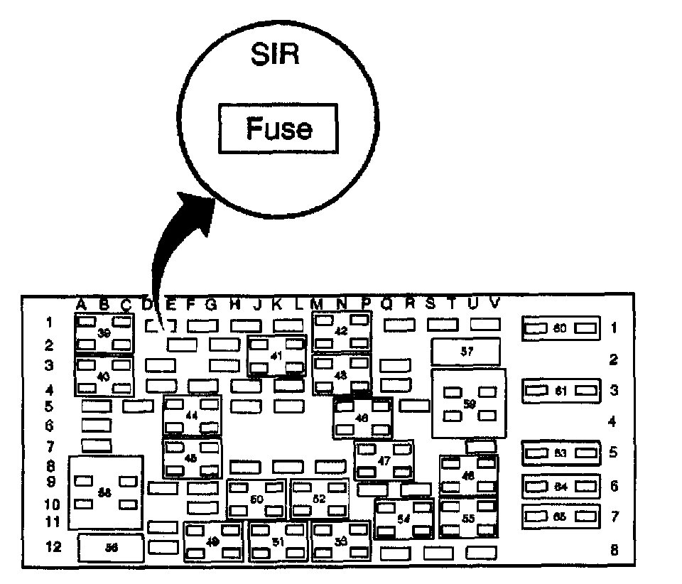

4. Remove the rear seat.
5. Remove the SIR fuse from the rear fuse block.
6. Remove the driver sound insulator.

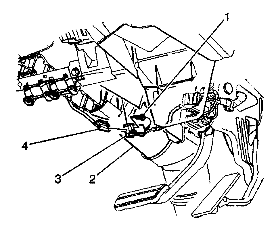

7. Remove the Connector Position Assurance (CPA) (1) from the driver yellow connector (3) located next to steering column (2).
8. Disconnect the driver frontal air bag yellow connector (4) from the vehicle harness yellow connector (3).

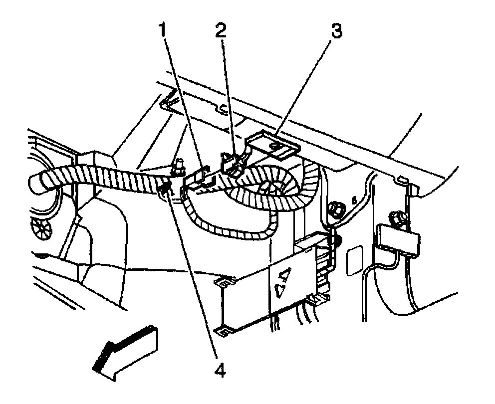

9. Remove the passenger sound insulator.
10. Remove the Connector Position Assurance (CPA) (4) from the passenger yellow connector (1) located above the passenger sound insulator.
11. Disconnect the passenger (IP) frontal air bag yellow connector (2) from the vehicle harness yellow connector (1).

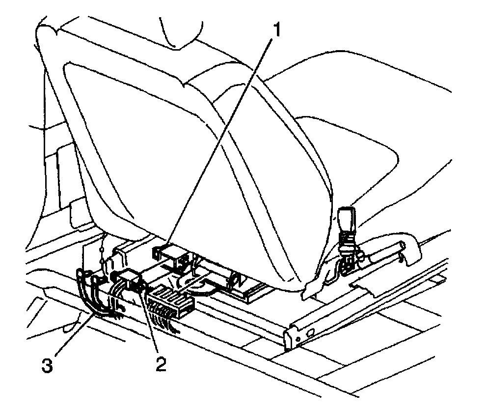

12. Remove both Connector Position Assurance (CPA) locks (3) from the driver side (seat) air bag and pretensioner yellow connector (1) located under the driver seat.
13. Disconnect the driver side air bag and pretensioner yellow connector (2) from the vehicle harness yellow connector (1).
14. Remove both Connector Position Assurance (CPA) locks (3) from the passenger side (seat) air bag and pretensioner yellow connector (1) located under the passenger seat.
15. Disconnect the passenger side air bag and pretensioner yellow connector (2) from the vehicle harness yellow connector (1).

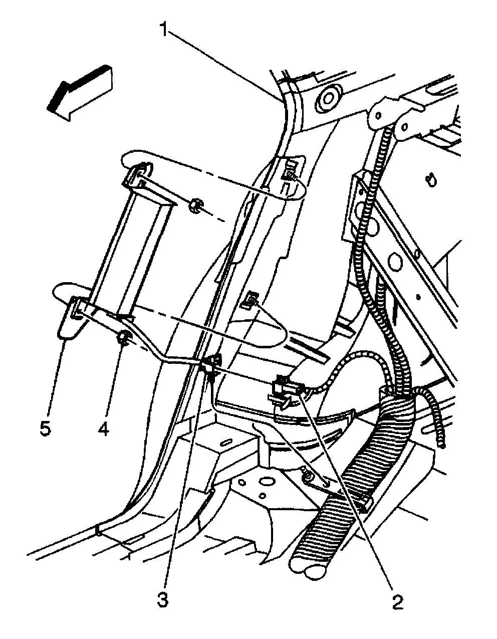

IMPORTANT: The above procedures will disable the SIR system. It vehicle is equipped with optional Rear Air Bags (AW9) the following steps must be done, to completely disable the SIR system.

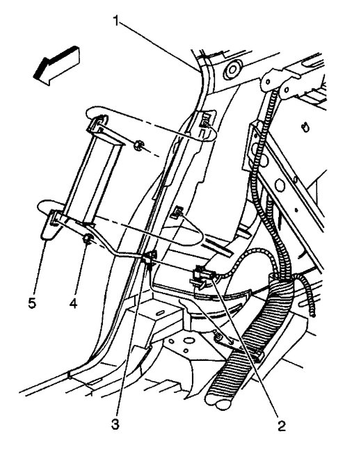

16. Remove the rear seat back.
17. Remove the Connector Position Assurance (CPA) from the passenger rear side air bag yellow connector (3).
18. Disconnect the passenger rear side air bag yellow connector (3) from the vehicle harness yellow connector (2).
19. Remove the Connector Position Assurance (CPA) from the driver rear side air bag yellow connector (3).
20. Disconnect the driver rear side air bag yellow connector (3) from the vehicle harness yellow connector (2).

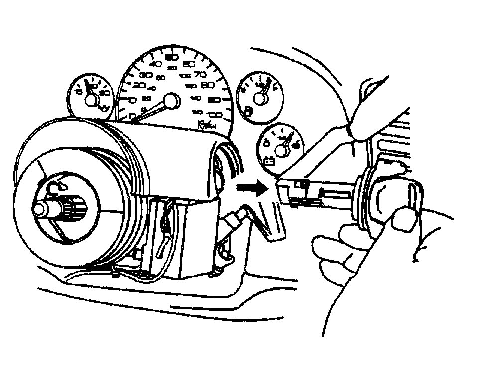

Cylinder replacement
IGNITION LOCK CYLINDER
Ignition Lock Cylinder Replacement - On Vehicle
Removal Procedure
1. Disable the SIR system. See: Air Bag(s) Arming and Disarming > Procedures

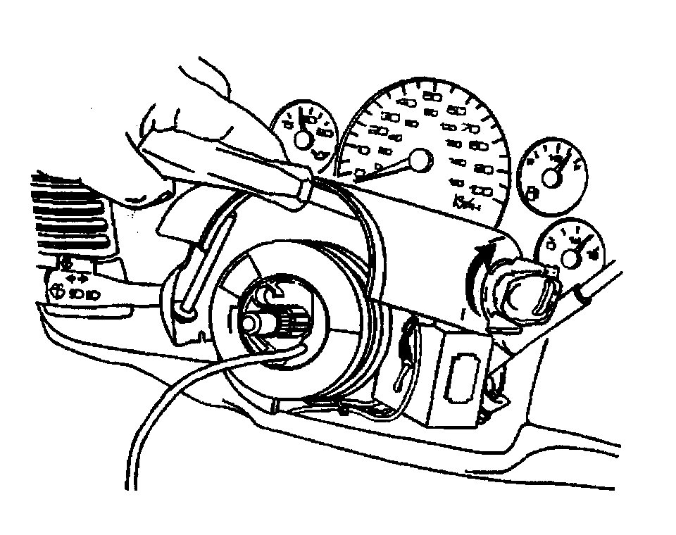

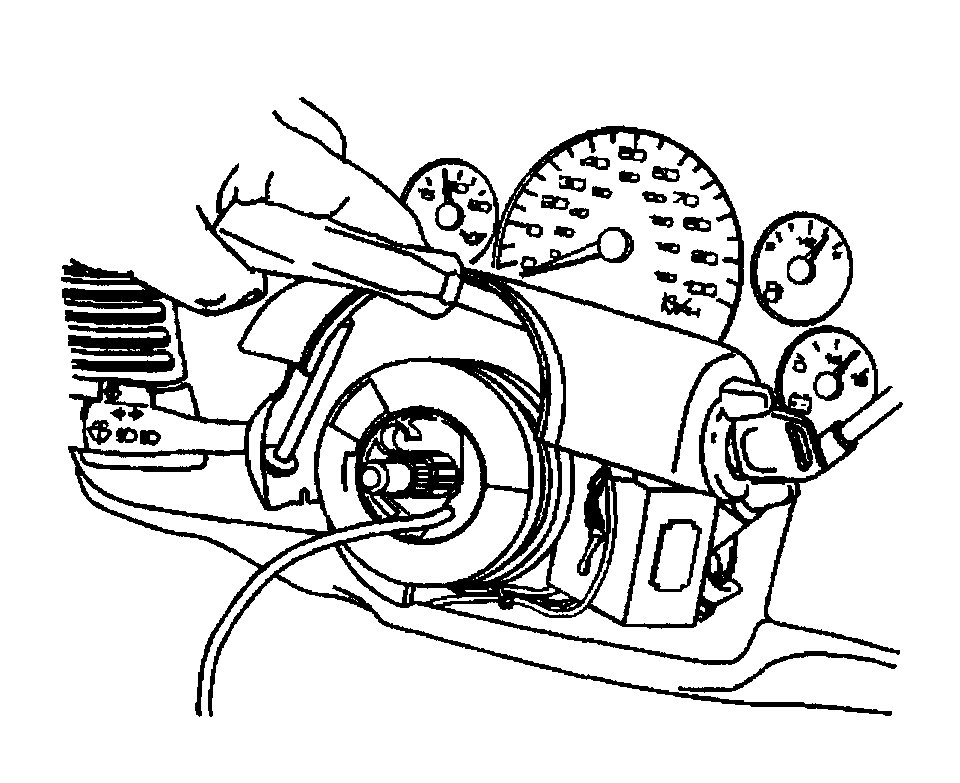

2. Position the steering wheel half way between the upper and lower tilt stops (if necessary).
3. Remove the steering wheel. Refer to Steering Wheel Replacement.
4. Roll back the shift lever seal from the upper and the lower shrouds.
5. Remove the tilt wheel lever (if necessary).
6. Remove the 2 TORX screws from the lower steering column shroud.
7. Remove the lower steering column shroud.
8. Remove the one TORX screw from the upper steering column shroud.
9. Lift the upper steering column shroud to gain access to the lock cylinder access hole.

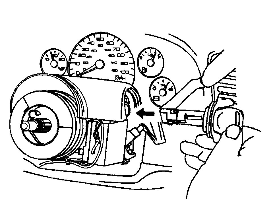

10. Turn the ignition lock cylinder to the START position.
Using the bent tip awl, push down on the ignition lock cylinder retaining pin.
11. Release the ignition lock cylinder to the RUN position.
12. Remove the ignition lock cylinder from the lock module assembly by pulling the ignition lock cylinder away from the steering column.

17. Rear fuse block is located under the rear seat.
18. Install the SIR fuse to the rear fuse block.
