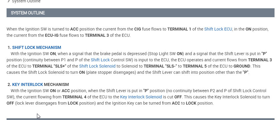

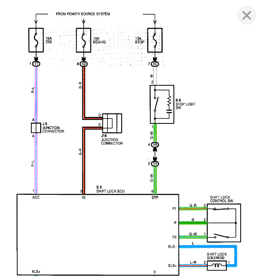

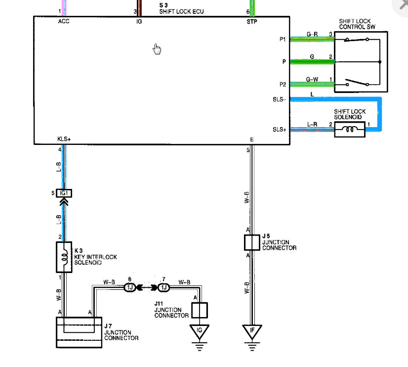

Okay, This is not exactly what I thought. Did you replace the key with the ignition switch?
If you have a new key, the I would check the CIG fuse. I have not seen this cause the key to not turn but I am wondering if we have an interlock issue.
You said you can manually get it out of Park? Does the vehicle start in Neutral?
