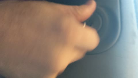

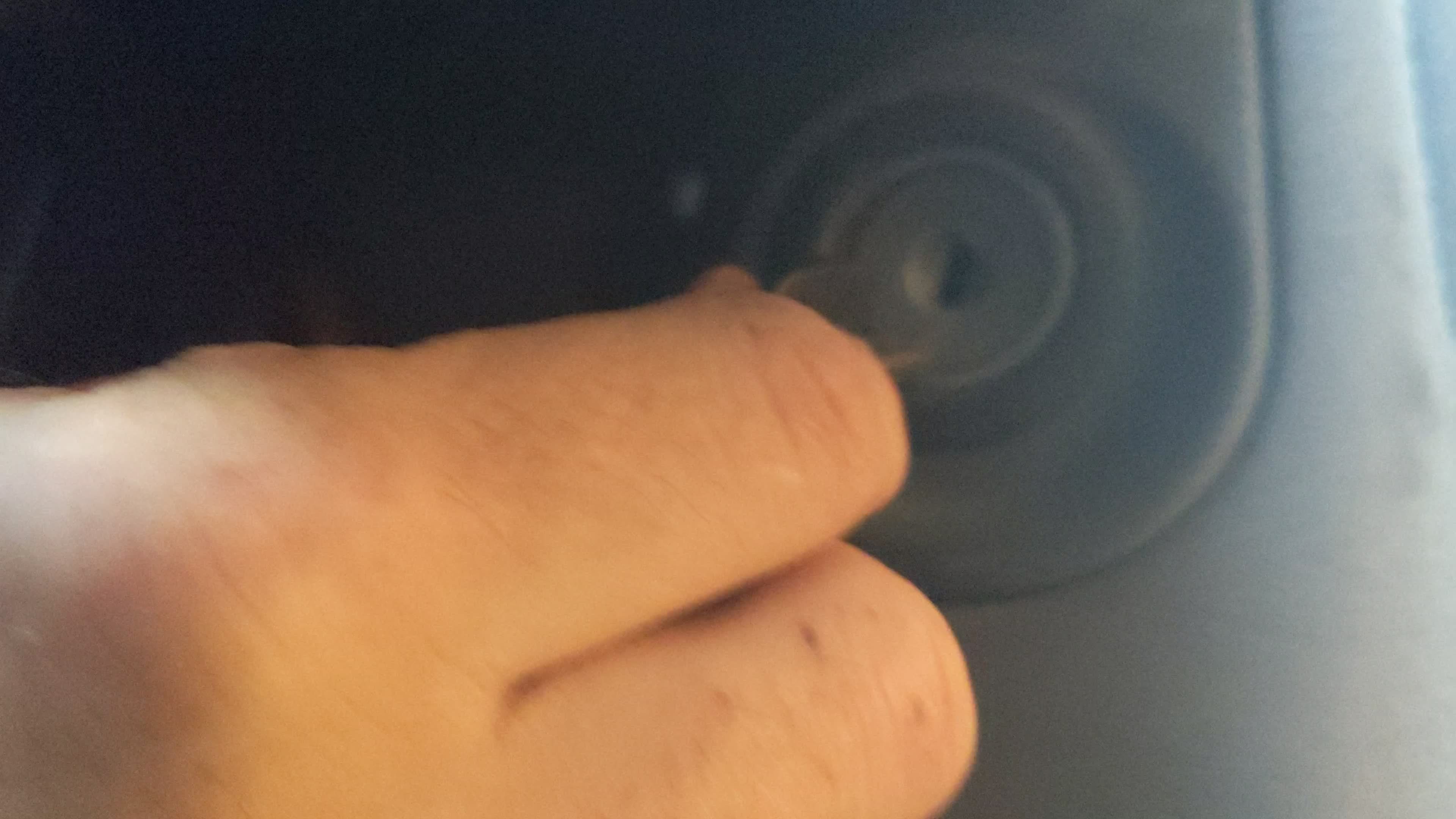

Okay. Can you get a quick video of what the key is doing just so I can make sure we are on the same page? I think I know what the issue could be but a video will confirm what I am understanding the issue is. Also, the quieter the better so that I can listen to what is happening as well. Thanks
Sep 15, 2019 at 11:01 AM
ZACK CALLENDER
Sorry for delayed reply.
Sep 21, 2019 at 5:21 AM

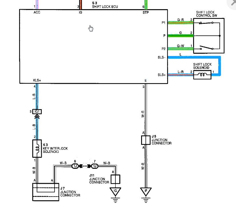

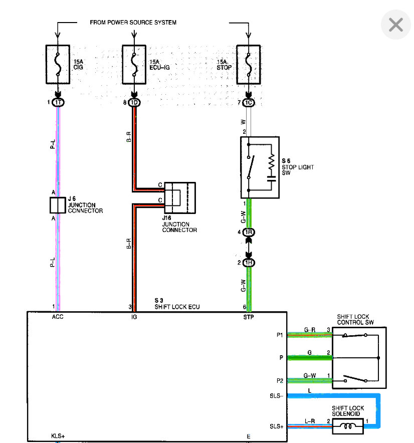

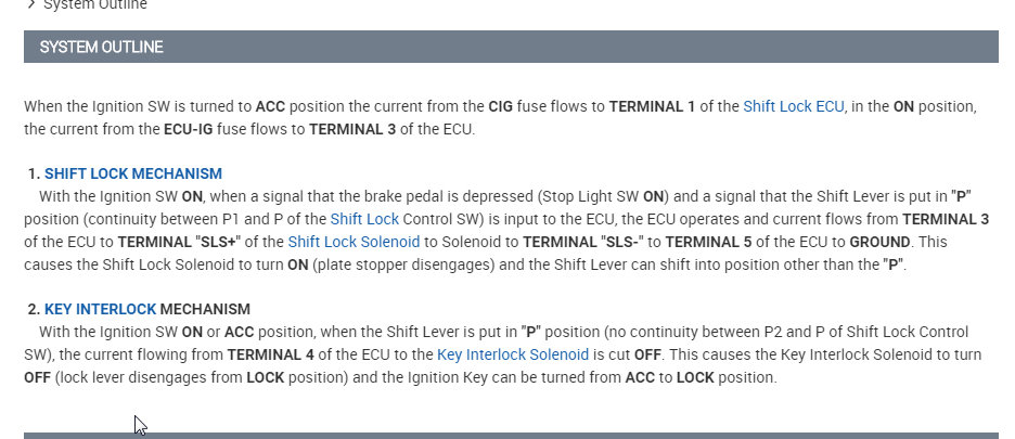

Okay, This is not exactly what I thought. Did you replace the key with the ignition switch?
If you have a new key, the I would check the CIG fuse. I have not seen this cause the key to not turn but I am wondering if we have an interlock issue.
You said you can manually get it out of Park? Does the vehicle start in Neutral?
