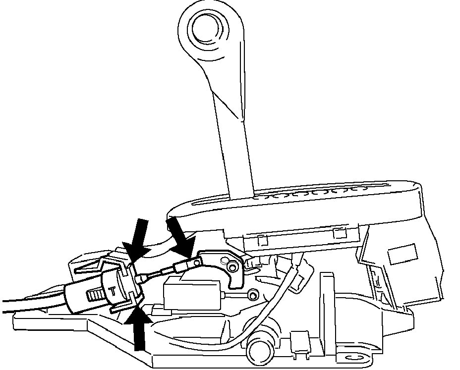

At the ignition switch where the cable goes from shifter to ignition switch that allows the switch to turn to lock position. my screw is missing. I have looked for diagrams and even a part number with no luck. do you know the size and length of screw or where I can find one? thanks for the help.

Is the shift lever returning fully to the park position? When you turn the key off as far as you can, does the shifter lock in park? I am questioning of the shift lock cable is out of adjustment or damaged. Take a look through these directions for removal and replacement of the cable. Check to see if anything is loose or damaged.
________________________________________
The attached pictures correlate with these directions.
SHIFT LOCK CABLE
Shift Lock Cable
1. Set ignition key in "LOCK" position and selector lever in "P" position.
2. Remove knee pads, cluster upper cover, center cluster assembly, rear console, and front console.
Picture 1

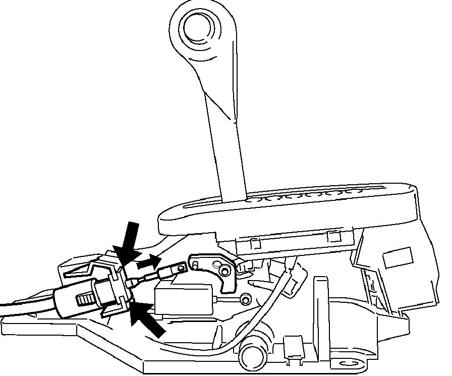

3. Disconnect inner cable from selector lever assembly then push claw and disconnect cable assembly.
Picture 2
4. Disconnect lock adjust.

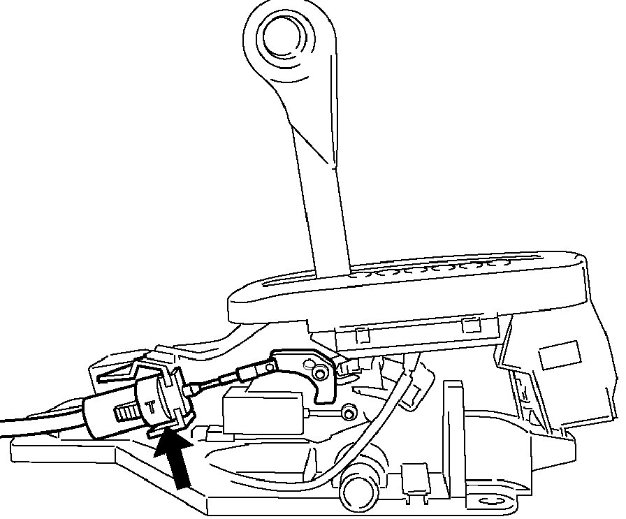

5. Remove instrument panel lower cover and steering column cover.
Picture 3
6. Remove spring pin and disconnect inner cable.
^ Disconnect outer cable from bracket.

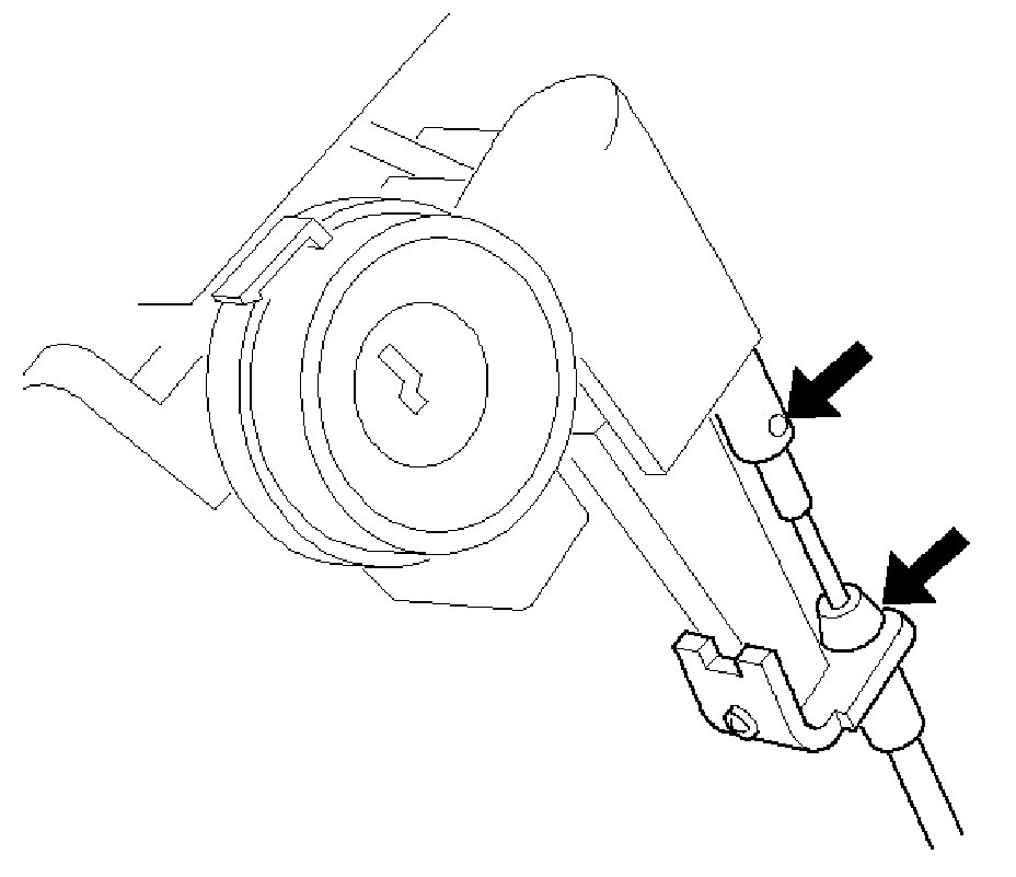

2. Connect outer cable to bracket near steering lock.
^ Connect inner cable to steering lock and install spring pin.
3. Install steering column cover and instrument lower cover.
Picture 4

If you are able to turn the key (other than into the lock position) it doesn't sound like an issue with the tumbler itself. I suspect the cable has been damaged and not allowing the key to turn fully to the lock position.
