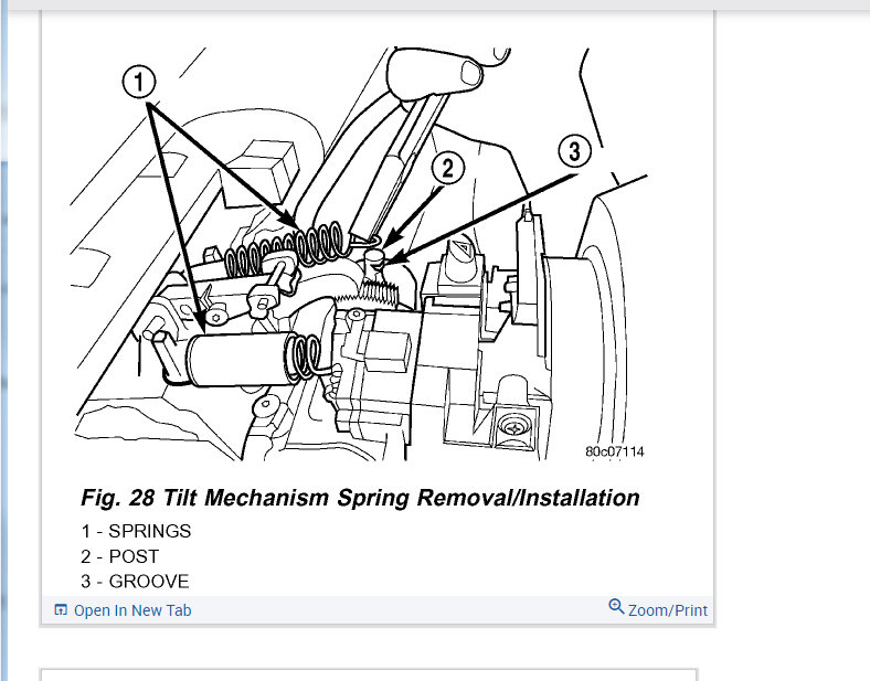

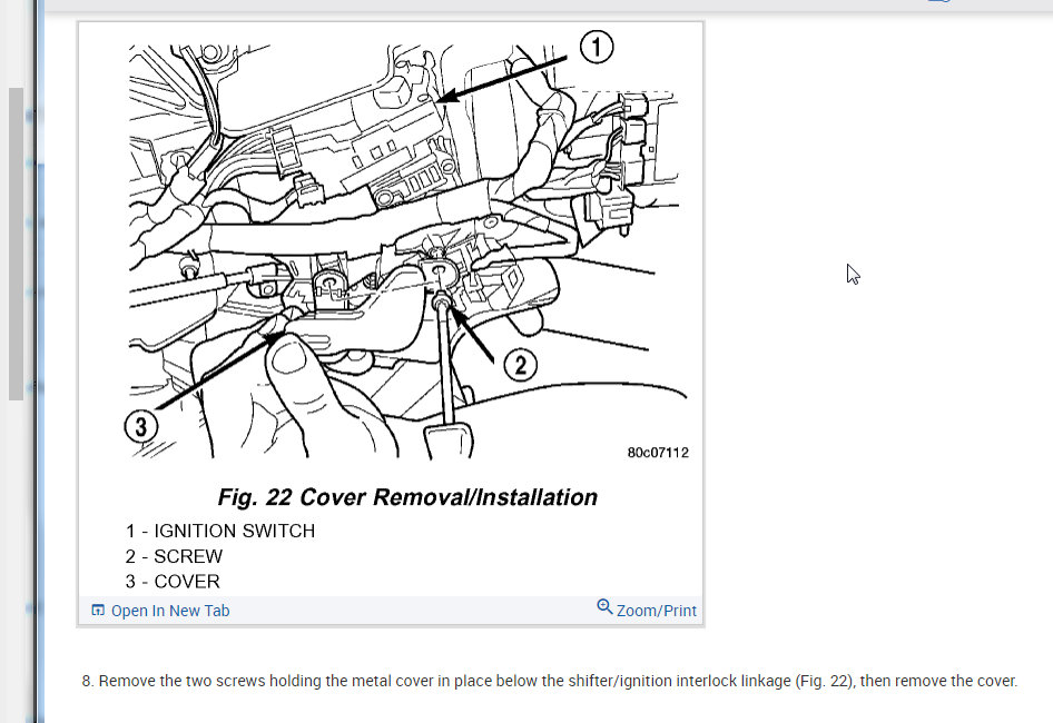

Worked find this morning this afternoon I went out and tried to start the car and the key won't turn at all. Cannot start car. Tried the rubber mallette, tried rocking it, turning steering wheel, nothing! I have to work tonight. Help!
Feb 19, 2021 at 6:06 AM
This could be a couple things but if you have tried rocking the steering wheel and turn the key at the same time and that did not work, try using a little WD 40 in the cylinder and see if that will work it free.
Here is a guide that will help with this issue and give some more ideas:
https://www.2carpros.com/articles/ignition-switch-wont-turn-stuck
Once we try these two things, we may need to try another key. Hopefully you have a spare. If none of this works then I suspect the ignition solenoid has failed. I attached the info below on this but hopefully one of the items above or in the link will help.
Let us know what happens.
