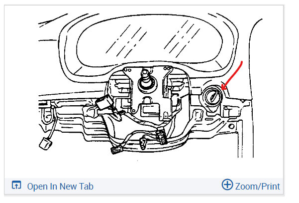

I sprayed some key lube stuff in my ignition now it won't turn at all tried moving the steering wheel back and forth still it didn't turn.
Does anyone have any ideas? I would appreciate it.
Apr 25, 2024 at 3:10 PM
  • 55,711 POSTS
It sounds like the lock tumbler has fallen apart internally which is common, I would try moving the shifter while working the lock, also I have seen people tap the key with a hammer.
Please check out this guide:
https://www.2carpros.com/articles/ignition-switch-wont-turn-stuck
If this doesn't work, you can call a mobile locksmith or get a new lock and replace it yourself. Check out the images (below). Please upload pictures or videos in your response to the problem so we can see what's going on.

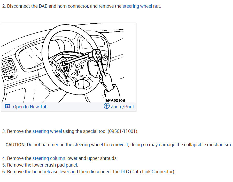

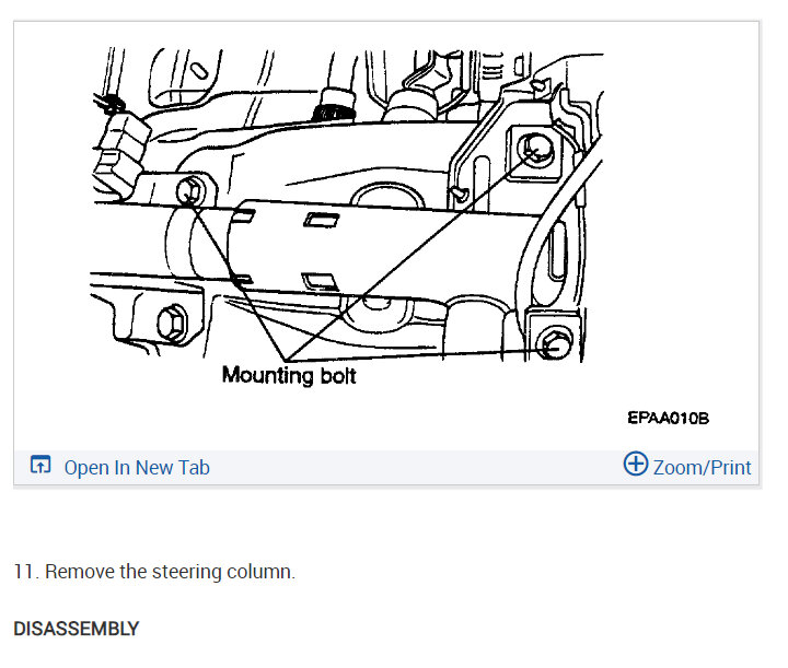

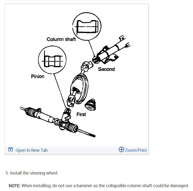

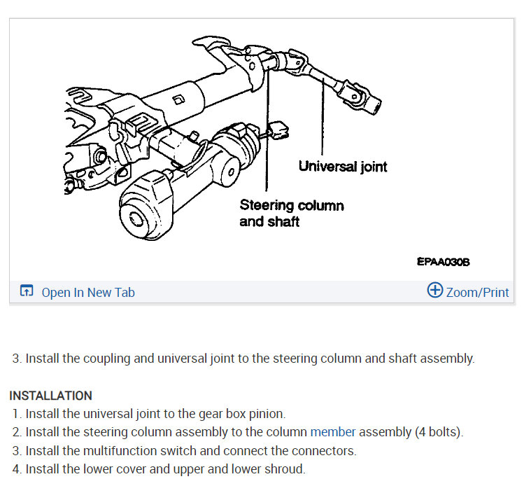

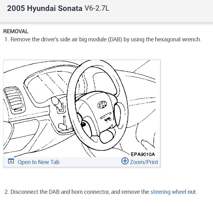

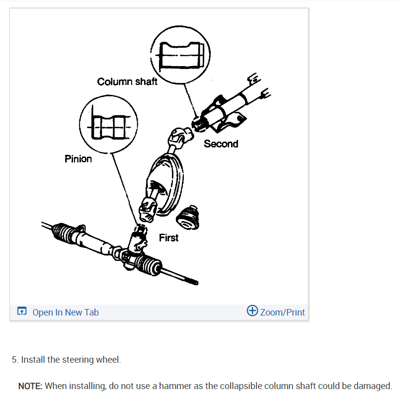

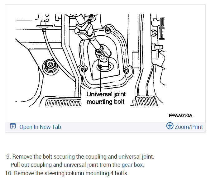

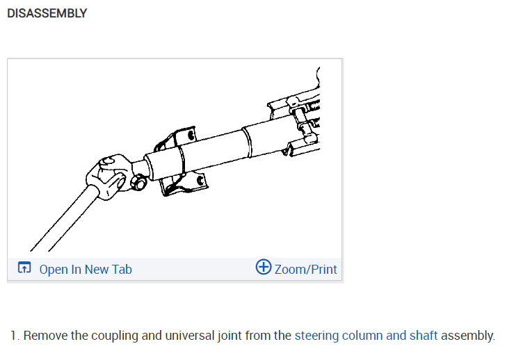

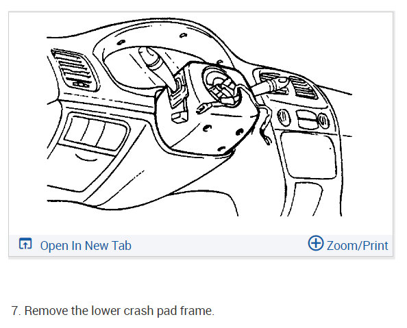

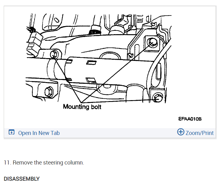

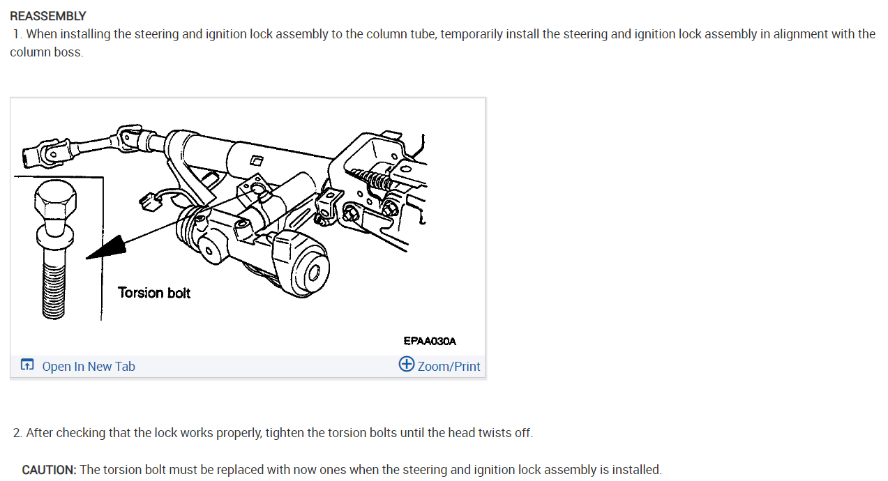

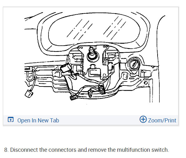

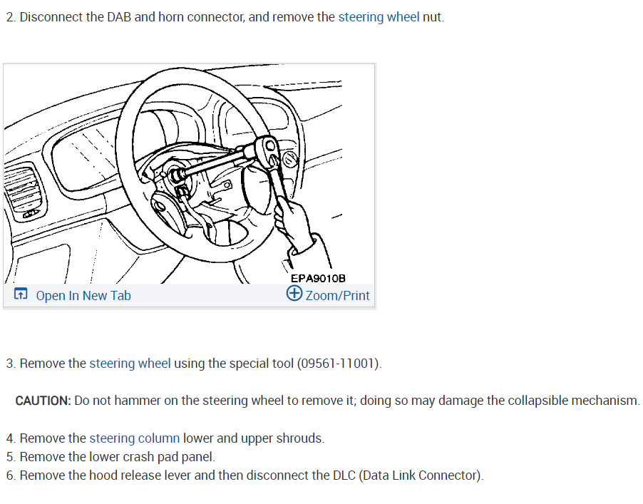

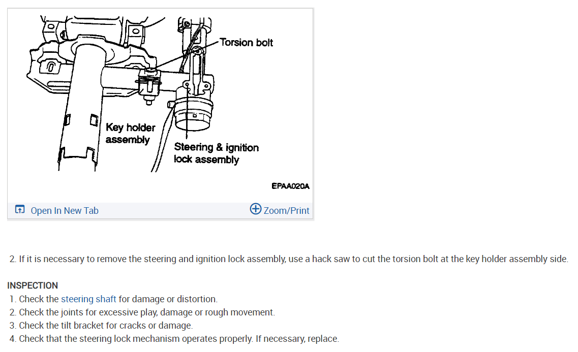

I am going to replace my whole ignition assembly. Can someone tell me will I be able to do this with the steering column in and is there anything else I should know before I do this, I would appreciate it.
Thank you
May 20, 2024 at 6:00 AM (Merged)
  • 55,711 POSTS
Apparently you need to remove the steering column to replace the key lock, here is how in the images below. Check out the images (below). Please let us know what happens.
