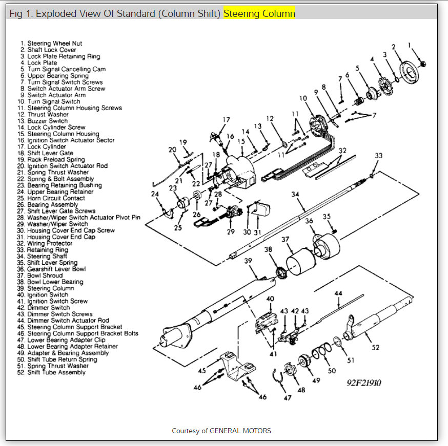

Key will not turn in ignition.

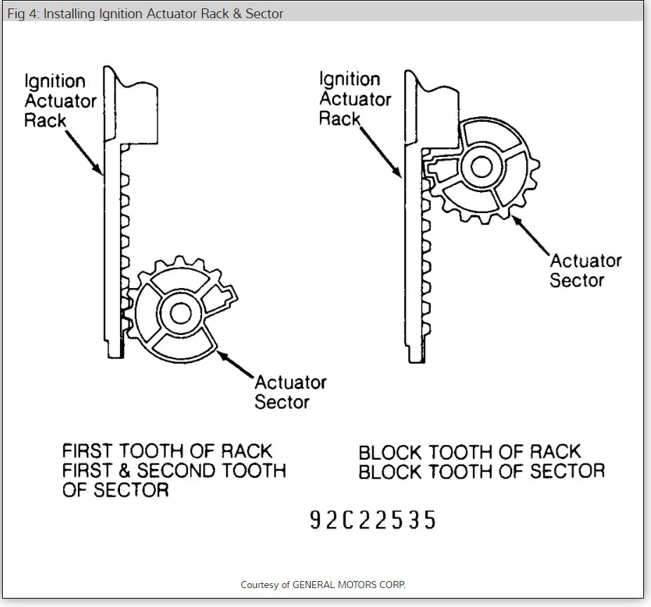

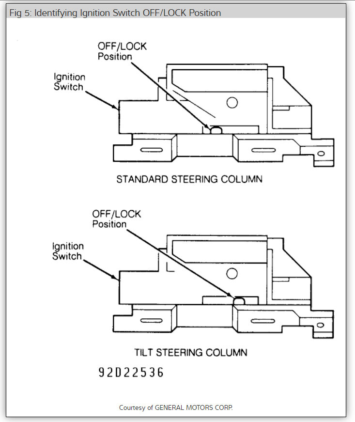

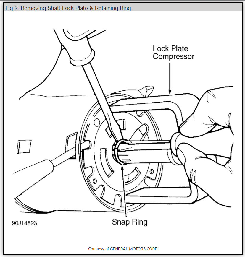

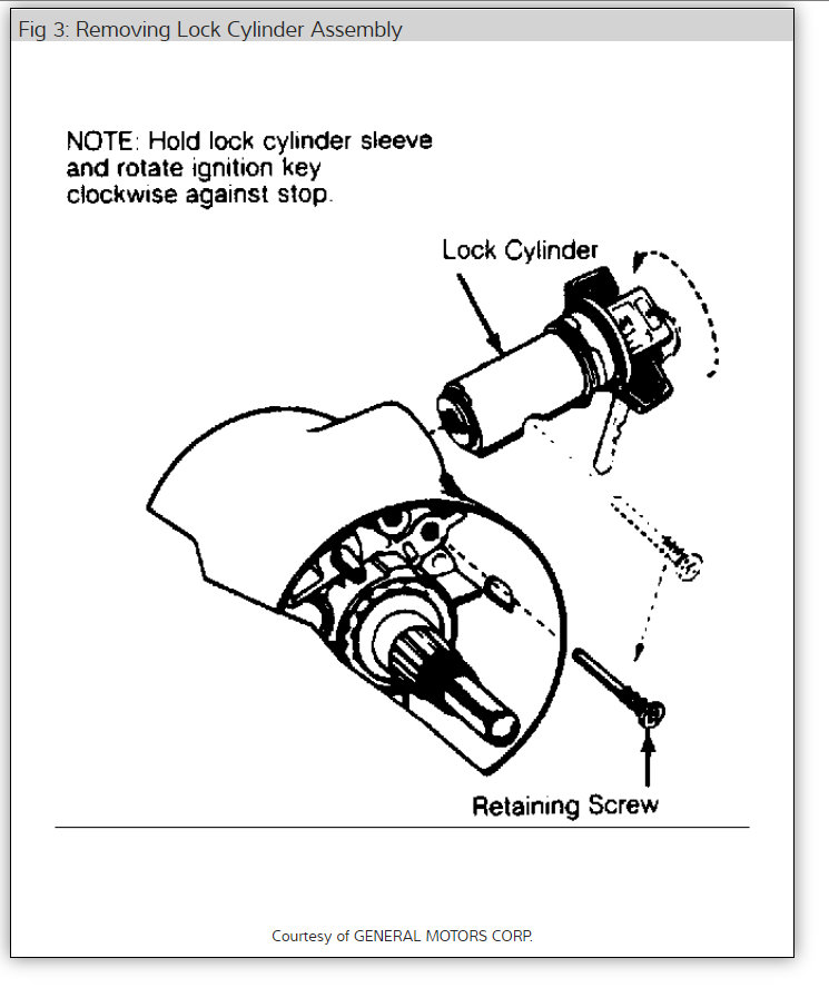

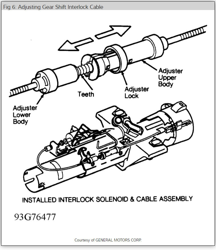

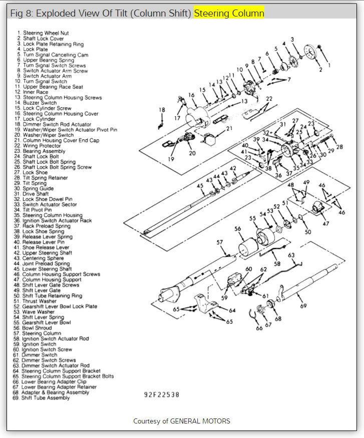

It sounds like the tumbler has gone out which is common. Here is a guide that will show you how to change the unit out (below).
