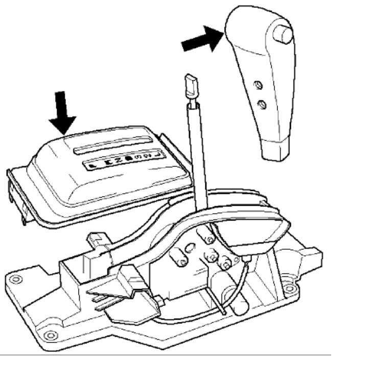

Ignition switch does not sense car is in park so key will not go to lock position so it can be removed.
May 13, 2017 at 9:50 AM
  • 55,433 POSTS

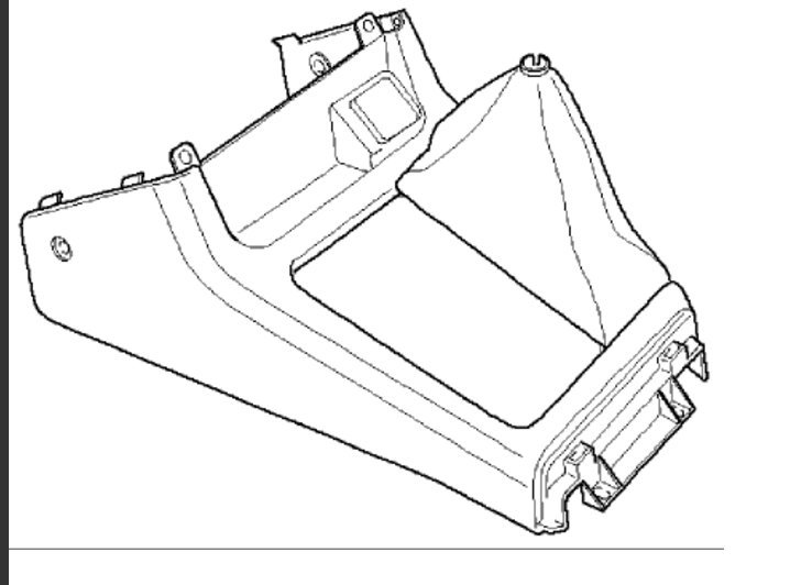

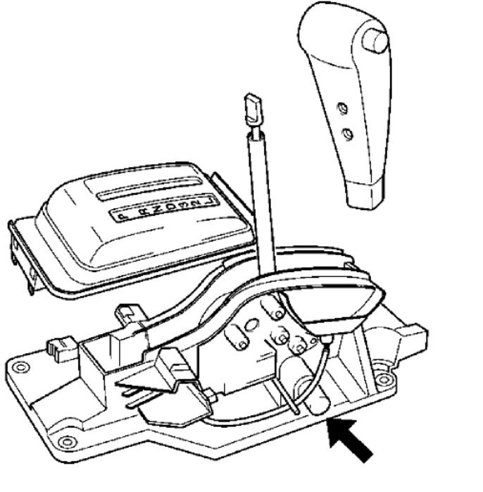

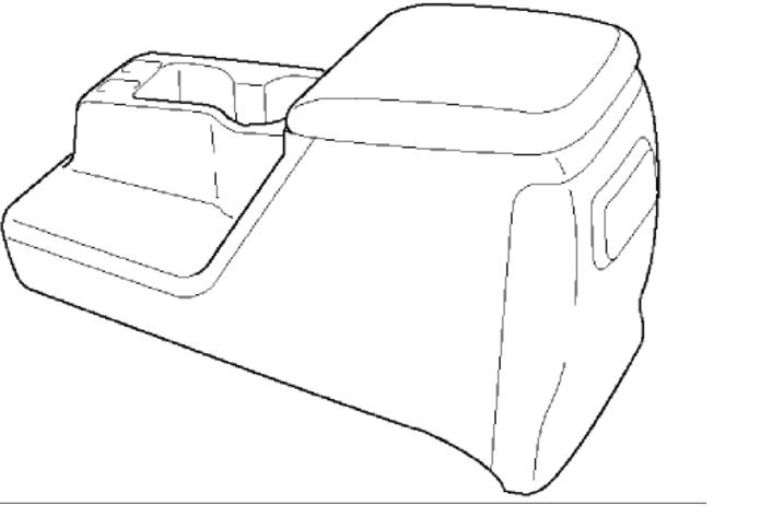

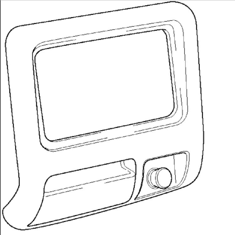

This is most likely a problem with the shift-lock cable that goes from the shifter to the ignition switch. If the cable wears out it will not push the lock into place. Remove the shift cover to check its operation. Here is some diagram to help you get the problem fixed.
May 16, 2017 at 6:06 AM
BOBBYDAVISM
Thank you. The brace for the cable going into the ignition switch had lost the screw holding the cable secure. Screwed back on and now the cable is working like designed and my problem is fixed.
Again thank you!!!

I have the same problem in mine. Under the steering column there should be a black cable that connects to the ignition. Jiggle the cable (I pull it towards me) while trying to turn the key all the way back.
I haven't really had a look at mine, but it sounds and feels like the bolt is loose. Nothing serious.
Good luck! (If you do it enough, you can release it with your feet as well!)
