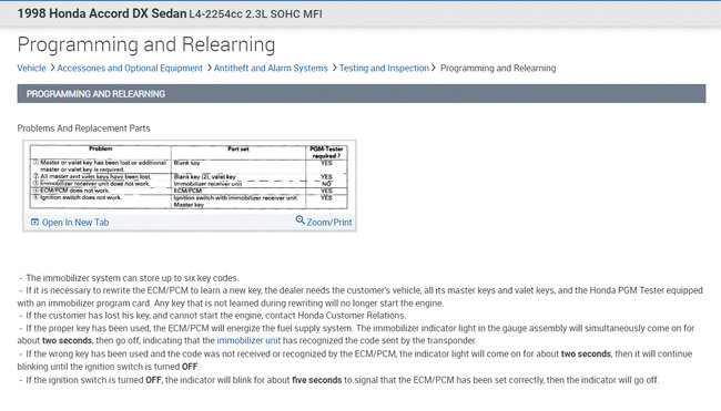

I just finished working on my car, took my battery out. I put the battery back in. Now it doesn't register my key. The only key I have is my valet key. Is there any way to reprogram the valet key without a key fob?
Apr 11, 2022 at 1:40 AM
  • 110,240 POSTS
It shouldn't have lost memory, but since it is a valet key, anything is possible.
As far as reprogramming is concerned, this requires a scan tool that can communicate with the PCM and has an immobilizer program card. That is a dealer item. However, you may find a locksmith that can do it as well.
Also, I'm not sure you can rewrite just a valet key. Whatever is registered when the rewrite is done is the only thing that will work. You may want to consider a spare key/fob.

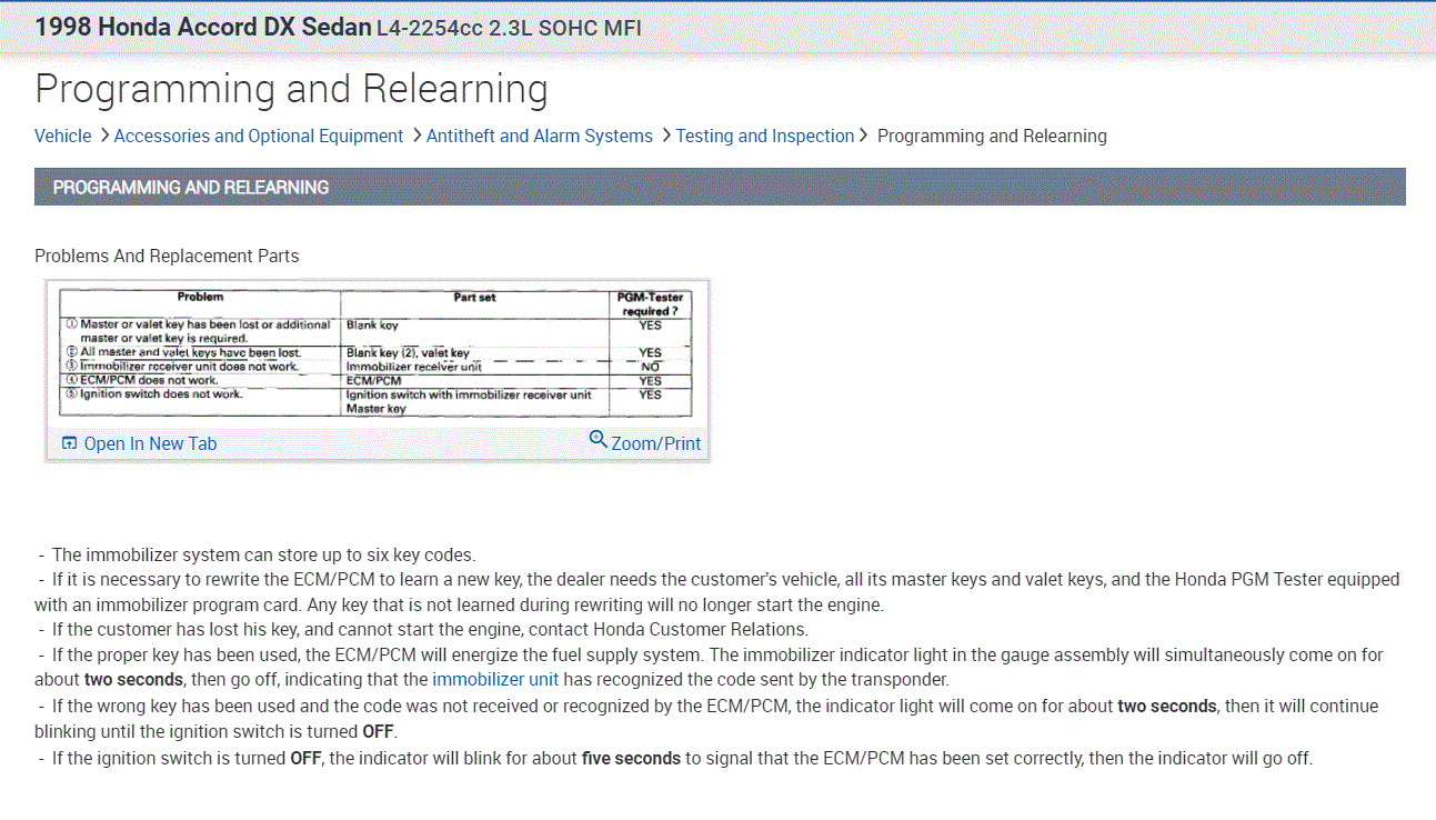

I attached the directions below. Take a look through them and let me know if you have questions.
See pic below.

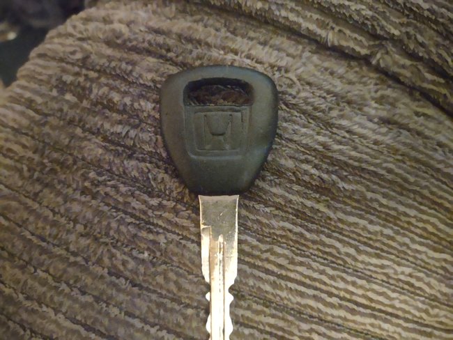

I may have got it wrong, it might not be the valet key, it's the only key. I have, its black and I believe it has a chip in it maybe transponder key.
Apr 12, 2022 at 2:31 AM
  • 110,240 POSTS
Is it possible for you to upload a pic of it for me to see?
Apr 12, 2022 at 12:42 PM
CHRISTOPHER IVAN ROEDER
  • 156 POSTS
Is this what you needed?
Apr 13, 2022 at 2:02 AM
  • 110,240 POSTS
Yes, that is what I wanted to see. That doesn't appear as a valet key. That looks like a regular transponder key. The valet keys were usually gray in color.
That key should work to have reprogrammed. However, if you are going to go through the procedure, I would recommend getting an additional key to program as well.
