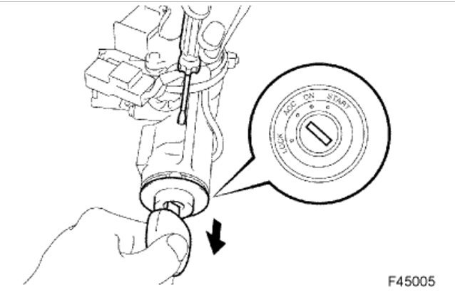

Yes it would be okay to just take off the negative battery cable,
Here is a guide that can help
https://www.2carpros.com/articles/how-to-replace-a-car-battery

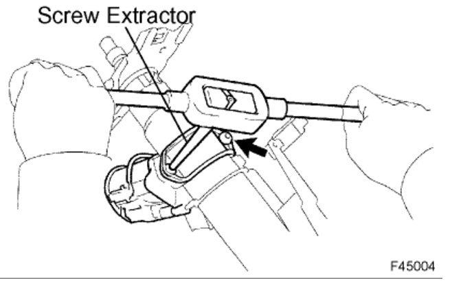

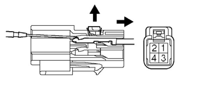

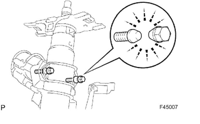

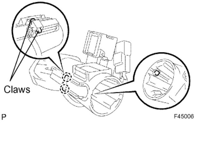

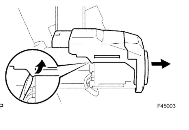

Here are some guides if you want to replace the ignition switch
Jul 10, 2017 at 6:53 AM
