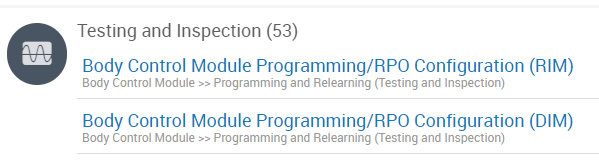

I noticed you haven't been contacted for a few days. Have you been able to make any progress? Also, I wanted to get the BCM pin out for you, but there are two options. By chance do you know if it has a DIM or RIM, RPO number? See pic below.

I haven't had time to check the BCM yet. I'll try tomorrow and get you the info. I'm pretty sure the BCM is to blame since everything that is still happening screams BCM at this point. Also, the BCM code comes up a current and historical. I think the OEM part number is 10391431. That's all I know offhand.

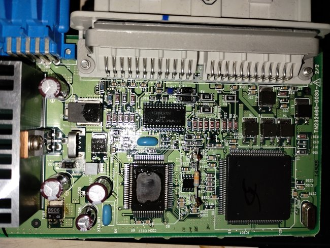

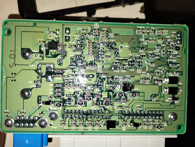

Image 1 Top left ...D101, c325, r56 and a few others are burned up on image. Far center left Image 2 d102, c104 and the chip bottom left is the worst with a few other minor spots. The chip has a bubble and a crack on the top. I'm pretty sure the BCM is bad .
Sep 23, 2022 at 4:15 AM
  • 110,251 POSTS
I think you are correct. One of the items you mentioned would cause failure. Have you been able to replace it?
Sep 23, 2022 at 1:30 PM
GENESIS88
  • 140 POSTS
Not yet, I wanted to confirm that was the problem before placing the order. Or at the very least have some circumstantial evidence that its the most likely the cause. after pulling it and being able to visibly inspect it. I placed the order and I'm hoping it will come Saturday. I did my best to back track the circuit board and pull the diagram and the areas that are burned up are. They are Class 2 data, windows, door locking system, radio memory outside temp/mpg. That everything that is wrong or the cause of a issues. I'm not sure what that one burned up integrated circuit is for. But I'm assuming it's for the components that are bad. One section that has corrosion and arching if you flip it, it has the same damage on the other side.

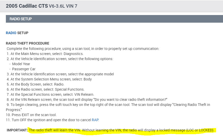

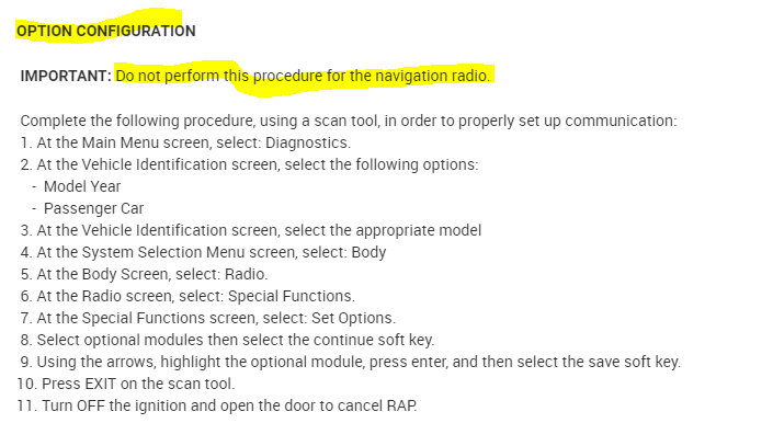

The new BCM fixed everything.... The only issue now is the traction light is on and the anti-theft lock message on radio... I'm not sure what to do for. There is a lot of conflicting information on how to deal with It. Other than that, it all seems good.
Sep 28, 2022 at 12:06 AM
  • 110,251 POSTS
We need to reprogram the radio. You will need a scan tool that will communicate with the module.
If you look below, I provided two different procedures based on if you have navigation or not to reprogram it.
