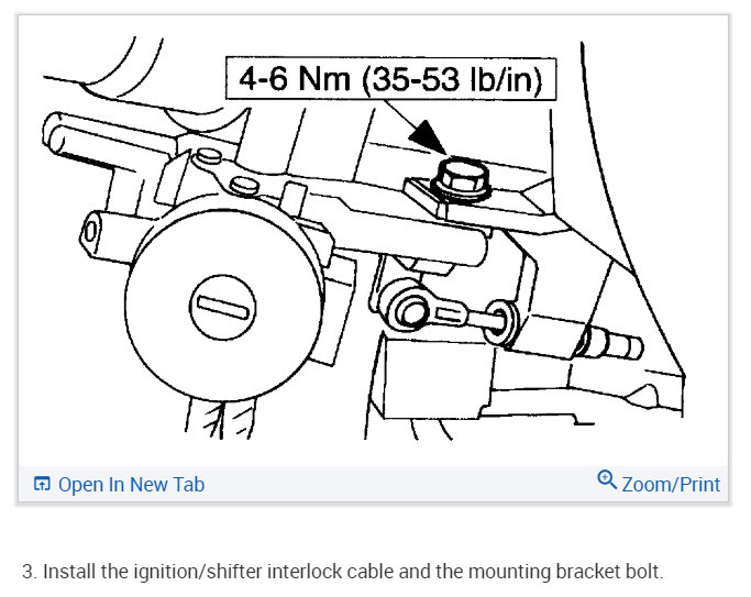

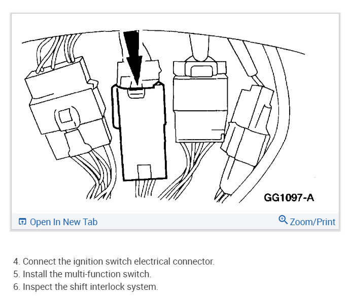

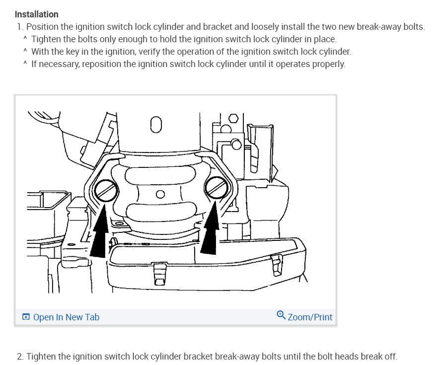

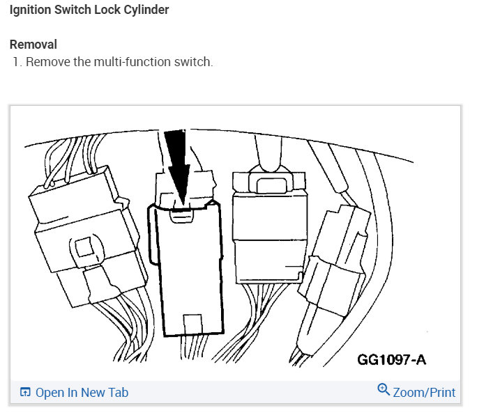

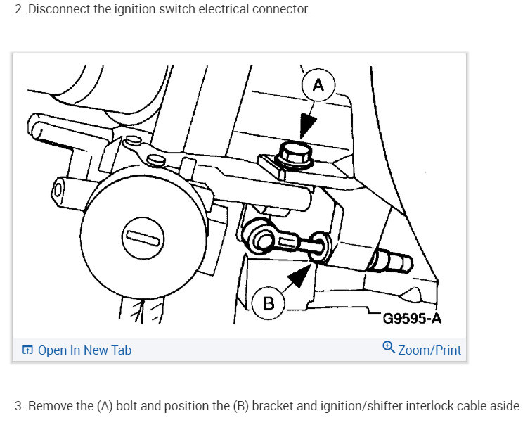

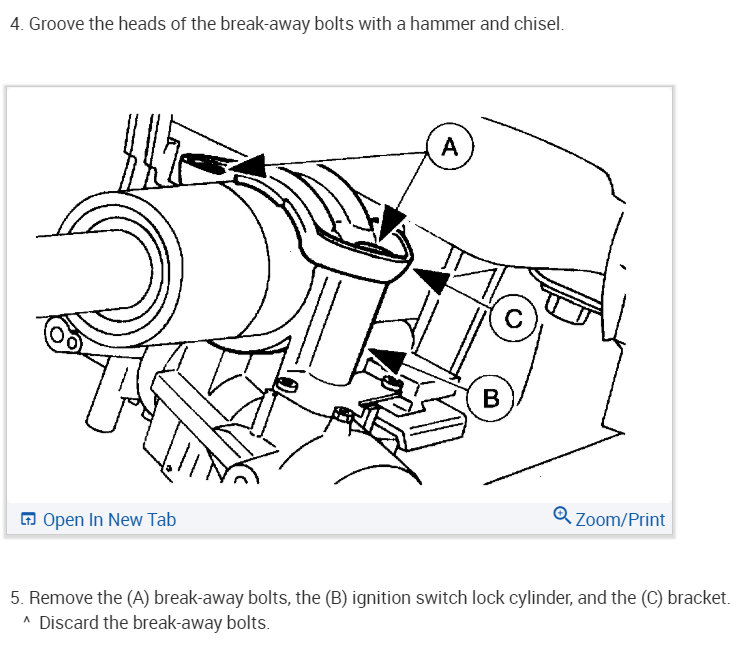

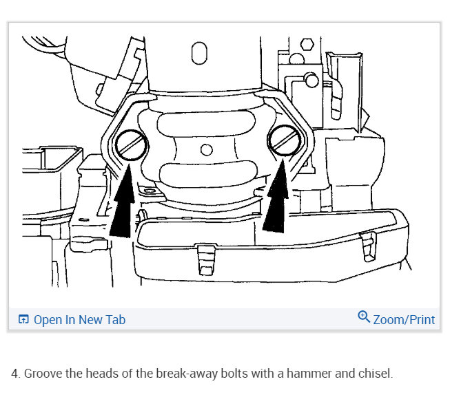

Fellas, my ignition key works fine, except it when I shut it off it will not go past accessories. so I cannot pull it out. I have come to the only place on the web where I can get the answer. Thank you
Oct 20, 2018 at 1:36 AM
  • 55,381 POSTS
Sorry for the delay we had an issue with the system. Can you put the transmission in park? if so it sounds like the key tumbler is broken/worn out here are diagrams to help you replace it. Make sure you get the new one from the dealer bring your VIN number with you so they can program it before you install it.

Most cars require you to push in to allow the key to go the the off position. If your key is still suck in ACC. and will not move to "Run" (ON) or "Off" (Lock) be advised that this is common. The steering column locks in ACC postion as well as Lock position. Suggest turning your steering column hard left & or right while attempting to turn the key to the off position.

If the moving of the wheel does not allow movement of the key I would suggest spraying a lubricant in to the lock, wait a while, spray it again and then try the lock. Now if the lock still fails to move in either direction, it is time to have the lock replaced.

How to remove steering wheel to replace ignition without pulley?
Oct 26, 2018 at 12:06 PM (Merged)
DOCFIXIT
  • 18,828 POSTS
You need a steering wheel puller. Check with a parts houes they rent tools.
