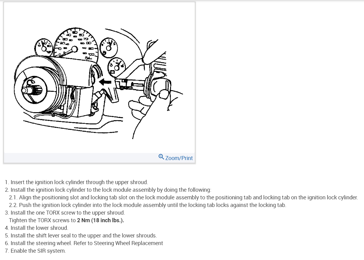

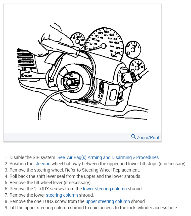

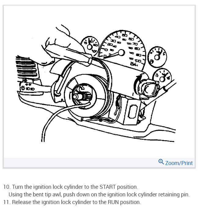

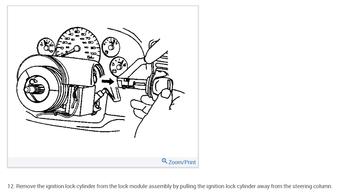

After driving and coming to a stop. Turn motor off by putting shifter into park. Turn key to off and pull on key and it will not come out of the ignition switch.
Mar 10, 2021 at 10:29 AM (Merged)
  • 55,395 POSTS
Is the ignition switch in the fully off position? If so then the key tumbler has worn out and needs to be replaced. Here are diagrams below that will show you what you are in for when doing the job. Get the key from the dealer who can program it before you install it.
