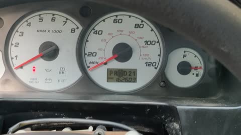

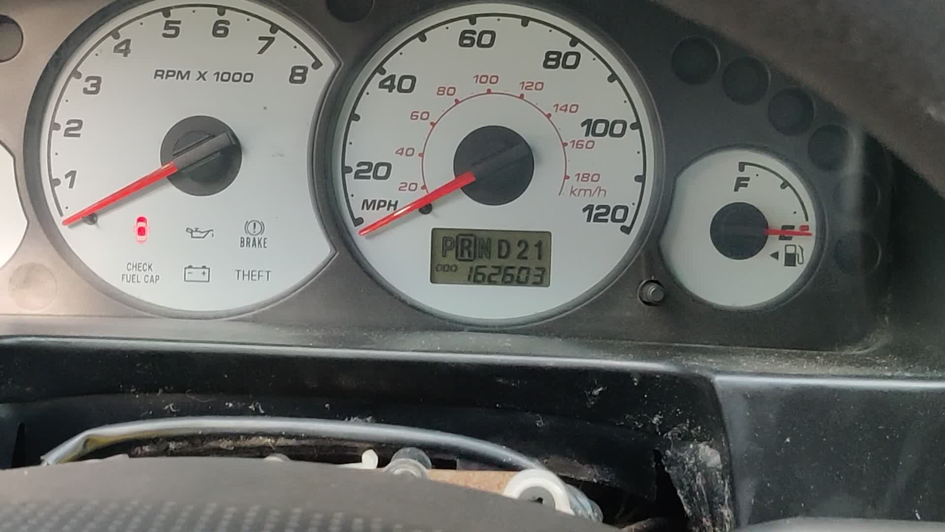

I can't take out the key from the cylinder, because the key doesn't turn all the way back. When i look to the instrument cluster i don't see that park engage, i see that reverse, neutral, drive, d2 and d1 all engage. What can be the possible problem here?

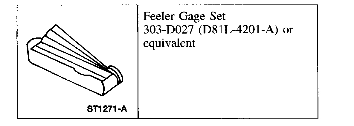

Special Tool(s)
pic 2

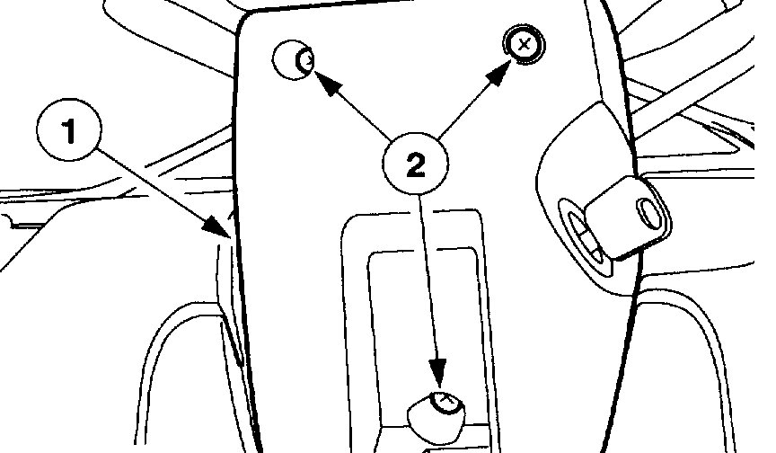

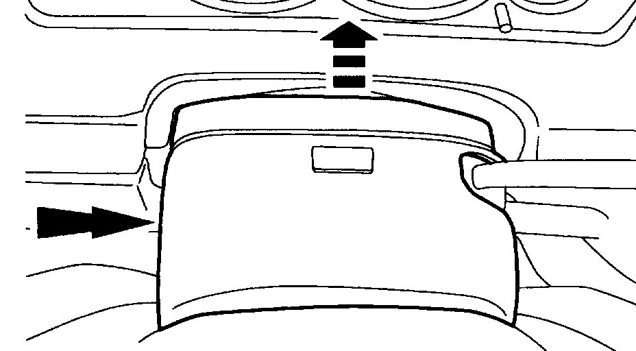

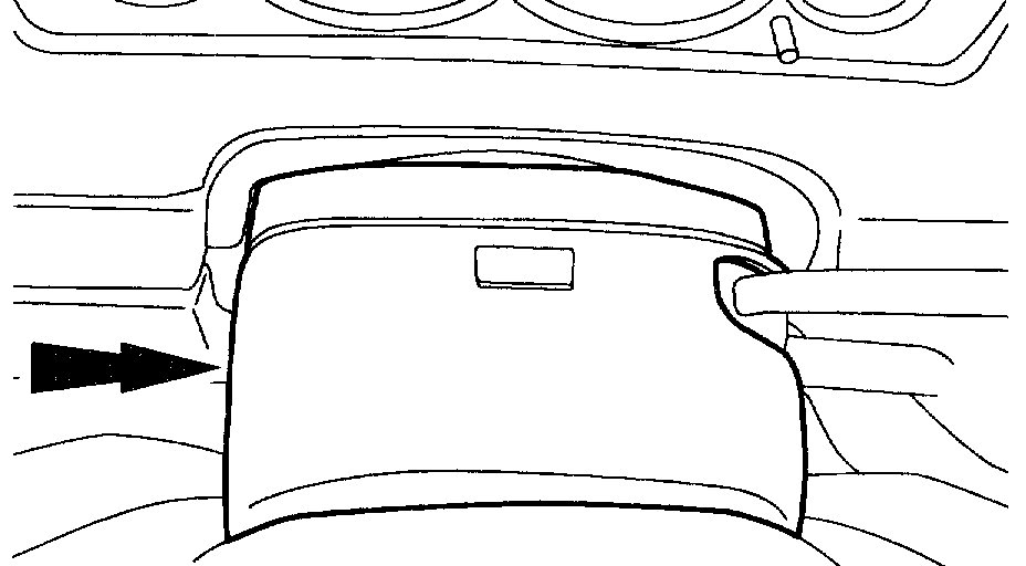

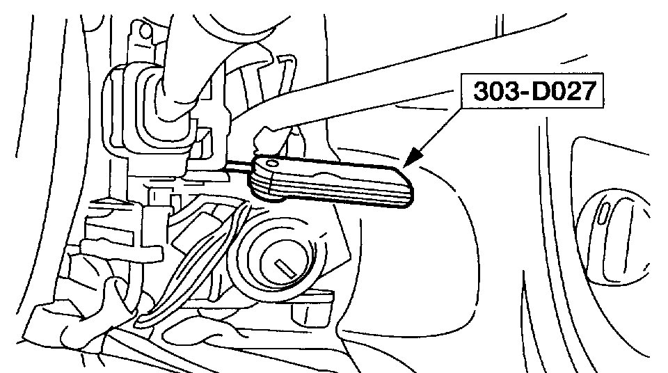

1. Remove the upper steering column shroud.
pic 3
2. Remove the lower steering column shroud.
1. Remove the screws.
pic 4

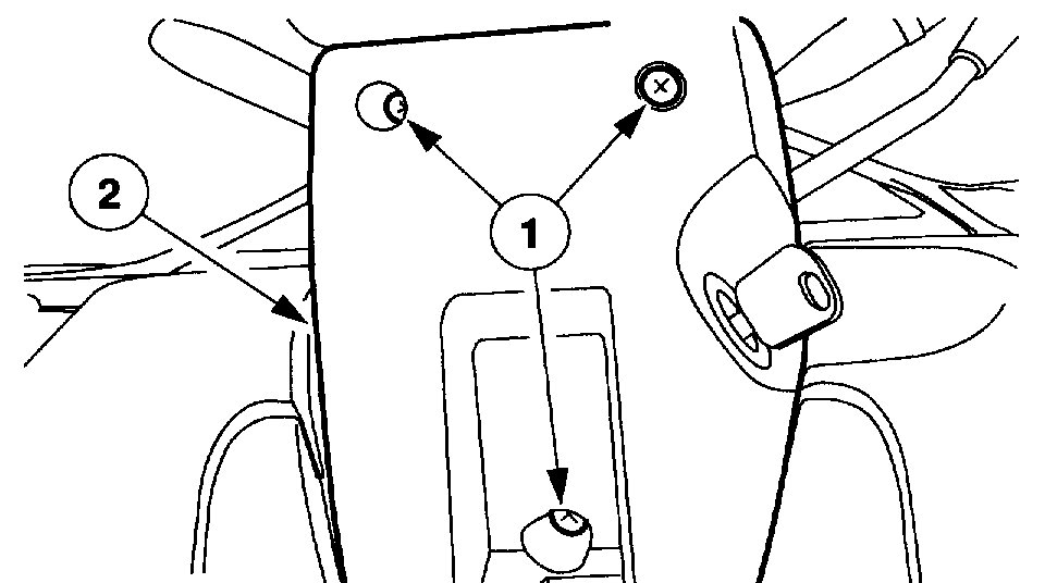

3. Position a 0.6 mm (0.023 inch) feeler gauge between the gearshift lever selector and the gearshift lever detent.
4. Place the gearshift lever in the DRIVE position and hang a 1.4 kg (3 lb) weight from the gearshift lever.
pic 5
5. Loosen the gearshift cable adjuster to adjust the cable then tighten.
6. Remove the weight from the gearshift lever.

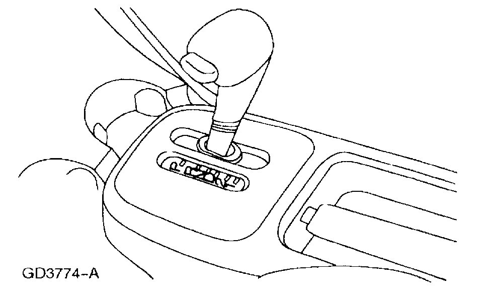

7. Place the gearshift lever in the PARK position and remove the feeler gauge.
pic 6
8. Install the lower steering column shroud.
1. Position the lower steering column shroud.
2. Install the screws.
pic 7
9. Install the upper steering column shroud.

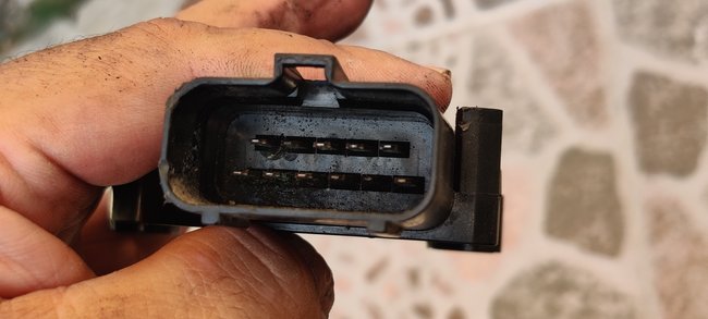

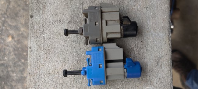

Hi, i saw two switch, one blue one black (as seen on the photo). Which one? The park doesn't engage and you turn the key and the escape star and run, but the thing is that the gear lever is at top but you don't see the park engage. I send you the photo of the neutral switch, as you see it's burn 5 pins. I'm asking? Is possible that the PCM were damage??
I put a new neutral switch but still have the problem with the park and now i can't take out the key and the gearshift lever doesn't move either.
The theft light blink constantly no matter if is on or off.
Now i can't move the key and the gearshift lever.
I tell you the results when i perform the guide you send to me.

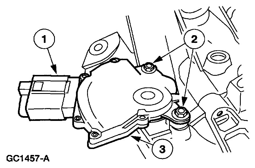

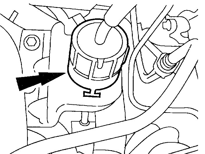

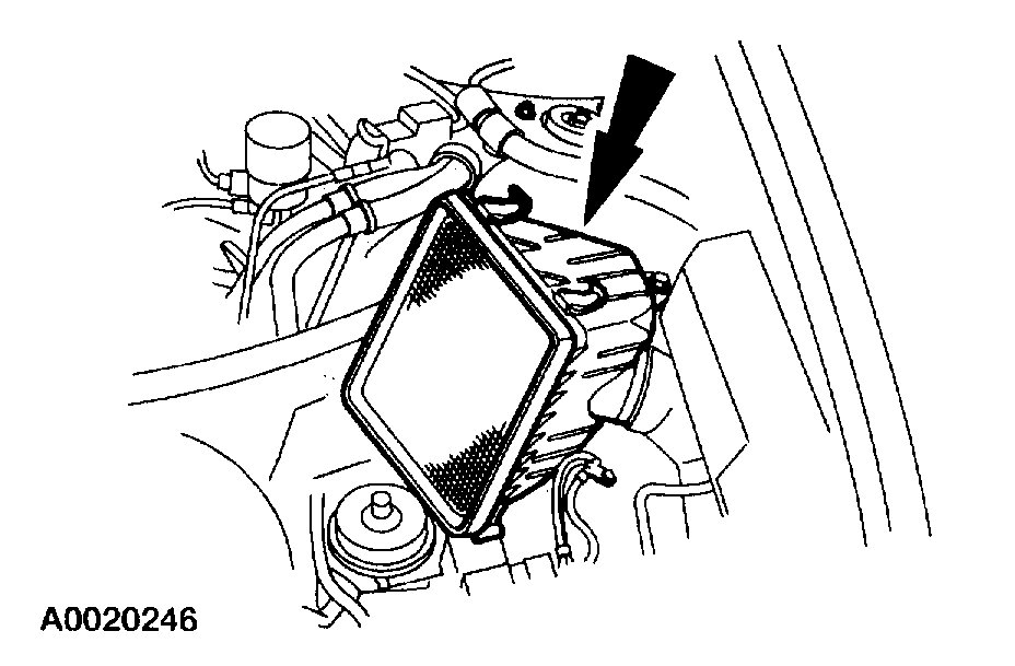

If the linkage is correctly adjusted and there are no electrical issues, I suspect the range sensor is faulty on the transmission. Before replacing it, confirm the connection and wiring are in good condition and not corroded or damaged.
Here are directions for replacement. The attached pics correlate with the directions. Note: Check the basics first. Confirm the linkage is correctly adjusted and there are no connection issues.
__________________________
2002 Ford Truck Escape 2WD V6-182 3.0L VIN 1 SFI
Procedures
Vehicle Powertrain Management Sensors and Switches - Powertrain Management Sensors and Switches - Computers and Control Systems Transmission Position Sensor/Switch Service and Repair Procedures
PROCEDURES
Transmission Range (TR) Sensor

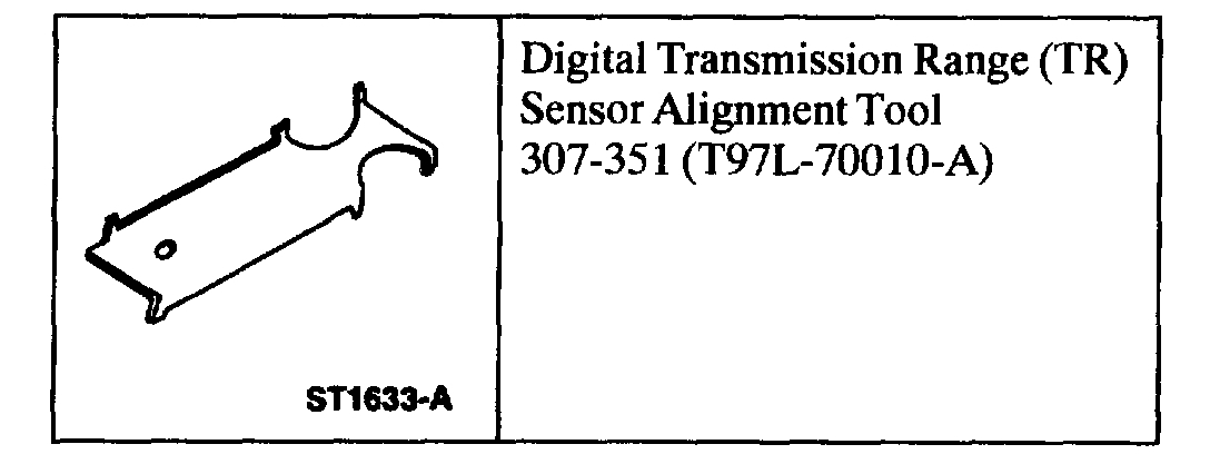

Special Tools
pic 1
Special Tool(s)
Removal
pic 2
1. Place the vehicle in NEUTRAL.
2. Disconnect the battery cables.
3. Remove the battery and tray.
pic 3

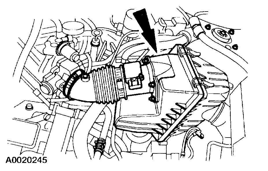

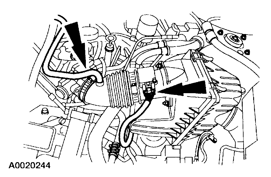

4. Disconnect the breather tube and mass air flow (MAF) sensor.
pic 4
5. Remove the intake tube and air cleaner cover.
pic 5
6. Remove the air cleaner assembly.
pic 6

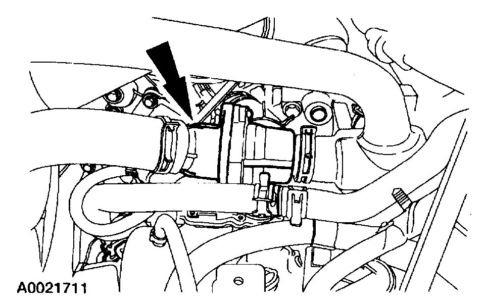

7. NOTE: It may be necessary to remove the thermostat housing to gain access to the transmission range (TR) sensor.
Remove the thermostat housing.
pic 7

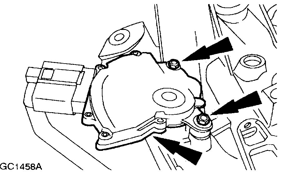

8. Remove the transmission range (TR) sensor.
1. Disconnect the TR sensor electrical connector.
2. Remove the bolts.
3. Remove the TR sensor.

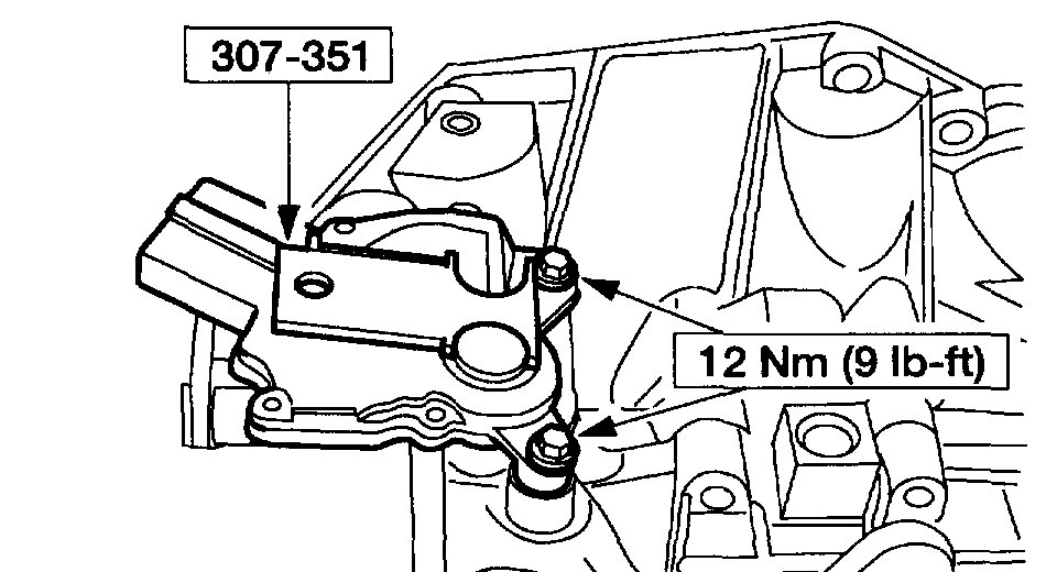

Installation
pic 8
1. NOTE: Make sure the transaxle is in the NEUTRAL position.
Install the transmission range (TR) sensor and loosely install the bolts.
pic 9
2. Using the special tool, align the TR sensor and tighten the bolts.
